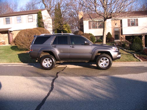

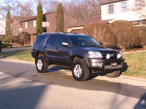

updated pix of Cornfed 2/2
Iron Clad Lou
updated pix with Cornfed 2/2
not much of a diff...but enough of a diff that I had to share.

thanks man...I did want/like the factory rake better...I didnt like how the front would seem higher when parked uphill or towing with the 2/1...

Cornfed is the brand of the lift spacers manufacturer.
It's a 2/1, because it lifts the the front by 2" and the rear by 1". A 2/2, raises both the front and rear by 2". In Lou's case, the factory rake is retained (nose is a little lower than the rear). Most lifts you see will be 2/1 or 3/2 by a lot of members because they want to eliminate that rake look. The nose on a stock 4th gen 4Runner is about 1" lower than the rear.
Re: looks nice
jeremysoca said:
Do you have a nice side picture which shows the setup?
Thanks
this is the side pic...the street does slope down to the right a bit...
Very cool. The parked uphill thing doesn't bother me too much. I too hate butt-low when towing or loaded. I also like some rake on level ground or when driving. Nothing screams "overloaded/wimpy" like butt-low IMHO (even if it's not true).:biggrin2:
:cheers:
