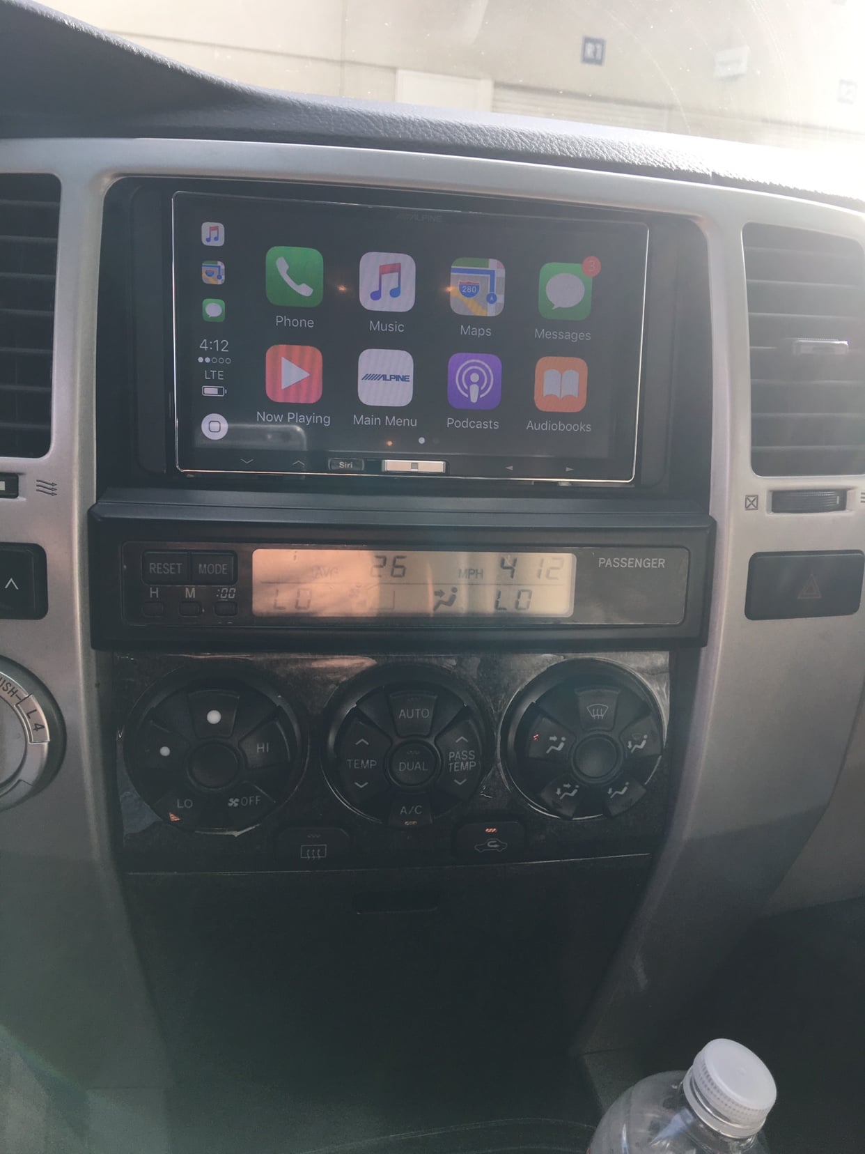

Do you have it adjusted to the highest height position?
It's adjusted to the second to lowest height position. Mine is mounted at the bottom portion of the metra kit. I believe yours is mounted at the top on the lowest height position?
Correct. Now that I’ve seen both...I think you might prefer it the way I have it. It really doesn’t impact airflow from the vents that much. Probably 40% of the vent has screen in front of it...but the air blows well around it. Totally a matter of personal preference I know....I just wouldn’t personally like my controls obstructed.
Looks Awesome @Clo-t4r

Finally got around to it on Friday. I was able to install it on the bottom of the metra kit using the double din mounts, which i prefer since it doesnt cover the air vents. The pocket does not fit on the top and need to rig something to cover the hole, you can't tell unless you really look behind it. I installed hdmi/usb and usb plugs in the glove box. I have Chromecast plugged into the hdmi port. Also changed the startup image to a photo i took last week. Overall easy install and love the headunit. Definite increase in sound quality, especially with Carplay, and not feeling forced to wanting to change the speakers so soon.

All in I believe I spent about $1350. For $200 more I would have it done. Your description of the install does make it sound a bit too simplistic but it’s not far off from that.

Overall I spent below $1k, spent some time doing research and finding the best deals for most of the below.
Alpine ILX-F309 ("Refurb" but arrived as new with slightly damaged box) - $650 (you can find deals on this headunit for around this price)
idatalink Maestro RR (New) - $65 (Ebay)
Metra Dash Kit 99-8227CHG - $79.99
Maestro HRN-RR-TO2 Plug and Play T-Harness - $33
Maestro Acc-USB-TO2 Factory USB to Male USB Adaptor - $30
Maestro Acc-SAT-TO2 Sat Radio and GPS Antenna adaptors - $30
Metra Antenna Adapter 40-LX11 - $14
Optional
Toyota Car USB Socket Port with HDMI Socket - $15
Dual QC3.0 USB Fast Charger Socket Power Outlet - $17
Installation
I had a bunch of butt-connectors, solder, heatshrink, etc. The only extra thing I bought was Tesa Black Fuzzy tape to help cable manage and clean everything up which was about $5.
Did you install the unit yourself? For someone that's never installed a radio before, is it do-able?
I installed everything myself.
Headunit: It's pretty simple and straightforward if you have a general idea of how to connect wires together properly. The install guide from idatalink helps alot. I'm sure there is a bunch of youtube videos on this. If you were local, I would have been glad to meetup to help.
Glovebox Connections: This was optional and required a bit more work but overall pretty simple as well.
Did you loose any steering wheel controls in the process? What about the reverse camera?
I was able to keep all my steering wheel controls using the Maestro RR. The reverse camera works as it should.
Finally, how did you mount the microphone?
I mounted the microphone on the driver's side A-Pillar, ran the wire's down the left side behind the weather stripping and behind the steering column. I'll try to take more photos later (been so busy).
Hope that helps, let me know if you have any other questions.

Okay...okay. Such a PIA to post pics here. Here you go though.
Buddy I can’t thank you enough for the pictures in this thread. I’ve been on the fence about buying a 2019 as the radio situation is very, very behind. I’ve seen the Halo9 stuff online but have been unable to get any direct info. Also, I can’t start a thread on here because I don’t have enough posts lol
I live in Tennessee so it’s brutal here in the summer. My wife would murder me if I blocked the center fans. The lower din placement looks like what I would want to do. I actually don’t mind the hvac controls being semi hidden. We pretty much always have the ac cranked to the coldest setting and only mess with fan speed. My wife is one of those people that NEVER uses climate control which drives me crazy (we may get a limited).
We will be getting a SR5 Premium most likely. It looks like the kit you got was glossy for the TRD Off road. Could I source a normal SR5 trim bezel one?
Thanks again
