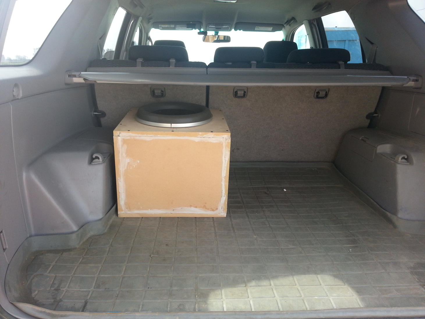

I do have this and I think it's big.
That's a pretty big box as far as the rear storage area is considered. I've seen people use boxes that size, but me personally, I like the steal setup better.

Yep just one sub, but man does it get loud. Threw it in a ported box, tuned to 30Hz, and it sounds great. I think I paid right around $375 for the sub though. Heres a picture of the box size. Still needs to be finished, and realistically could be a little smaller. Mine is 3.5 cubic feet, but Sundown recommends 2.5 cubes.

op, like others and I have mentioned, just use that sub that you have for now. Its a good sub. If you worried about space, just get a sealed box for it. Or if you call memphis and get the the specs, have some one build you a custom ported box. its probably not going to be bigger than 1.5 cu.ft, for a ported.

I dont think the sundown x12 would be good fit in that box. The sundown needs to have a box tuned low to make it sound good. I would guess the Mojo box is tuned higher. So I would either keep the Mojo and box together, or the sundown and a new box built to the specs of the woofer.
