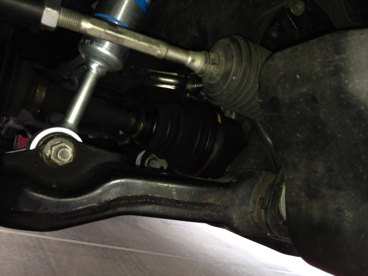

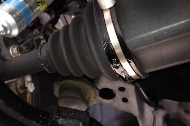

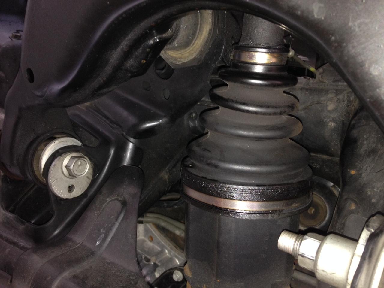

I had taken my truck in a few weeks ago and had the Xreas system pulled off and had new FJ coils installed in the rear, along with the adjustable Bilstein shocks all around and spidertrax spacers. Up to this point I had no issues at all until today when I upgraded my tires from a 265-65-17 to a 265-70-17. Anyways after backing into the driveway my wife noticed something leaking in the driveway. Since I just had back surgery my wife offered to crawl under the rig to investigate and she snapped the following pictures. It appears that the small bit of extra tire height has caused my CV boots to leak on both sides. The question is what do I need to do to repair and can I do anything to buy me some time until I do repair. And of course how much can I expect to spend. I just spent a bunch of money to 1) replace the suspension and level the truck out, 2) prepaid for my back surgery to the tune of $1540, and 3) paid $1000 for the brand new Duratrac's. As I mentioned before, I had no issues what so ever until the new tires were installed today. Any advice is greatly appreciated, I included some pics of the new leak after tire upgrade, the truck with the new tires and a pic of my super cool little wife under the rig helping me figure out out what was leaking. Thanks everyone...

hard to tell from that pic....
but it does not appear to be cv "grease"
looks more like diff fluid ?
has anyone messed with any of the fluids? lately?
if you take a pic of where the cv enters the front diff and see if thats where the oil is coming from....
also it looks like your missing a band around the cv boot on the left side of that pic.....
CV grease looks a heck of a lot like diff fluid once it gets hot and runny - was this taken after driving it?
I'd imagine it's just a little grease, wipe it away and see if it comes back. I'd start by reclamping the axle boots and seeing if it helps, sometimes it just spews some grease when you lift it and change the CV angles.

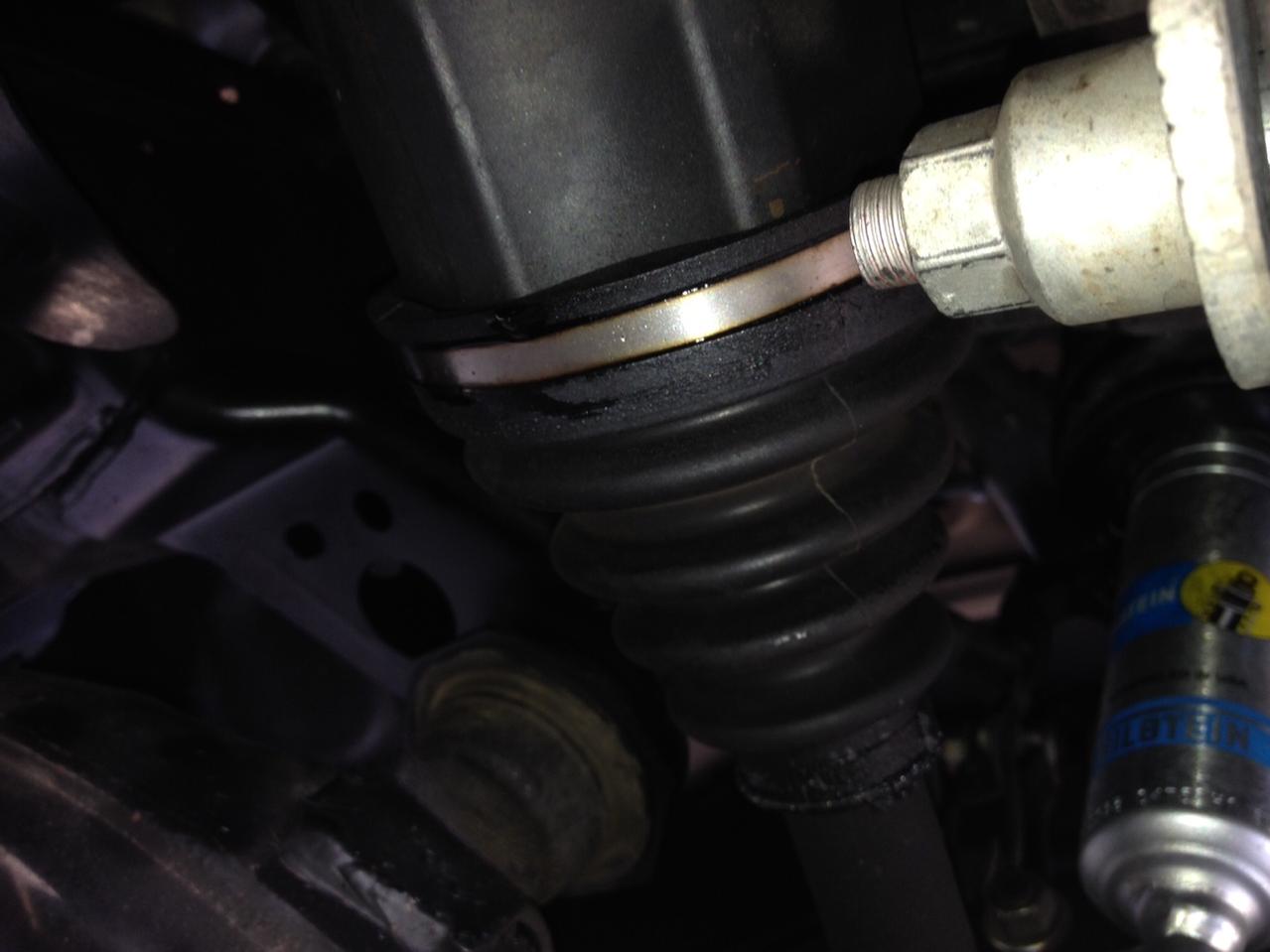

Ok here is a few more pics and some more information. My Xreas leaked liked crazy before replacing the suspension, enough where there was zero pressure when they disconnected it. The fluid that leaked from both sides today was very watery, hardly like a grease but has a very slight oily feel. And it was from both of the larger clamp sides, unlike what I have read about the typical CV Boot leak. As far as the band missing, it was just coated with gunk. So both of the small clamps are there and like I mentioned the watery fluid that is leaking dripped out from below both of the big clamps. I did wipe it down a bit so I am hoping these pics shed some light on the issue. Any information is greatly appreciated, and please let me know if there are any more pictures I can take to help. No one has touched the front differential since I purchased the truck. Seems really odd that adding the tires after leveling out the truck would cause any issues. The bottom of the truck is coated with the Xreas fluid that leaked out as well as a bunch of junk from the road. Was excited to get the tires done finally only to have this mysterious leak...??

I'm like the other poster, it sounds a lot more like actual diff fluid rather than CV grease but not sure why it would be seeping out other than a loose axle seal. I've been driving with a torn boot myself and have seen the CV grease in varying concentrations/temperatures and can attest to it changing in appearance. However, I don't ever recall it looking like what your describing. But who knows, hopefully it is just a simple case of boot leakage due to the lift. Or it may even be a random accumulation of fluid from elsewhere. Also, the increase in tire size shouldn't have any effect on the CVs. To troubleshoot, I would just wipe everything down as you've done and keep and eye on it.

It's hard to tell if the larger seal is leaking. Much more common is the inner, smaller one.
...can I do anything to buy me some time until I do repair.
I'd wipe it down real well and make sure the boot is not ripped anywhere, then wrap it with silicone tape. That is the perfect buy some time fix. It's semi-permanent. Sometimes goes by other names like fix-it-tape. If it turns out the bigger seal is leaking, it might even work there, too.

Repeating what others have said, but maybe more specifically:
You really have to wipe everything down and get it really clean. Only then, can you actually tell where it is leaking from. Once it's clean, take a quick spin and then check it. The only place that is dirty will be where the leak is.
Once you've identified the trouble area then you can focus in on a fix.
The grease in those CV boots have a horrible smell, probably the worse fluid I ever smelled from a vehicle. That is one way to identify it. But it looks to thin to be CV grease. Look around above where you are seeing the fluid. It may be from somewhere else. I cant think of anything involved in changing tires that would spray fluid on the axels. Maybe the shop used a fluid around the wheel during install and it sprayed on the axel?
I agree with everyone else, that isn't CV grease. My best guess is your diff seals started to slowly leak. That's why you see it coming from the diff side. That most likely just happened by chance, there's not much a lift could do to cause that.
Wipe it all up and see how quickly it comes back.
Diff seals and topping up the fluid should be around a 2hr job and I'm guessing would run about $250-300 with parts and labor.
C/v would look like a bad milk shake , flung all over . And mine did split after lift & shocks so it can happen , but does not appears as most have stated that .
