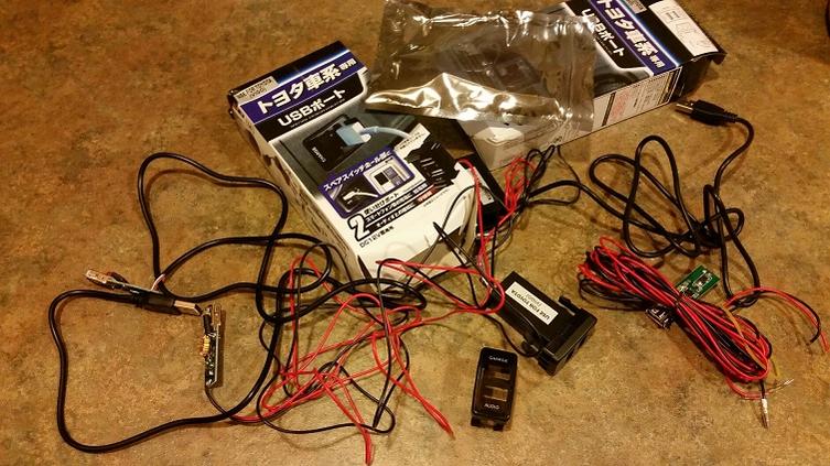

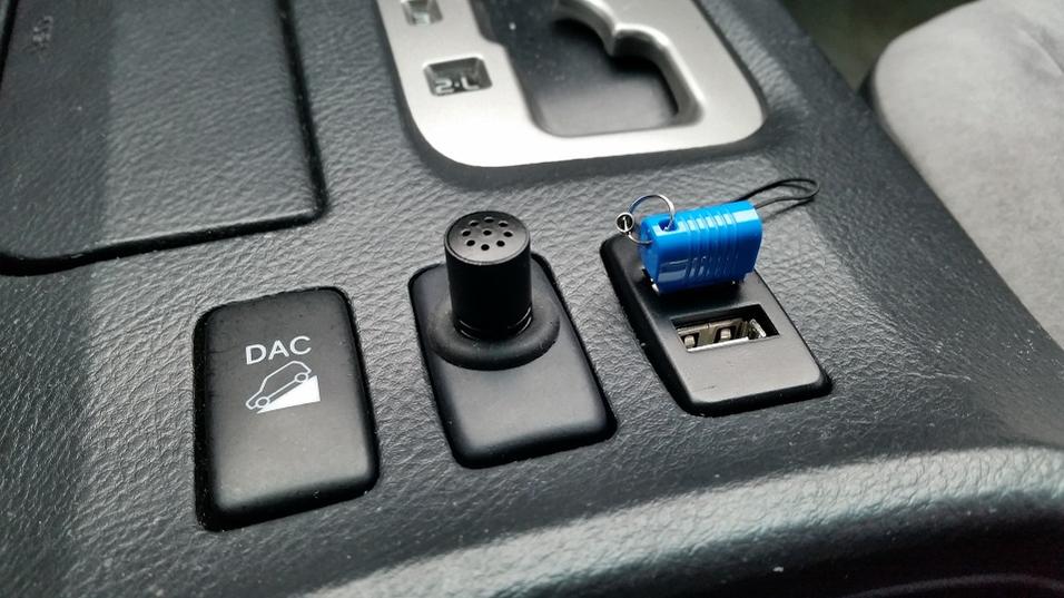

My Pioneer head unit has 2 USB ports. One for Android Auto and the other for an USB flash drive. Took me a while to figure out how I can make it look as OE as possible.
-I purchased 2 of these (well, the ones I purchased are longer available):USB Port
-2 USB extension cables. Like this
-Took both apart.
-Combined the "audio" parts from both units into one. Disregard the "charging" portions.
-Painted the case black.
-Done!

If you’re crafty, I bought an OEM usb plug. They’re about a 1/3rd of the size of our switch blanks. I cut off the tip of a blank and JB Welded it to the usb outlet. I then had to shave off a bit of the sides for it to slide in. It fits great, but it doesn’t click in or amything. It’s just held in from being wedged in the switch hole.

Wow, that looks great. Is that the Bluetooth mic next to the USB ports? How well does that mic work in that location?
Thanks! Yup, it is the mic for the Bluetooth. I don't usually "talk and drive", but I tested it once and the person on the other side of the phone said they could hear me just fine.
