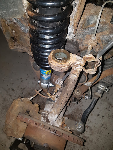

So i went to do my lift this weekend and being from canada the lovely winters have rusted some bolts on forever or made them dust.... with that said i figured while i have some things off i would quickly change a few other items.... i got to my upper ball joint and BAAAMMM the press dropss (as it should) but little did i know the ball joint itself came through the housing see picture below. Now has anyone dealt with this how the Fluff do i get that housing out ...please help
Thank you,

I'm not sure, but is it possible you did not remove the locking circlip that holds the housing into the spindle? I'm wondering if it is under that dirt.
I agree with durk. I'm in Ohio and recently did this and i couldn't even see a c-clip even after hitting with PB Blaster and a wire brush because it was so rusted. I looked at pics where it should be (sits flush with the spindle/knuckle...whatever its called) and just ground away at 1/4 of it before I could punch it out.
I have found that it is easier for me to remove the axle nut, caliper, rotor and four bolts for the lower ball joint. Then take the whole arm off and bring it into a nice comfortable, well lit room and press it out with a floor press
not sure what else you can do then other than letting it sit in penetrant for days and pressing the rest out or getting a saw in there to cut it from the center outwards but you risk cutting into the spindle.
I did this. still wasn't easy, so I can't imagine trying to do it on the truck.
Penetration lube and an air hammer [emoji375]
I didn't bother using my ball joint tool on mine I just did a couple taps with the air hammer and it came right out.
I am also in California so no rust whatsoever, but it's worth a shot.
If you do use a sawzall just be carful not to get the spindle.

Just in case you haven't thought of it, now would be a great time for spindle gussets

I would agree with JBurt with the heat. It will help some, but I don't know if it'll be enough. I had to pull my spindle off completely, and use my shop press.
So i got it out. I torched it then i tried the press again but with out the ring just the stepwedge top(that goes on the screw portion) and voila she came out.
thank you all for you suggestions
