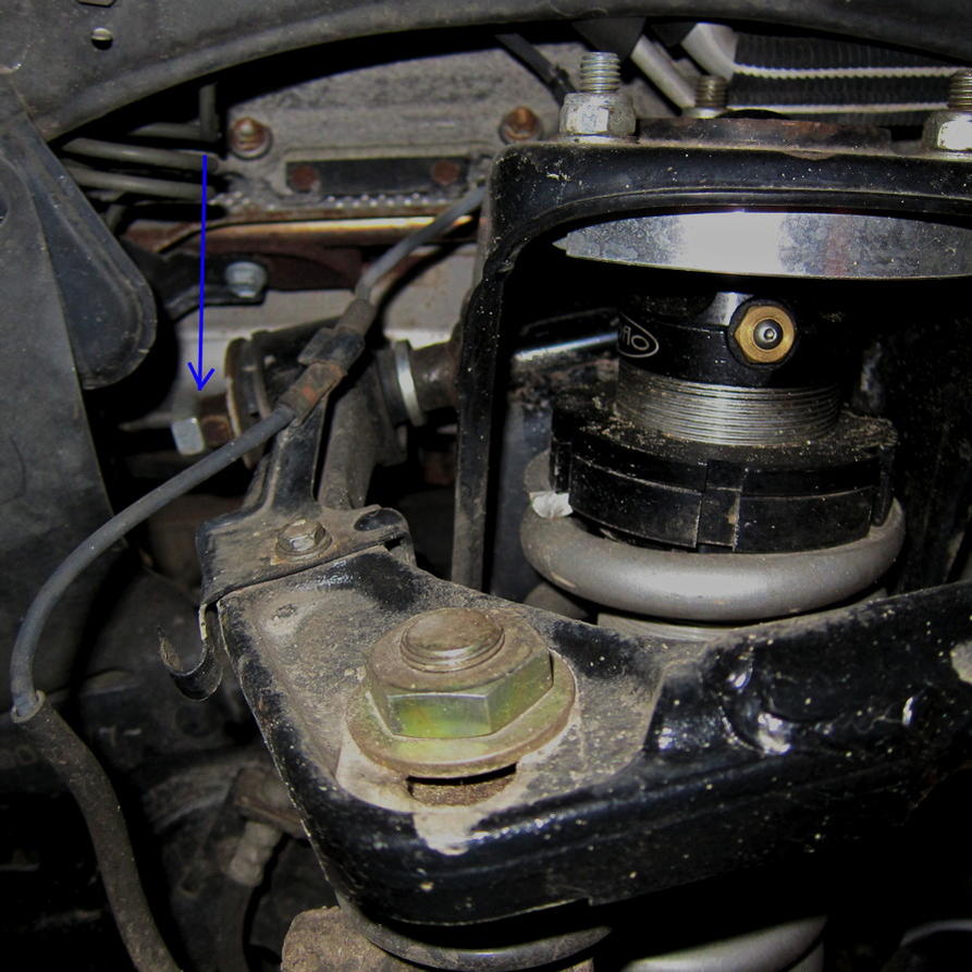

A few of us have recently noticed that the nuts on the main bolt of the upper control arm have become loose, if not actually missing after backing completely off.
The bolt in question:
So far, it seems that this has been a problem for those who have replaced their UCA's with the Light Racing UCA but anyone else who has had this issue should respond here so we can get a better understanding of the problem.

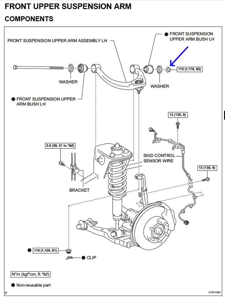

The torque setting for this nut is 85 ft-lbs and I am pretty sure that most folks doing this work have tightened to this value.
The question is why is the nut becoming loose ? There are no recommendations in the repair manual to indicate that Locktite or similar thread lock be used when assembling.
My own solution was to add a second nut to the assembly to prevent the first from turning
Anyone that has done work on their front suspension should check these nuts (along with all the others) especially if you replaced the UCA. If this turns out to be a problem unique to the Light Racing UCA's then they need to know about that.
Please post your experiences with this problem here.

Just wanted to add that I've changed out my UCA's for the LR UCA's a while back purchasing an older design. I haven't had this nut come loose at all perhaps due to a difference in design.
Have you talked to SPC performance about this by chance?
This issue was brought to my attention by [MENTION=77955]jdkilroy[/MENTION] and boy am I glad he did. What I'm seeing so far is that it seems to point toward the new style bushings.
The old style are more like OE style. The rubber bushings that needed to be loaded before torquing them down. The new style (poly) ones seem to just basically turn and back the nuts out as the arm travels over time.
Be careful guys. Be sure to check this out. As I've said in my build, it would take a bit of doing for the pin/bolt to back all the way out. They are under shear force and the bolt would need to travel uphill, but it will definitely walk over time. Who knows how long mine was like that before I caught it.

Actually Jon, looking at your picture, it looks like you have the old style... Kind of debunks my theory... Oh dear.
These UCA's have been around for a while, I would imagine you would have heard of more instances of this happening but then again you would have never checked unless Jon had mentioned it. Just seems odd though.
True... But just between Jon, myself, the guy who Alex actually witness the bolt back out on, and Keak mentioning it's happened to all of us, that's WAY more instances than I'm comfortable with. This is just people that have chimed in thus far. Who knows how many more like me that haven't checked there are. It's not something that would easily fail by design, but it could potentially be catastrophic.

Unsure how might be related (if at all) but the Radflo in that picture appears to be cranked down ~ 2x the max recommended (1.5").
Hmmm, are you sure the max is 1.5"? I don't have any documentation on mine, but what I've seen posted said 2" or 2.5". If it's 1.5", I've got mine cranked up too much which is why I ask. I did check my LR UCA's and they're still tight.
Just so everyone is clear...you guys are referring to the amount of thread showing, not the amount of lift, correct? I would think as long as you are ok with the ride quality and aren't getting any coil binding, you should be good at whatever lift height you want (within reason of course).

Yes, I'm talking about exposed thread. I'm at 3.5" lift with mine, and I'm thinking I'm really pushing the limit which is why I brought that up. I do get a lot of clunking, but this has been reported by others as well and the guys at OW said it's "normal".
I was mistaken in my original post; I was reciting from memory. I dug up the original documents for my suspension install and....
The instructions provided with my OW 2.5 kit state in bold: "... DO NOT adjust the collar beyond 1" of exposed thread."
I suspect that the instructions are different for the 2.0 kit.
