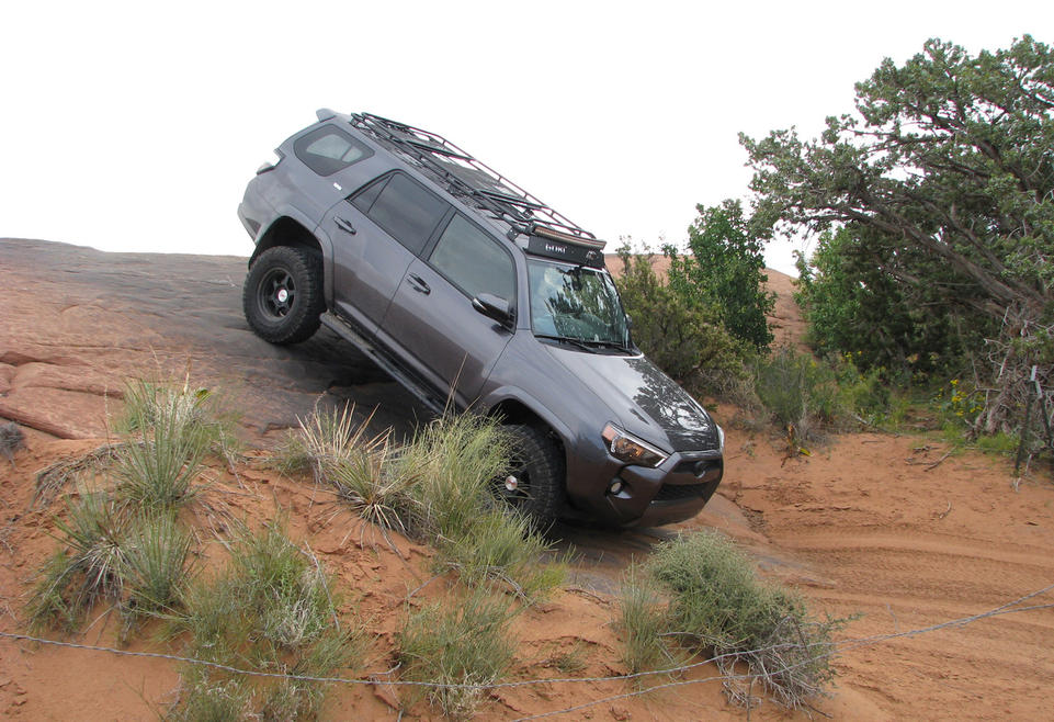

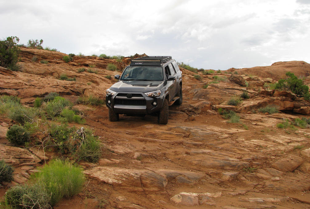

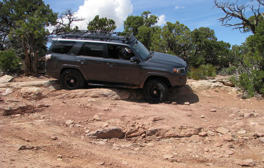

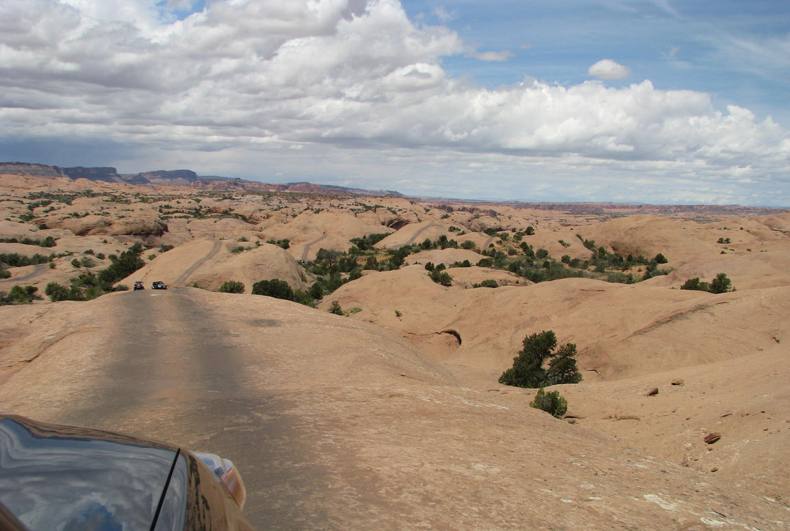

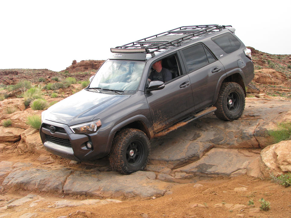

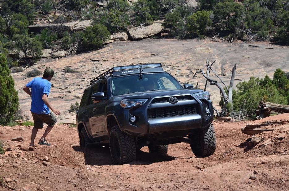

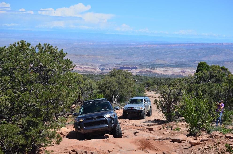

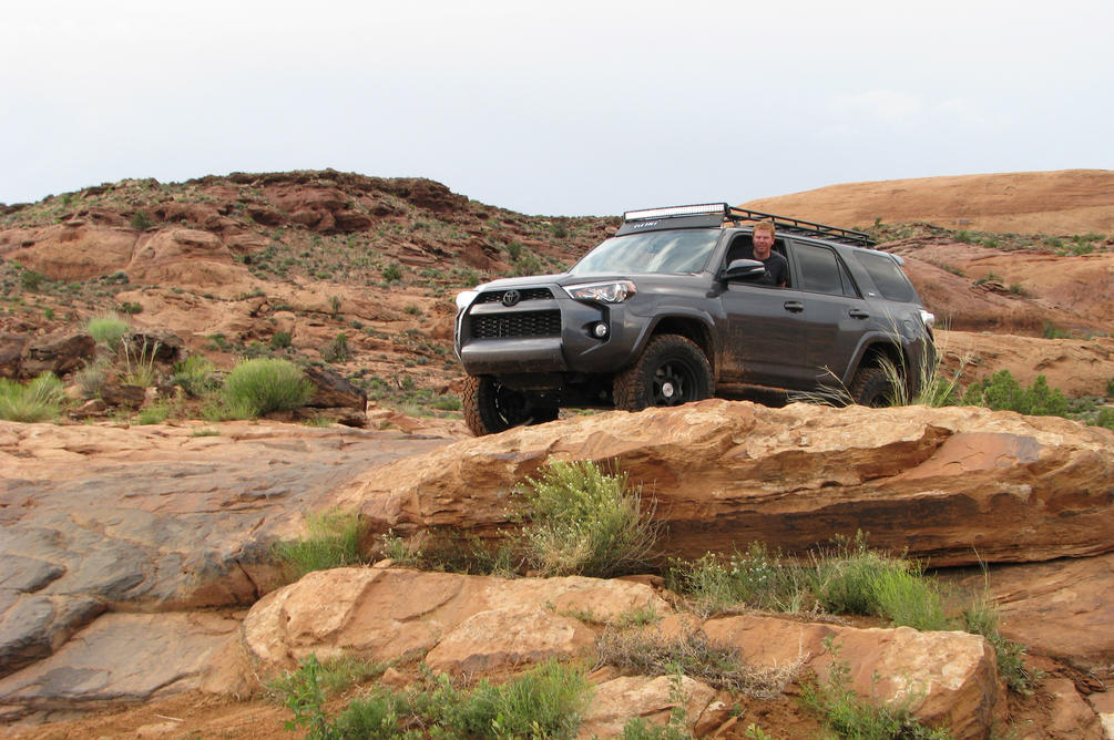

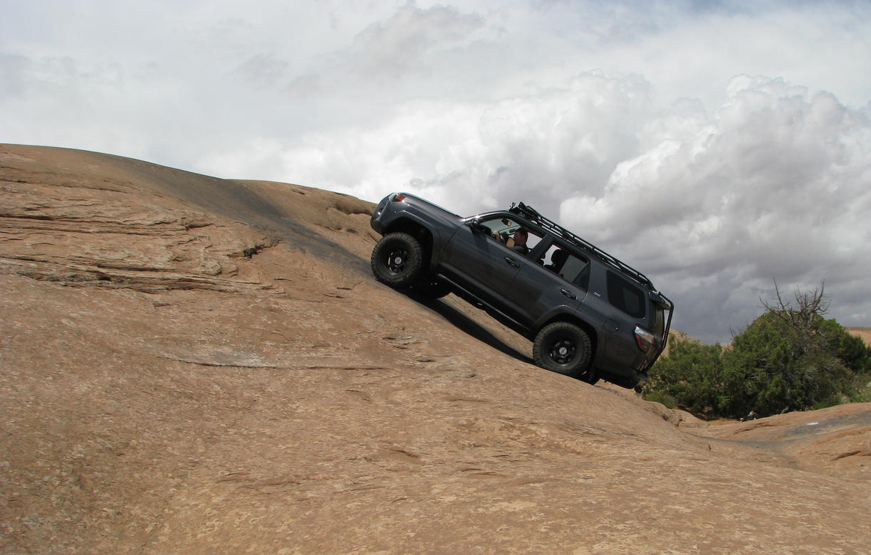

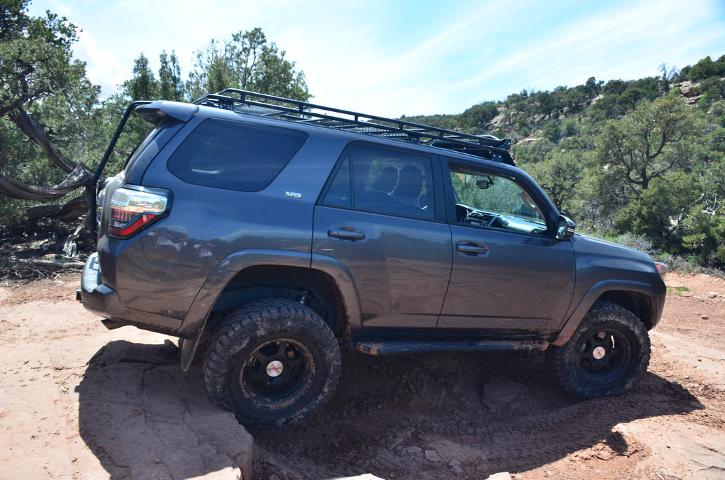

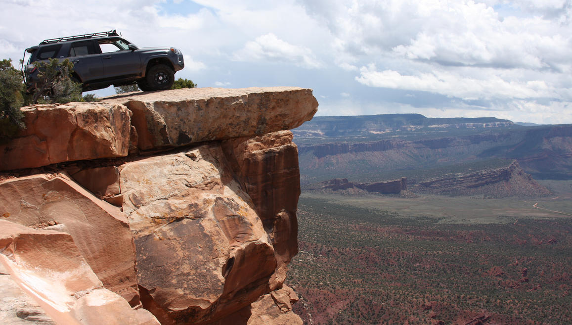

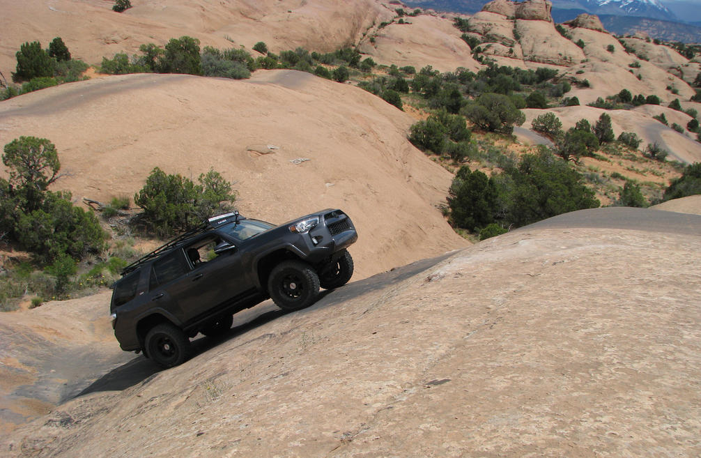

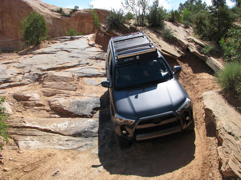

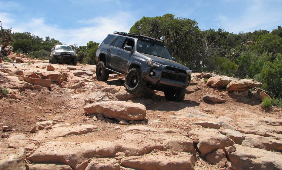

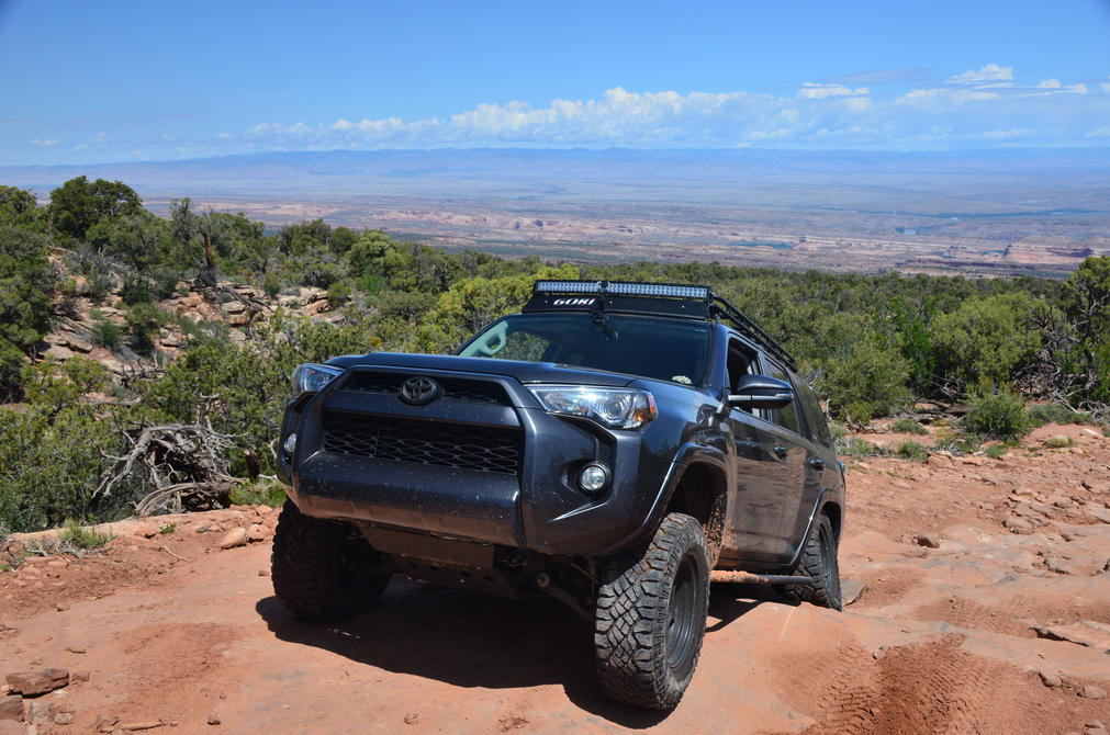

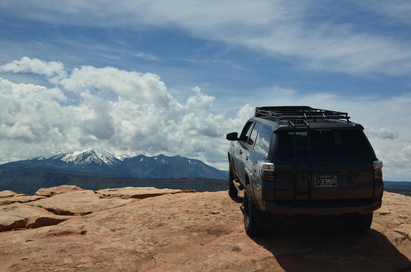

Speaking of [MENTION=65101]BrianSD_42[/MENTION]...you got some great pictures of my rig on Top of the World. Thanks for sharing them! I thought my wife was taking pictures in general, but turns out she was greedy and only took pictures of me so I don't have anything to share. I do think there may be a few GoPro videos from my windshield that should have some decent footage of you in there though since you were in front of me for half the trail. I'll get to reviewing and editing those eventually...but I think this was one of those moments where I found the rear bumper and/or the hitch with that ledge!

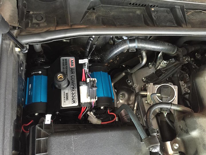

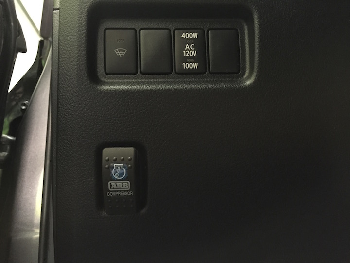

Agreed, the SR5 is capable of going more places than most of the drivers (myself included right now) are capable of taking it. I chose the SR5 because the trail was hard to come by at the time and I specifically didn't want the KDSS suspension because I'd end up ripping it out eventually anyways (and at the time, the only trail models I could find nearby all had KDSS).
I chose the ARB twin compressor specifically because I have zero patience when it comes to airing back up, but also because I wanted the flexibility of running lockers a little bit further down the road. I'll likely only do a rear locker as I don't know if I'm to the point of running trails where I'd also need a front locker, but before I do either of those I want to do front and rear bumpers and get better suspension.

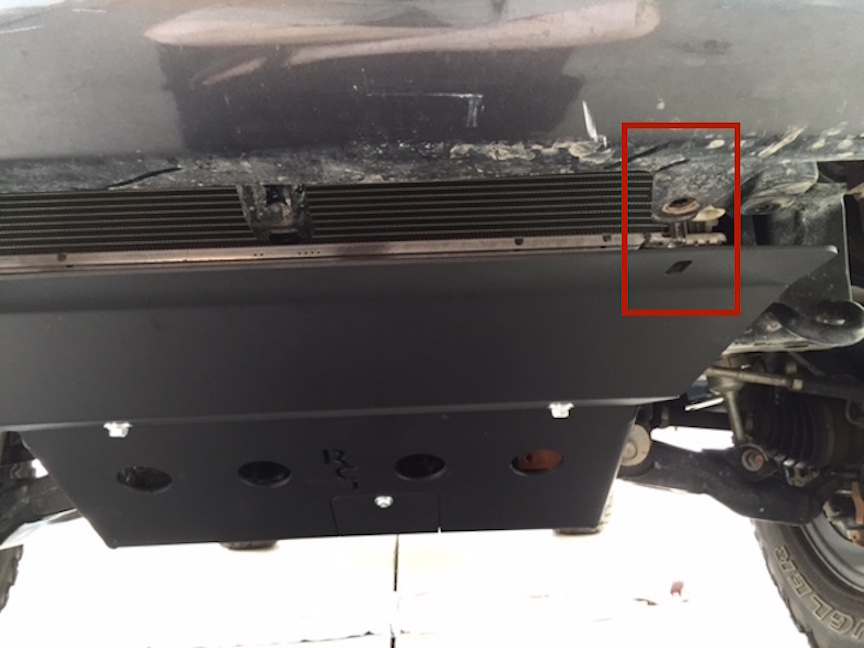

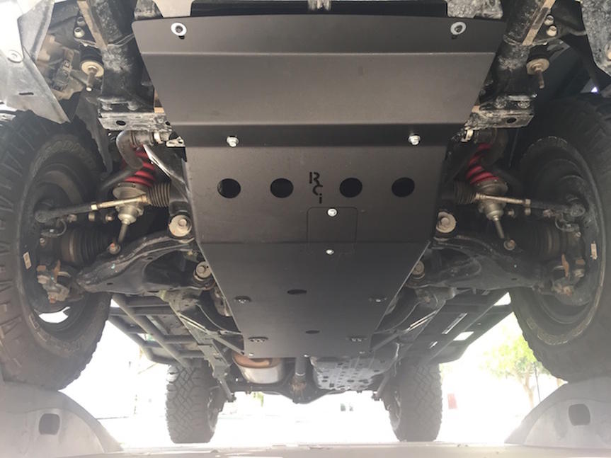

And yes, very glad I had the mods I have, especially the skid plates up there! It's amazing how quickly you can learn and adjust every time you try new terrain. At the beginning of Fins n Things, I quickly drug my hitch on a rock and panicked a little bit. By the end of the trail, I was much more comfortable with where it was and how to use it to my advantage to get through the trail effectively and without damage. I didn't think I'd be tackling trails like this until I had a few more mods done, but I'm glad I did and the truck handled everything without any issues other than driver inexperience a couple times.
