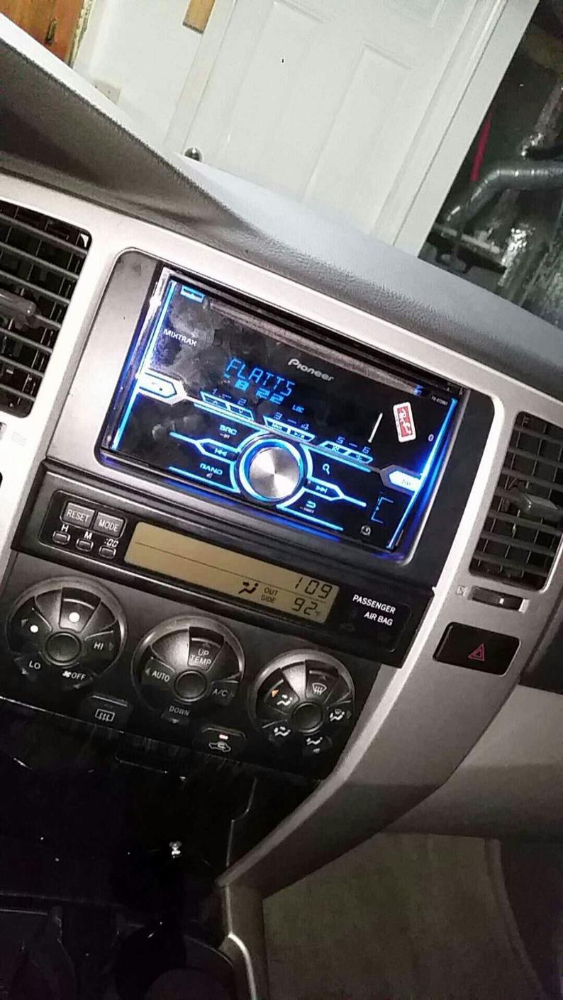

thank you brother. I finally got it done. .
[MENTION=145734]Cpay916[/MENTION] good to hear. thats a crazy looking deck there. kind of tron-like
HAHA YA IT IS ITS JUST A SIMPLE PIONEER FH X 720bt DIDNT WANT A SCREEN AFTER I SOLD MY OLD ONE. REALIZED I DONT WATCH DVD OR USE THE NAVI ON IT. SO I GOT THIS. SCREEN WOULD HAVE LOOKED BETTER. DO YOU KNOW WHERE I CAN GET THE SAME HARNESS I HAD TO CUT FROM? 1 WIRE GOT CUT WAY TOO SHORT AND I HAVE TIED WITH A WIRE NUT. LOL.
dealership is probably best place to get new harness. if its only one wire. could probably get just one wire and soder it together
