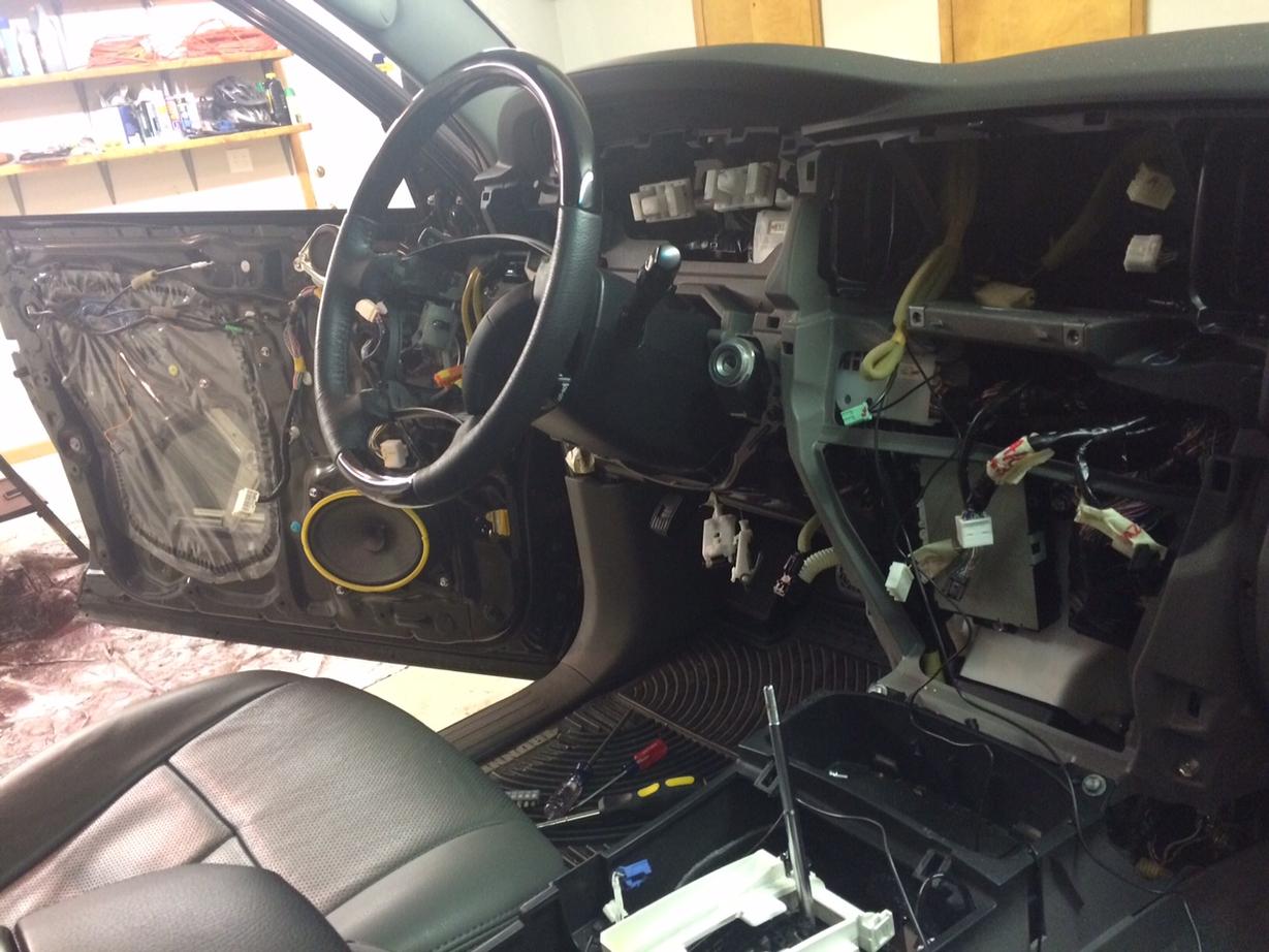

Speakers and head unit took 3 days. Day one took apart the doors and installed the speakers. Then tested the sound.
Day 2 disassembled the head unit. Day 3 put everything back together with the new head unit, amp, and subwoofer.
I studied for a month before taking the plunge. Best car upgrade I ever did and the first time I ever installed a car stereo. Use the trim ring that the TomTom uses, it gives a stock look.

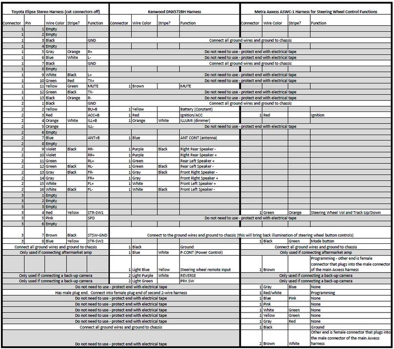

I need help!! I'm very lost. I bought a new Kenwood DNX572BH with Navigation, Bluetooth, and SiriusXM. I have my Eclipse stereo and hardness out. I've connected the speakers and the steering wheel controls (using Axxess ASWC-1). I haven't installed in the vehicle and tested yet because I have a LOT of extra wires. I've read absolutely everything I could find on this forum. The Crutchfield wiring diagram for the Urban Runner doesn't seem to be exactly accurate. I have many wires left over... can someone tell me where these go?
  • R+ (gray with orange stripe)
  • L+ (White with black stripe)
  • R- (Black with orange stripe)
  • L- (Blue with white stripe)
  • TX+ (Green with red stripe)
  • TX- (Green with black stripe)
  • ILL +B (orange with white stripe)
  • ILL - (orange)
  • SPD (pink)
For the 12V constant (yellow), do I just make a three-way connection between the old Eclipse harness, my new harness that came with the Kenwood unit, and the Axxess steering wheel control harness?
This is going to sound dumb (but I'm not good with electrical), but what about all the black ground wires? There are three black ground wires from the old Eclipse harness, one from the new Kenwood harness, one from the Axxess steering wheel control harness, and a brown/black wire that needs to be ground to the chassis. Did you guys just connect all these ground wires together? Once the harness is plugged back into the vehicle, I assume the black wire is already grounded somewhere under the hood.
For the GPS, did you guys just use the GPS antenna wire from the Eclipse unit or did you route a new GPS antenna that came with your new Head Unit?
Lastly... I saw this answered before when searching the forum but I can't find it again. Where does everyone recommend routing the SiriusXM antenna wire?

Hi,
I used the gps antenna that came with the new head unit. I mounted it right above the head unit inside the dash using the mounting tape/magnet that came with it. It works great.
I bundled the ground wires together and grounded the unit using one of the screws that mounts into the vehicle right below the head unit.
I routed my XM satellite antenna on the roof above the front windshield in the passenger side corner, routed the wire in the groove alongside between the front glass and the molding along the passenger side, under the molding into the door hinge area, then up under the glove box into the head unit area. I used electrical tape to keep the antenna wire in place in the door hinge area.
It is true you don't use every wire from the harness. I f you look through my links above you will see 2 wiring diagrams. Double check using both.
I am not sure about the steering controls, but it has to be grounded and you can power it using the yellow lead.

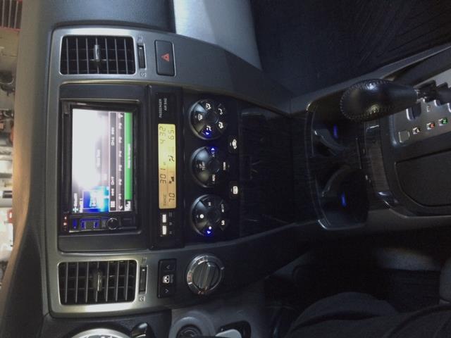

YES! Well, sort of. Thanks so much for your help. I decided just to plug everything into the car with the unknown wires disconnected and everything seemed to work. I didn't leave it plugged in though... I pulled it back out while I work on other things. I thought I could use the existing factory GPS antenna, but the plug was slightly different... so I still have to run and mount that. Once I have everything put back together, my intent is to post a wiring diagram on this thread that includes every single wire (including for steering wheel controls and those that go unused). I'm in Columbus for a conference this week, so I'll probably finish early next week.

Urban Runner Aftermarket Stereo Head Unit Installation Wiring Diagram
Here's a complete wiring diagram/table that worked for me (I'm trying to attach a photo and a pdf to use whichever is easier). Each row in the table represents a connection. I installed a Kenwood DNX562BH... connections may be a bit different for different head unit stereos. Note that this ONLY applies to Urban Runners that have the Eclipse Tom Tom unit from the factory. It also assumes you use a Metra Axxess ASWC-1 for connecting your steering wheel controls. There are a lot of wires I didn't use. If you install a backup camera or aftermarket amp, you may end up using more wires. Let me know if folks have questions.

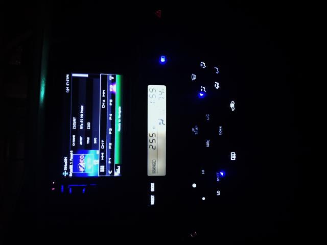

Finally got back in town and finished everything up. I love the new Head Unit. The improvement in sound (even with the factory speakers) is unbelievable. Looks sharp with the blue backlighting and the other white/blue LEDs I installed around the car to match. Also plasti-dipped the interior plastic trim to a darker glossy gray.
One thing I haven't figured out though is the steering wheel buttons. They are working fine... vol up/down, seek up/down, and mode. When the factory Eclipse was installed, the up and down arrows on the steering wheel scanned between presets. If you held them down, they would seek. My Axxess ASCW-1 harness supposedly allows programming of dual function buttons (short hold vs long hold), but haven't figured it out yet. Kenwood units also have an option in the software to change the functions, which I think is what's confusing me. There are two competing ways to do it that seem to be interfering with each other. Do I make any sense?

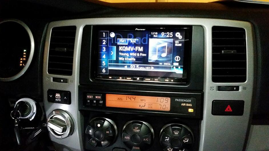

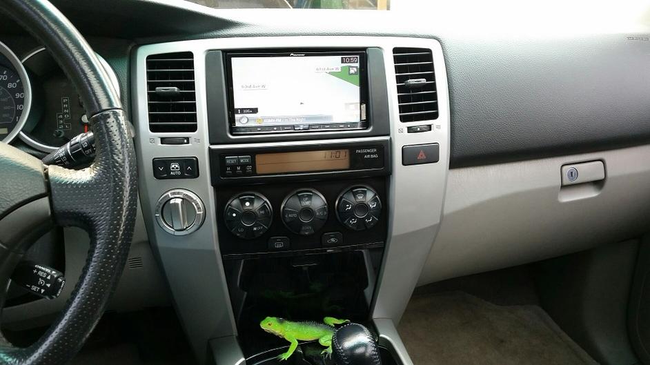

I just finished installing a Pioneer NAV on my 2008 Urban Runner. I'd like to thank everyone who has contributed to this thread so far. The info from this thread has been great!
Here is a quick list of parts:
  • Pioneer AVIC-7100NEX
  • iDatalink Maestro ADS-MSW Steering Wheel Control Adapter
  • Posi-Products Car Stereo Connectors
I have installed 3 or 4 decks before but this is the first time I get to cut the factory harness so it was a little nerve-wracking. Took me about 5 hours from start to finish, but I took my time. It was actually pretty straight forward and fairly easy. The Maestro is super easy to set up with the web programming, and the steering wheel controls work wonderfully. Like others have stated, the new stereo sounds so much better, even with the stock speakers.
Still need to do: parking brake bypass, back-up camera, mounting the microphone, aux plug, and 2 USB to switch blanks.
