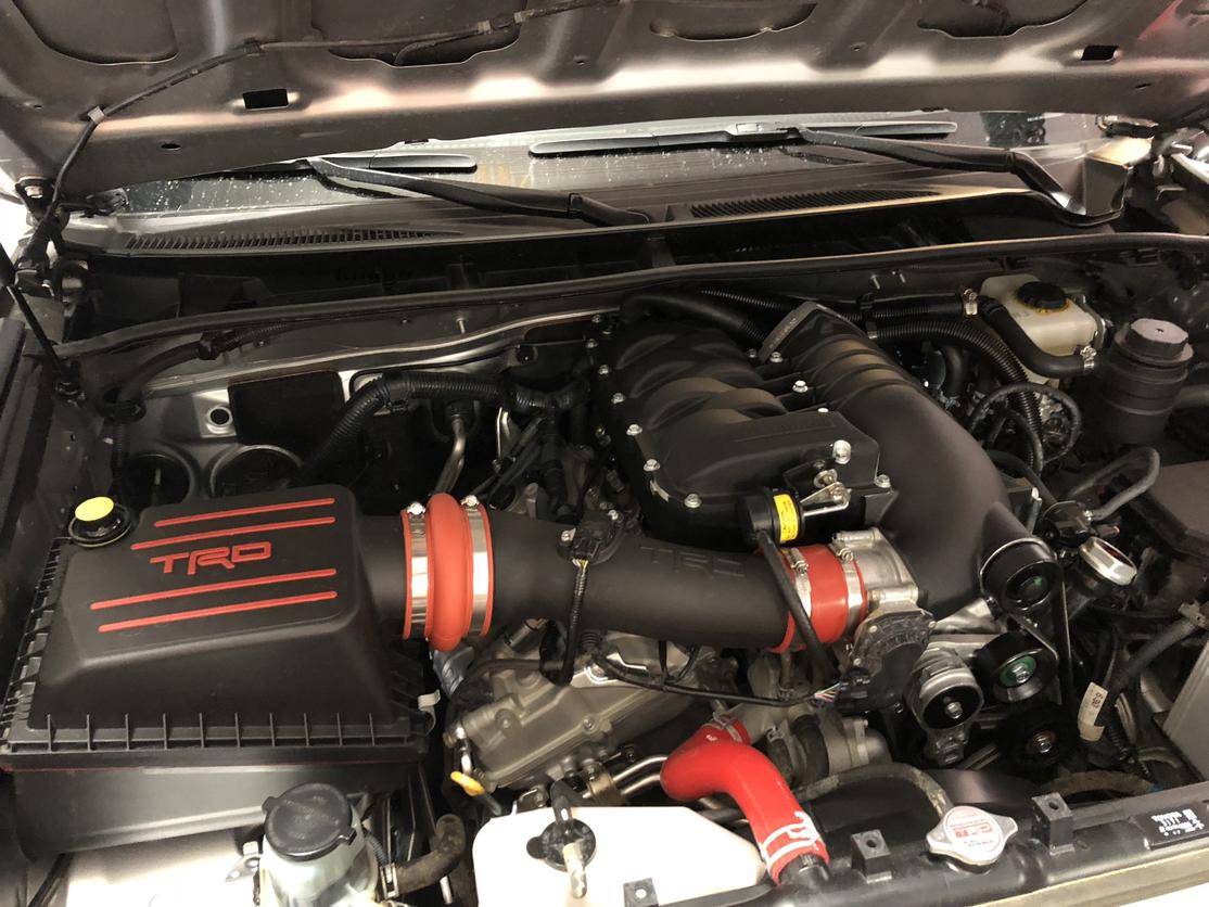

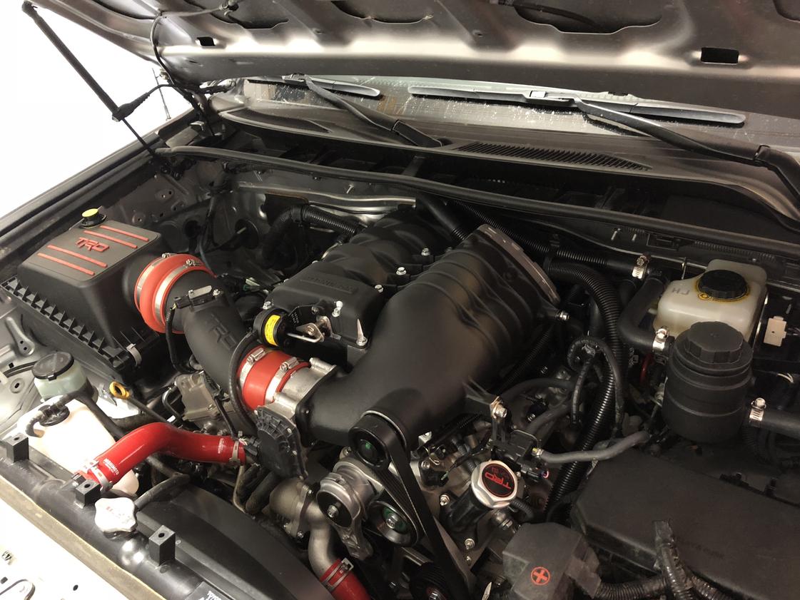

Magnuson S/C installed!
Just completed the installation of the Magnuson Supercharger! It's awesome! Dustin at Magnuson was amazing with support and Dan was equally helpful! I'd highly recommend to all fellow 4runner owners who constantly think about what their truck needs.
Time for 4WD burn outs on asphalt!! Weeeeeeeee!!
:girl:
These Magnuson and URD supercharger installs look clean and OEM. It's a shame Toyota punted on offering the Magnuson as a TRD upgrade option.
Rad! :thumb:
Hey, quick question, has your truck been running hot? I ask because I see a bunch of schmeg on your coolant overflow return house.
