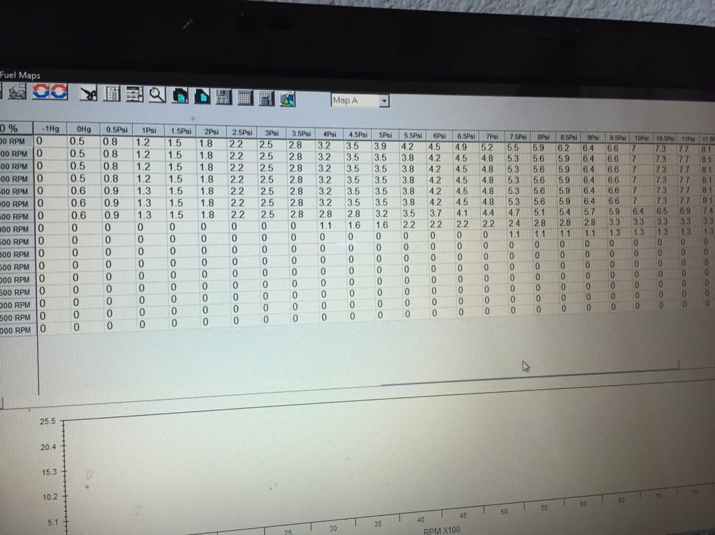

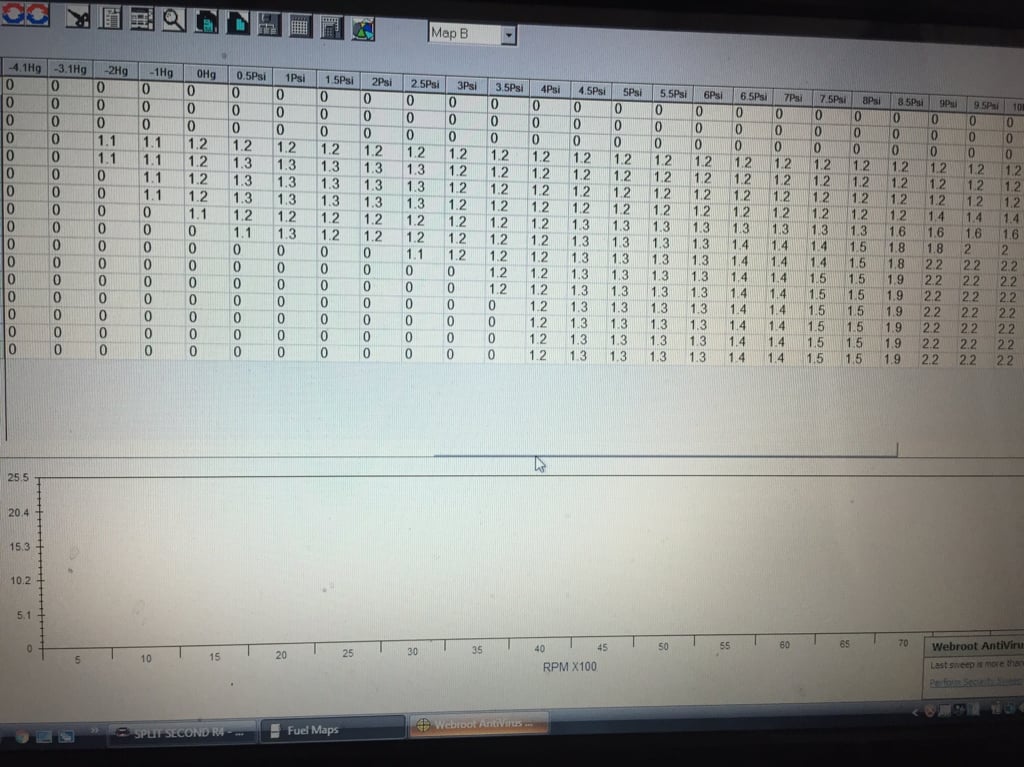

1. I've been able to get the R4 Engine Management Software installed on my Laptop.
2. Installed the Driver for the Serial -> USB Cable I bought.
3. Figure out that it's looking for COM4
4. Connect to the ECU
5. When I click "READ DATA FROM ECU" I get the pics below. Do these look like the stock map(s) ?
EDIT: Just noticed this: http://www.toyota-4runner.org/3rd-gen-t4rs/201123-urd-7th-injector-tuning-guide.html#post2061716 - so it looks like I do have the stock map.

Yeah those maps look stock.
