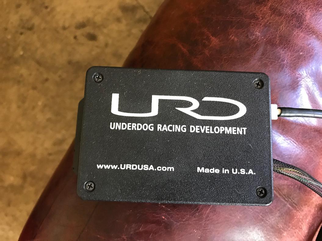

Is this different than the computer box that comes with the 7th injector?
Does it look like this?
