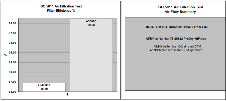

Paper filter 99.86. AFE 86.80. Percent of dust captured in ISO5011 air filtration standard test.
I don't have a dog in the fight. Just letting you make an informed choice. If you go in for service with an AFE filter and its noted in your service record you should expect the engine warranty to be voided. Completely justifiably so. You have chosen to allow 300 times as much dirt into the engine. If you want to still use it and care about the warranty you should probably take it out before going in for repair or service.

Completed some research after seeing your post. Interesting data but noted it was completed by S&B that is a direct competitor. Please note I also found other independent testing supporting the AFE Claim of 99.2% filtration.

Ask yourself which result passes the smell test. Can you have equally fine passages in the filter media and also reduce air restriction by 45% ? I don't need a test to tell me something's fishy.
I really don't care either way. I wouldn't use one. Just giving you a heads up about warranty. The guy who's buying a new Tacoma engine probably would have made a different choice with knowledge of the consequences regarding warranty - whether the filter caused it or not.

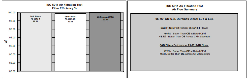

S&B claims their filter has the reduction in air restriction while maintaining the filtration efficiency. Not sure if that passes the smell test.
test by s&b.

Logically, how do you move more air and filter out the same amount? Just basic physics of airflow tells me that permitable particle size trough filtration media is sole determination of both velocity and resistance. Why not use so called CAI such as TRD but original paper filter? Its ducting designed for straight-trough flow without silencer baffles and chambers.
To be clear, I do think the OEM filters do a little better job at filtering dust.. However, running an AFE will not void your warranty...
Is the convenience of a washable filter and slightly less restriction worth it? Hard to say....
If the motor was full of dirt and sludge... that could result in a denied warranty claim, but it would not matter what filter was in the box at that point.
The conditions you run in, how clean you keep the filter, and where your inlet is located has way more impact than anything else. Those with aftermarket bumpers and no snorkel end up with a direct path for dust into the air box.
