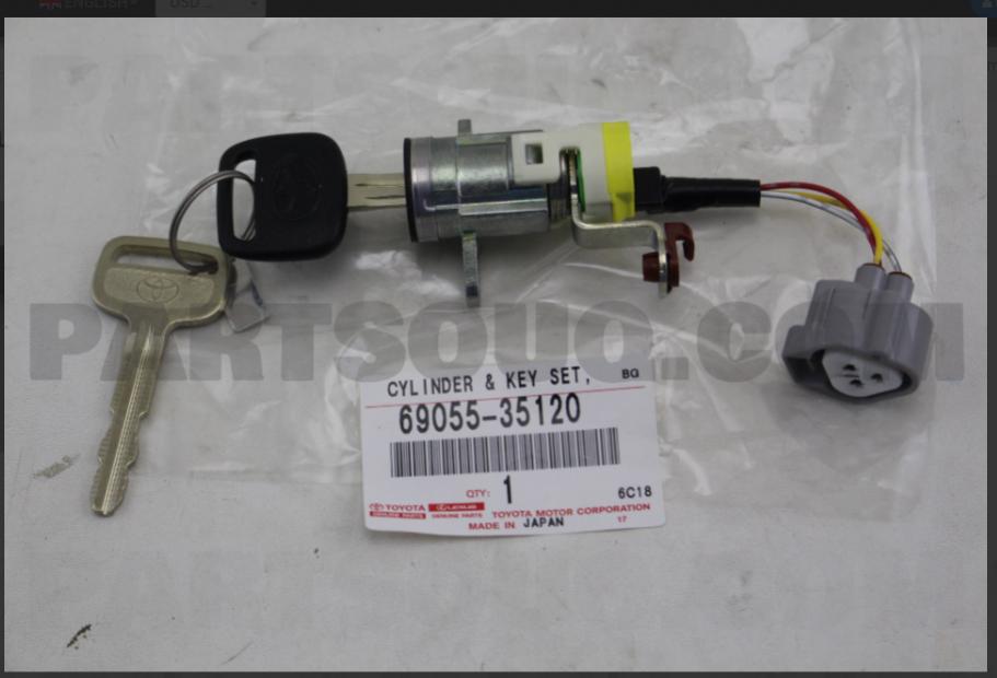

this is the clip that broke, it has two clips that go over the two humps on the lock
My bad--that clip is attached to the wiring for the lock. So the part number would be part of the lock assembly, not the Garnish. You dodged a bullet!
So is the lock cylinder still attached to the license plate frame (garnish)?
yeah, it is, that's why i was confused lol
you're all good tho, i'm much more relieved i don't have to replace the whole thing, just that clip.
i'll probably run down to pick n pull tomorrow to find one there.
thanks!

Best bet to find it would be to find a lock cylinder assembly at a salvage yard or lkq and use the parts on your existing cylinder. if not you'll have to get a new one and get a lock smith to re key it for your existing key.

Did the clip break because of brittle plastic? Expected, given the age of our rigs.
Even if you can't source a replacement pig tail connection, you tail gate still can be secured via key (providing your license plate garnish is still good). The only inconvenience will be is the fob may not work. And locking and unlocking via key will only work.
got it fixed today, went down to the pick n pull and snagged one out of a 96, seems fine, thanks for the help guys!
