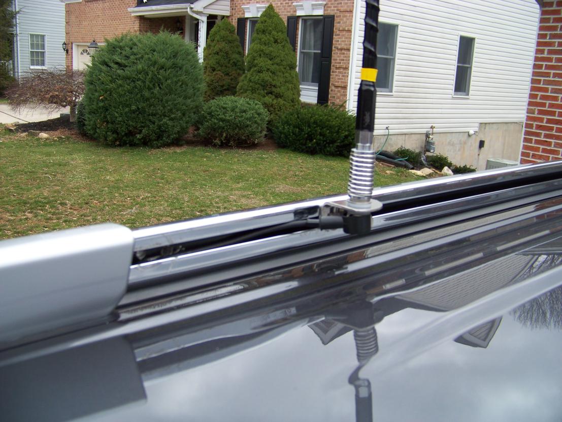

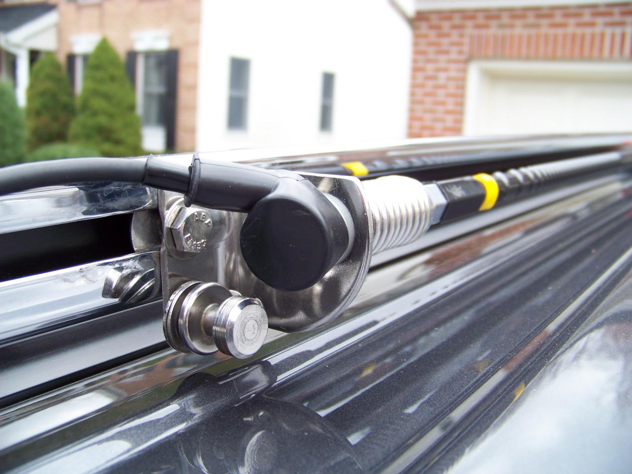

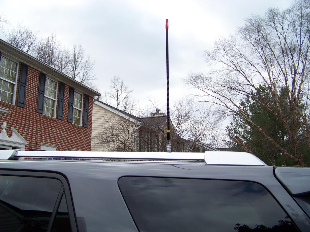

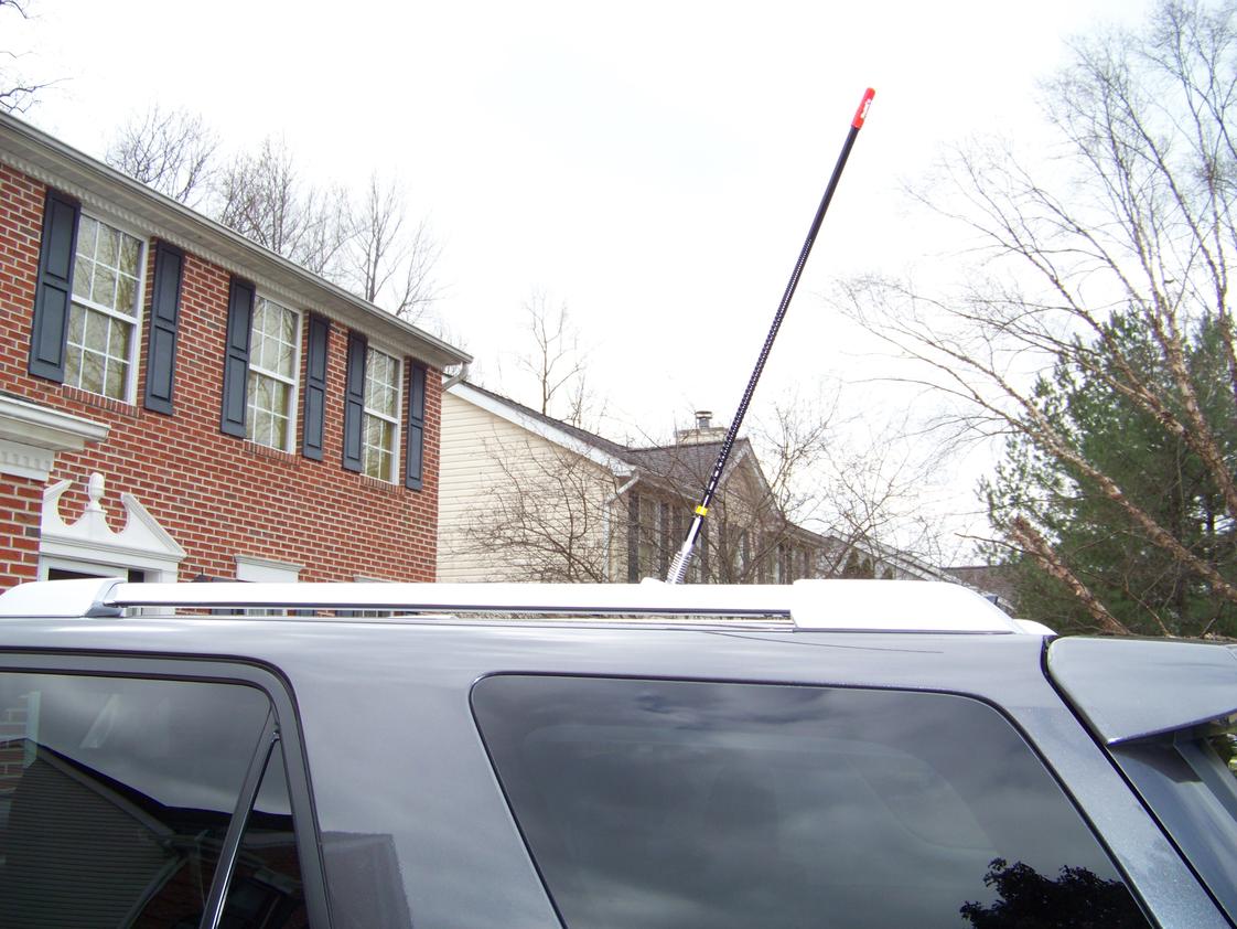

rdg- Welcome to the Forum! The Cobra 75 is very easy to operate, and it'a a quality CB. The tiny speaker is a little weak, that's why they provide an external speaker jack. This is my Firestick antenna kit. fgx-648.jpg This antenna does NOT require a ground to operate. I used the right angle bracket only, and by using a stainless bolt, locknut and washer, I slid the mount into the channel of my luggage rack. I tapped another hole to allow for a set screw that locks the antenna straight up, angled back (to help reduce wind noise), or folded completely forward so it fits into my garage. The cable routes under the plastic endcap, through the rain channel, and into the existing factory rubber boot under the hatch. I am very happy with the results! I plan on doing a writeup, but my 2 little girls have been keeping me too busy!!

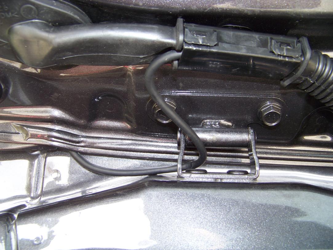

Very slick install. How does it go from the roof rail to the rain channel to this:
did you drill a hole or am I missing something?

Thanks Mike! My swris 1:1 on the low end and 2:1 on the high. I'm still messing around with it a little. It has pretty good range, farthest radio check so far was about 6 miles or so. No hole was drilled, the wire comes out the back of the rain channel off the roof, through the hinge, and into the wire loom. There IS a hole in the rubber under the plastic loom holder that the wire is sealed into if that's what you mean. You have to cut a small slot in the back of the rain channel plastic cover for the wire to exit from. Try to get some more pics 2mrw- I'm @ work!SHHHHHHHHHHHH.
Thanks so much for the positive comments!! It's only a 2 foot NGP Firestick. Only downside is the wind noise over 60. Even laid back it still "howls" a little. I got another antenna in the mail 2day (can't wait to get home!), that will work. It looks like a cell-phone antenna (made by Firestick as well). Really don't want to use this, but I may have to. The moaning antenna makes my wife moan, and not in a good way:naughty:

Coax comes down through the rain channel, and across the hinge, then tied to the washer fluid tube (low point when door is closed, for drainage) before entering into the vehicle.
I made the smallest hole possible and stretched it over the cable. It's very snug, no rips, and the factory wiring remains protected.

Awesome!! I'm glad I helped you out- this forum gets better every day!! That turned out really sweet, I like the mount alot! Lessons learned from my install: put some wire loom ( I used the kind that wraps around kinda like a spring) around that coax from the point Where it comes out of the rain channel until it enters your grommet. Mine was starting to show some wear. I actually took a grinder to my antenna spring. I cut 3 coils out of it, heated up the spring a little bit, and hammered out the end. Then I reinstalled it into the shorter spring. Helped alot with the crazy flopping around! Can't wait to see the cb installed.

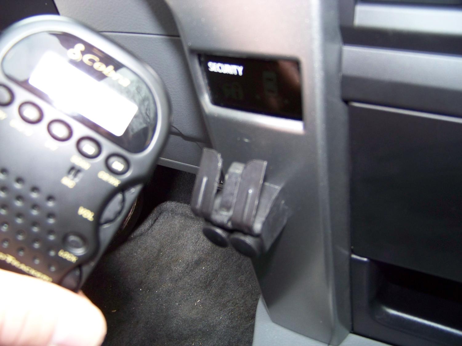

I shoved it under the center console, in between the passenger side plastic and the rectangular slot in the center console. If was a tight fit, but some 3M tape holds it securely. I used one of the bolts holding down the the yaw sensor to ground it and as a result I get zero interference from the ignition system (thanks random tip on the internet!). I used an add-a-circuit in the spot reserved for seat heaters since I don't have any. I'm still debating the final placement of the handset and I need to clean up the wiring a bit, hence the lack of pictures. I did buy a stereo mini plug and routed it up and behind the AUX input panel, drilled a hole to allow it to pass through back into the cabin, and plugged into the AUX input. Works great, but you can't just unplug it from the AUX and use the speaker on the handset because the other end of the plug is still in the CB. I'm pondering that decision, but I'll probably just leave the cable unplugged at both ends unless I know I will be using the CB constantly.
