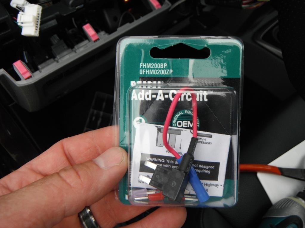

I was looking into installing a CB like yours mounted to the stock roof racks. I purchased the Cobra 75 and the firestik antenna kit. But I was wondering if anyone has any details on what to use to connect the CB to the fusebox? This will be my first electrical mod, so as much detail would be appreciated. I know people have wired into different fuses, but what do I need to get to wire the cb in? Also did you have to purchase something to seal the antenna connection from the rain? I see that you have a rubber housing on the bottom of the antenna, is that included?
This is what I used (remember to get the MINI tap)- no need to cut or tap into any wires. You can get this at any autoparts store. If you want the CB to be on during only when the ignition is on, use the P-Outlet fuse.
Thanks Antman!
I'm thinking of just installing an auxiliary fuse box and just powering the CB through there now. Should have to use these minifuses as well.
