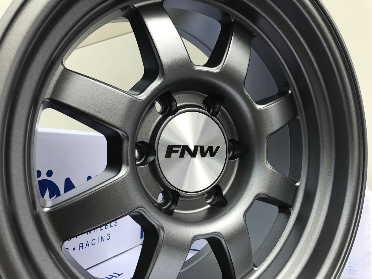

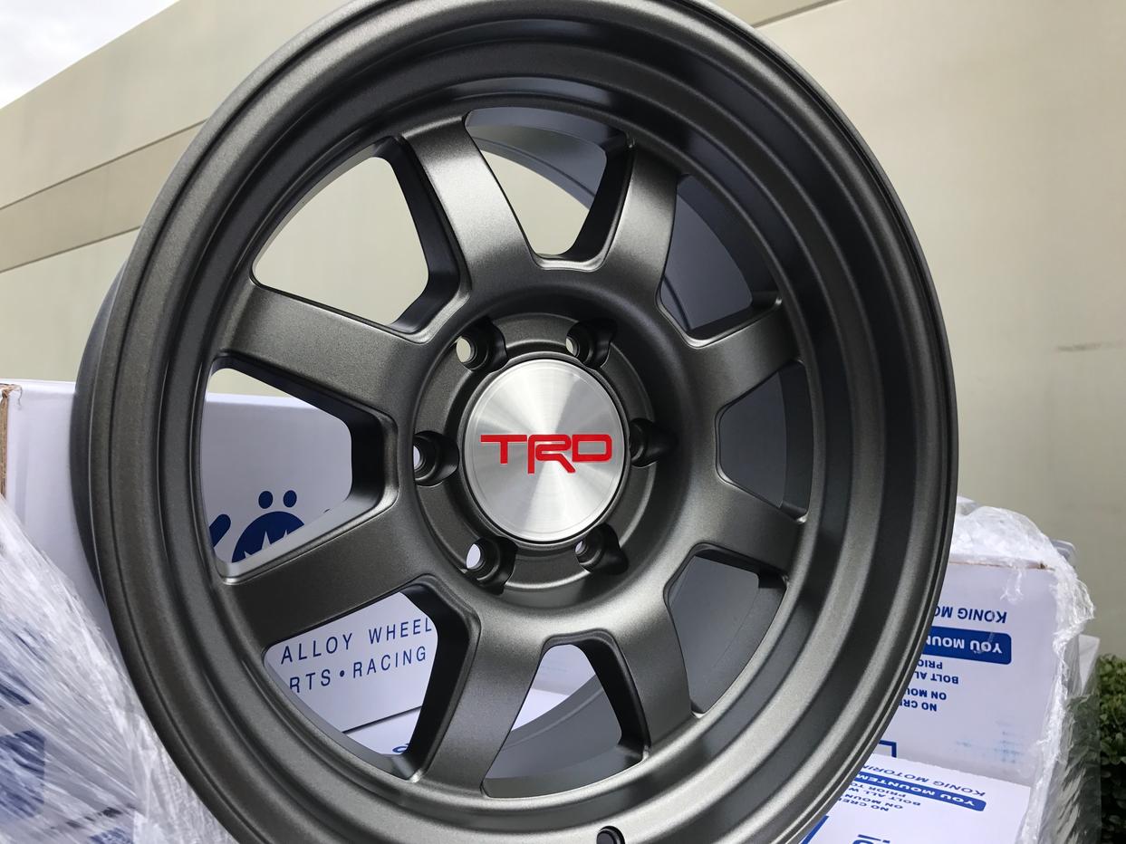

FN just came out with a new set for our truck. I was waiting for the FX PROs to come back in.....now I'm switching.....
17 x 8.5 -6mm offset

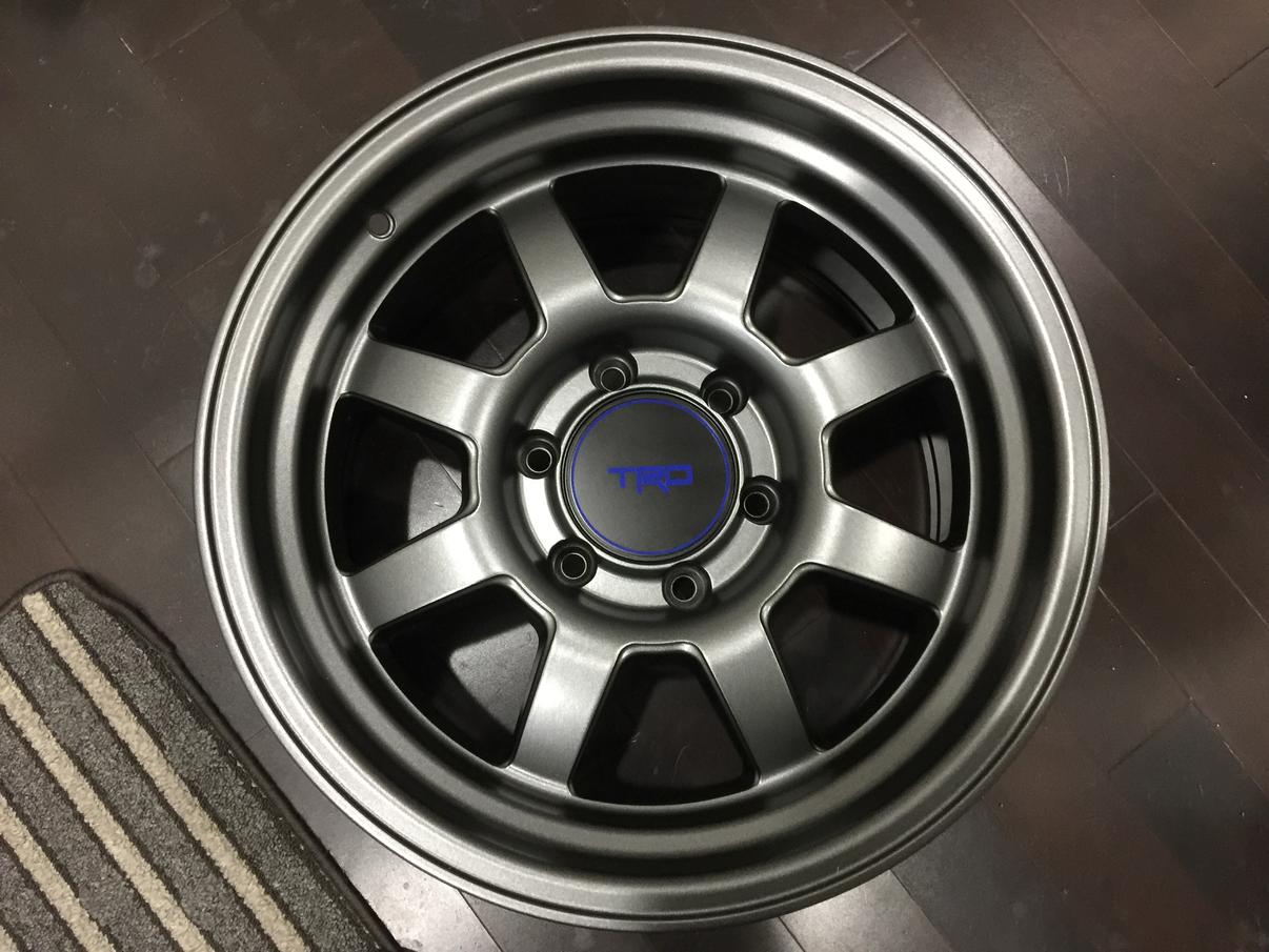

Delivered yesterday but won't be able to mount them until next week. They're absolutely perfect !!

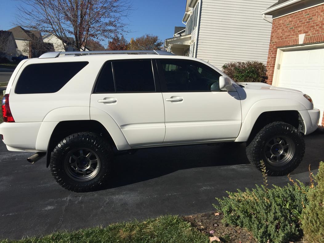

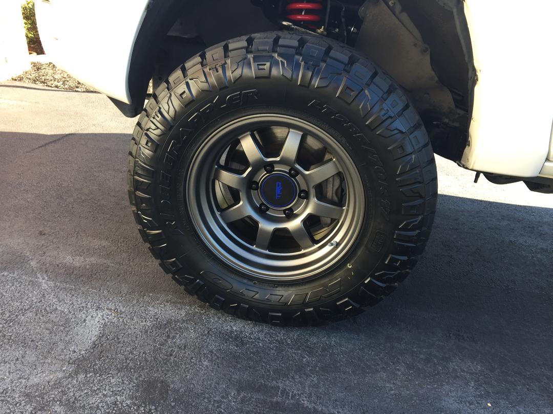

your pic, makes them look better than pics above. look good. What are you doing with your current wheels?
This is for a different 4Runner Sport that I have - those stock wheels with Michelin Long Trails are being put up for sale next week. The '03 in my signature was (stupidly) sold a few years ago ....
Ummm wow. That looks great! Details on wheels, size spec, tires and lift size plz!
FN Verge wheels -- 17 x 8.5. I was the first one to get them from Dustin - he's an absolute great guy to talk to.
Tires are Nitto Trail Grapplers 285/70/17 C
Lift is Toytec Boss
