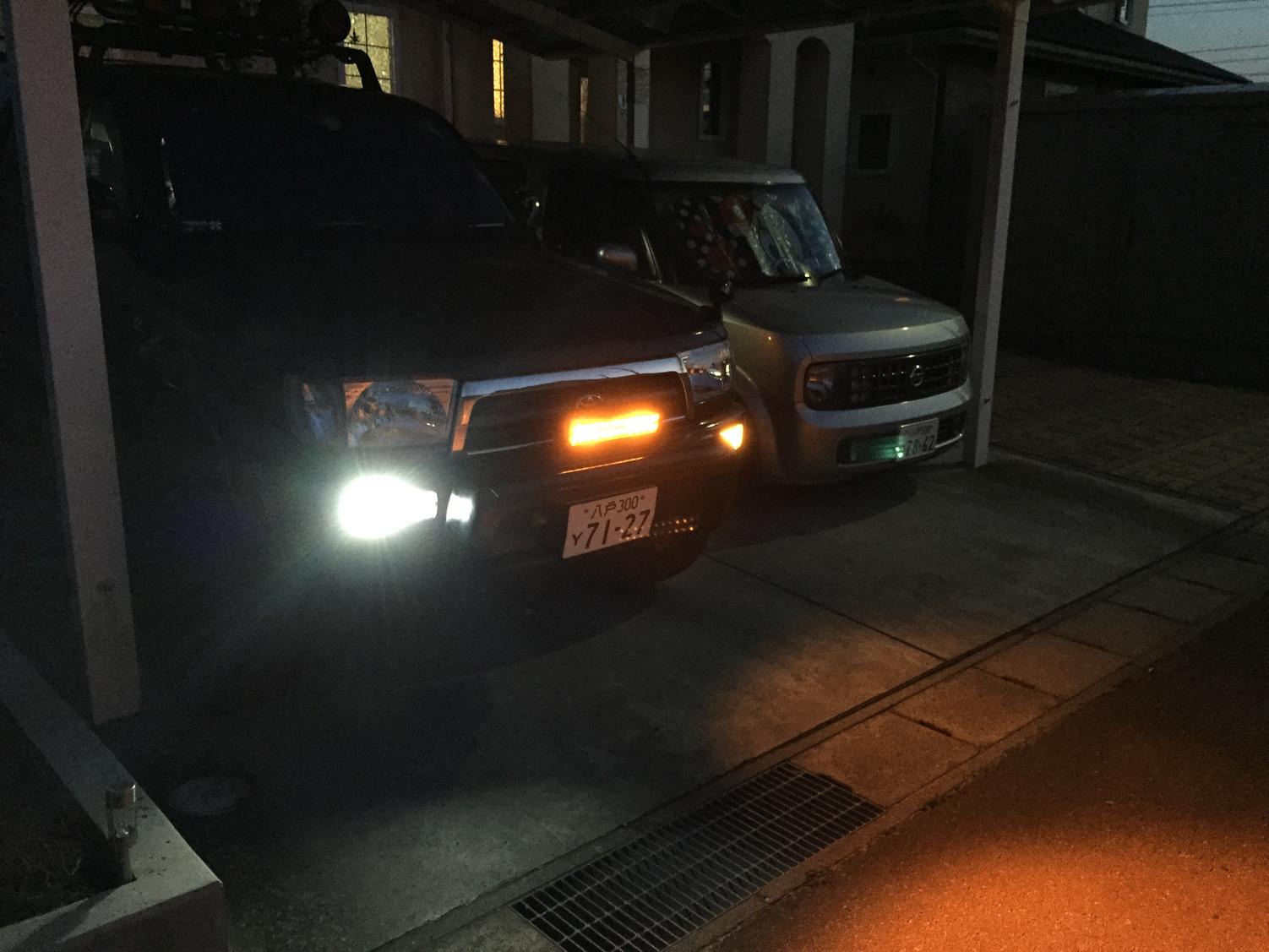

I just turned my front blinkers into switch back bulbs and ran a single accessory wire to them for the DRL activation. So the blinkers are on with start up and switch to Amber when blinking then back to white once the blink is off.
They are pretty damn bright.
Sorry this does not help your problem but figured I would mention it.
Here is a pic of one blinker on and the other as a normal DRL, ignore the middle led bar. :)
