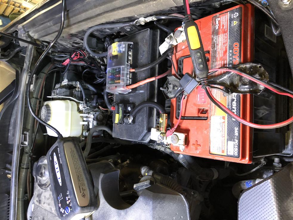

Hi jayhat
i have the same setup for the last 8 month , works very good for me .
MK3 Micro blade 7.5A (Electronic fuse version)
https://www.hkbelect.com/product/143...-version-2013/
Spacer for Group 34 batteries
http://shop.odysseybattery.com/p/spa...p-34-batteries
Odyssey Batteries Extreme Series, Group 34R
https://www.4wheelparts.com/Electric...ODY34R-PC1500T
Just for peace of mind, I will probably get a CTEK 7002 and connect it to the battery every 2-3 weeks to ensure it's being properly charged. This will also integrate into the power box I have speced out below.
CTEK 7002
https://www.amazon.com/dp/B000FRLO9Y...S8RH18VZ&psc=0
no solar or second battery.
Hi jayhat
CTEK 7002
Sweet thanks for letting me know!
