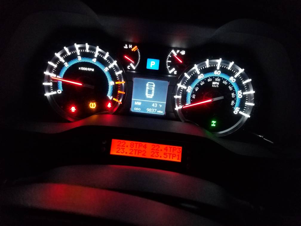

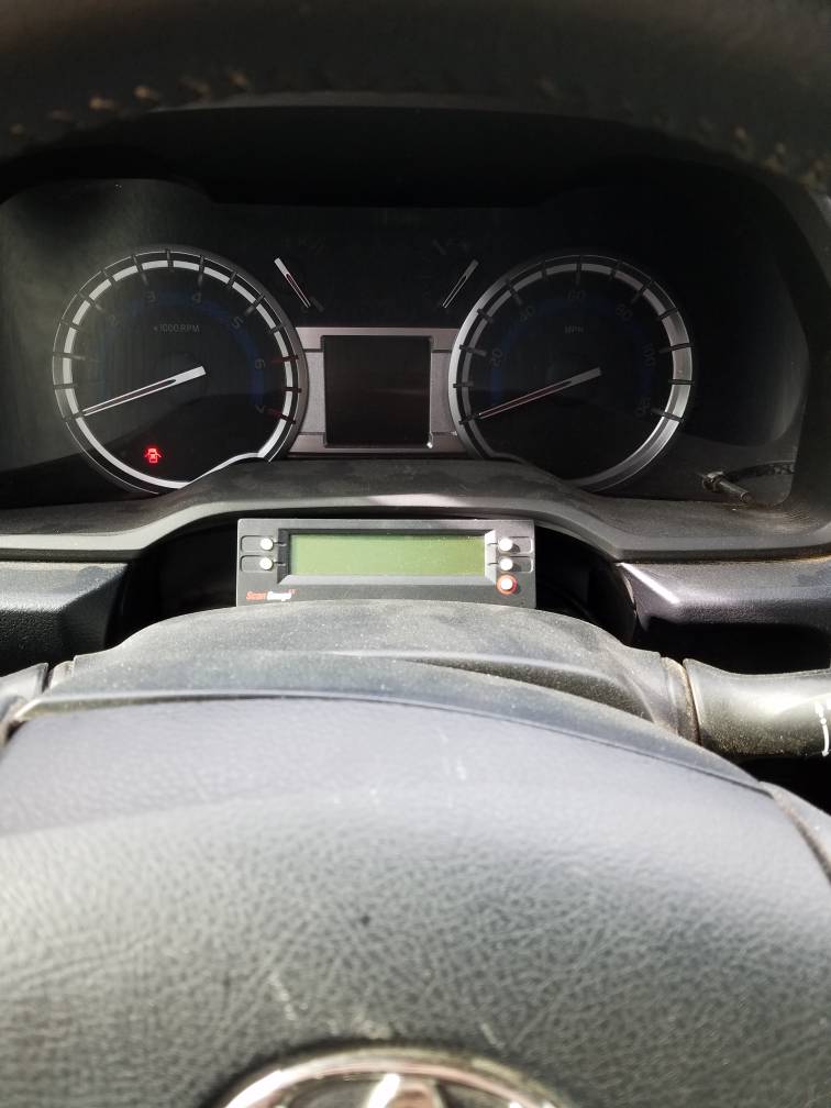

Been running that scangauge II now for a little bit only really messing with the tpms (haven't had time to mess with the other TFT's). It works quite well it's got a little delay to it, I think it updates every 10 seconds or so.
With all the extra features to include the ability to read and clear code I think it's a winner. Not to mention how outstanding the company was.

Scangauge II / Pedal Commander
Was going to buy a scangauge II when I read that you can program them to give Tpms readouts from then oem sensors. Not to mention all the other vitals it gives.
I forgot I actually had one already for my 3rd gen sitting in a friend's vehicle. I heard a pop when I pulled the cord and noticed I had cut the cable. No biggie as scangauge HQ is in the same city as me. Well turns out I fried the board. Scangauge not only hooked it up with a free cord, but then threw in a new board, updated the unit, gave me all new instructions for FREE no questions asked. Literally came in for a cord with a broken outdated unit and came out the door with basically a new unit. Now that's a ****ing company. [MENTION=178113]ScanGauge[/MENTION] you guys are awesome.
Programming the tpms took about 30 mins to figure out and perfect. Works like a charm. It's not second to second accurate I think it updates every 10 seconds or so. After a side wall puncture a few month back I knew I needed more than an idiot light when airing up and down all the time. Haven't got around to programming the other goodies.
Pedal commander or something similar like the Sprint booster is a must IMO for these vehicles. Too much dead space in pedal travel. Pedal commander cleans up the throttle curve programming quite a bit too. I'm in sport mode one tack from max. I leave it like that all the time. Just wish someone would get rid of the remaining dead space. Part of me wonders if I could manually adjust that out of the pedal so it already sits right where the vehicle start opening the throttle. I always feel like it's a surprise when it finally engages (I lurch forward from a dead stop more then necessary it was worse without the pedal commander).
Sent from my SM-G930T using Tapatalk
[MENTION=317678]UtahRnr[/MENTION], care to post a pic of where you ended up mounting the rear interior window switch? I have all of the parts coming and plan to do the install this weekend, time permitting.
