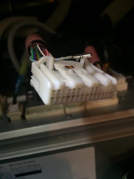

Got the navigation/head unit lockout features bypassed thanks to the great posts here on the forum - mostly this post by [MENTION=79237]sigepbiker[/MENTION]
PC: [MENTION=79237]sigepbiker[/MENTION] -- this is the same wire that I cut to override in my 2017 navi
I decided to put a switch in. At first I wasn't going to but since I had a switch lying around and the dash was apart, it was only a few extra minutes to do the soldering and stick it in there. Now I can override the lockout at will with the switch so my passenger (ahem) can use those functions on the head unit.
Glad I could help! I understand why Toyota makes it operate like this, but sometimes you just need to override it.
