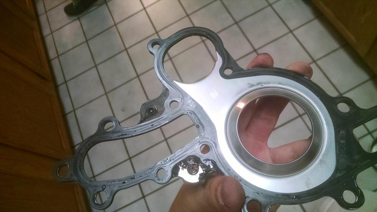

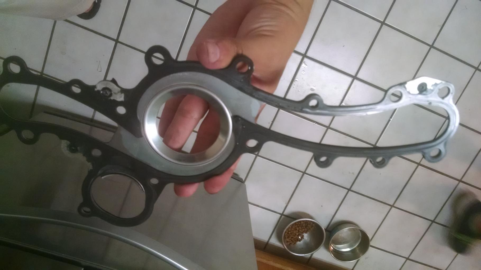

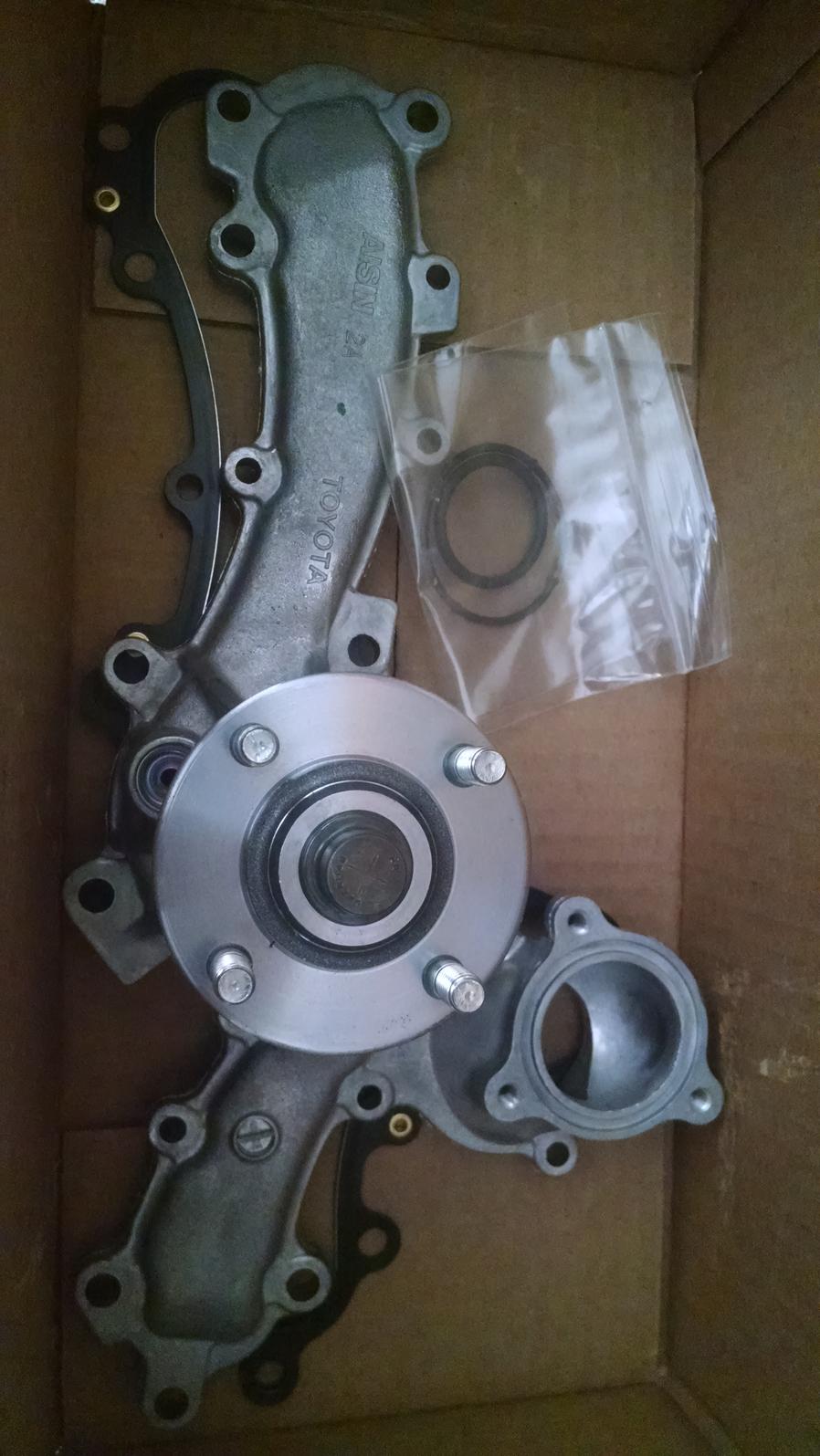

Have you check your water pump and gasket? My gasket was bad during one of my track days and raced with the heater on to not over heat. I replaced both the gasket and the water pump as the bearing had a little play and both were original. BTW Toyota has a revised/updated water pump for the 1gr.
