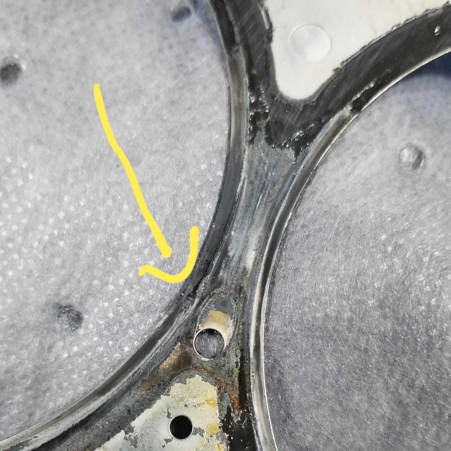

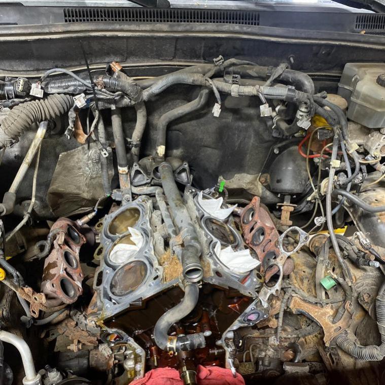

Hi guys need some tips here. I am about 11 hours away from home and having some coolant problems.
So, the first stop on my trip i noticed some coolant dripping from the coolant overflow tank. Now the truck is behaving like it should with no overheating. First thing I did was unbolt the tank and dump it back in to the rad . 2 hours later I was able to get some coolant and a new rad cap. Filled the rad to the top and replaced the cap... No difference. Coolant dumping into the overflow tank and not going back to the rad with no overheating.
EDIT: Just realized someone resurected a Zombie Thread, I will leave this up for anyone else anyways....
That's what mine did when it needed head gaskets. YMMV. I had no overheating or misfire..just very small unexplained coolant loss and the occasionaly startup waterfall noise through the heater core. Good luck, they're a pain in the ass.
I did my timing chains, waterpump serp belt tensioners and idlers (plus some other stuff) while I was in there. FWIW I had my heads milled .008" with no issues. Definitely get your heads checked and milled if necessary. If you have questions I would be happy to help.
