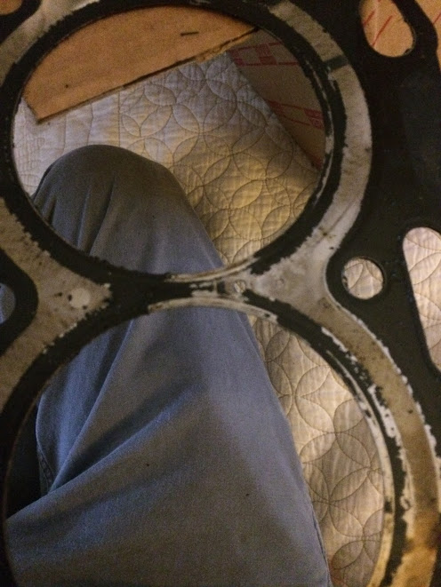

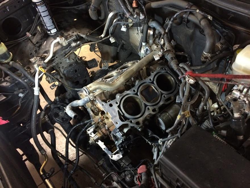

here's how she sits now. Will take a picture of the head gasket in a few days. It is the same as everyone else's...a small amount of the black removed between #4 and #6...
Head gasket
Total amount for repair was $3491. Would've been a little less but Machine shop charge was $180 and they replaced a timing chain tensioner which was another $100. They did good work though. Quality Automotive near Raleigh, NC if anyone is curious.
