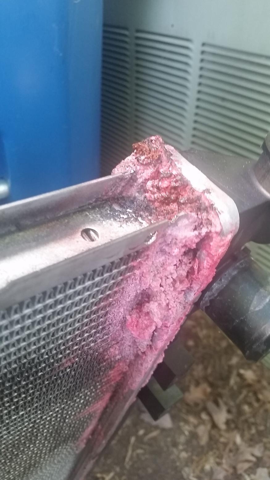

I had a pinhole leak on the top of my radiator, and you only could see it if you popped the bracket off at the top of the radiator.

Found the pic of the radiator.
