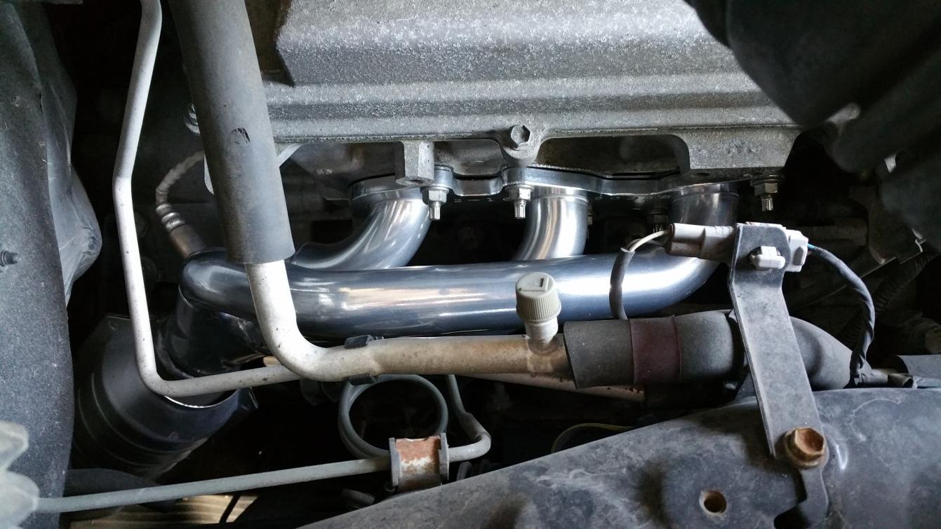

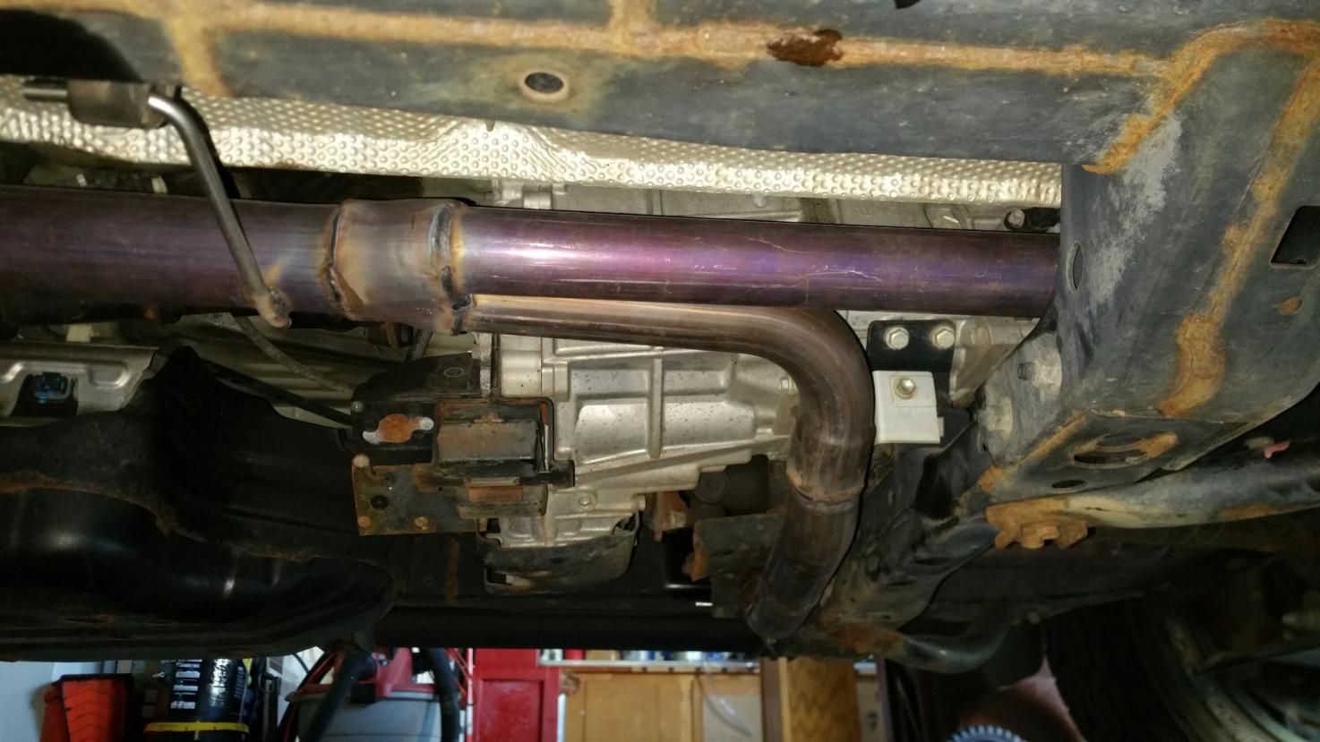

I went with the JBA shorties. Install with new cats, a custom built Y-pipe and rear cat delete was just north of 1K. Any good shop will be able to build you a Y-pipe cheaper than buying aftermarket. It will definitely clear your CEL if its just P0420 & 430.. I went back a year later and had them put in a Borla muffler with resonator delete and tip re-routed to the side. Sounds great.
Pics for reference
