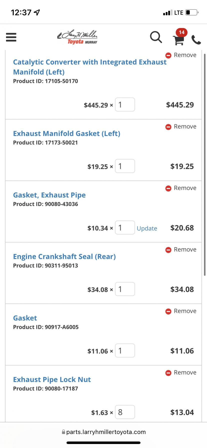

I’m about to do my drivers side manifold while I’ve got the transmission and T-case down for the rear main. I’m not going to do headers but just replace the manifold with a stock one and hope it lasts awhile. I have an 04 V8 here’s what I have for a parts list so far. Hopefully it helps you.
