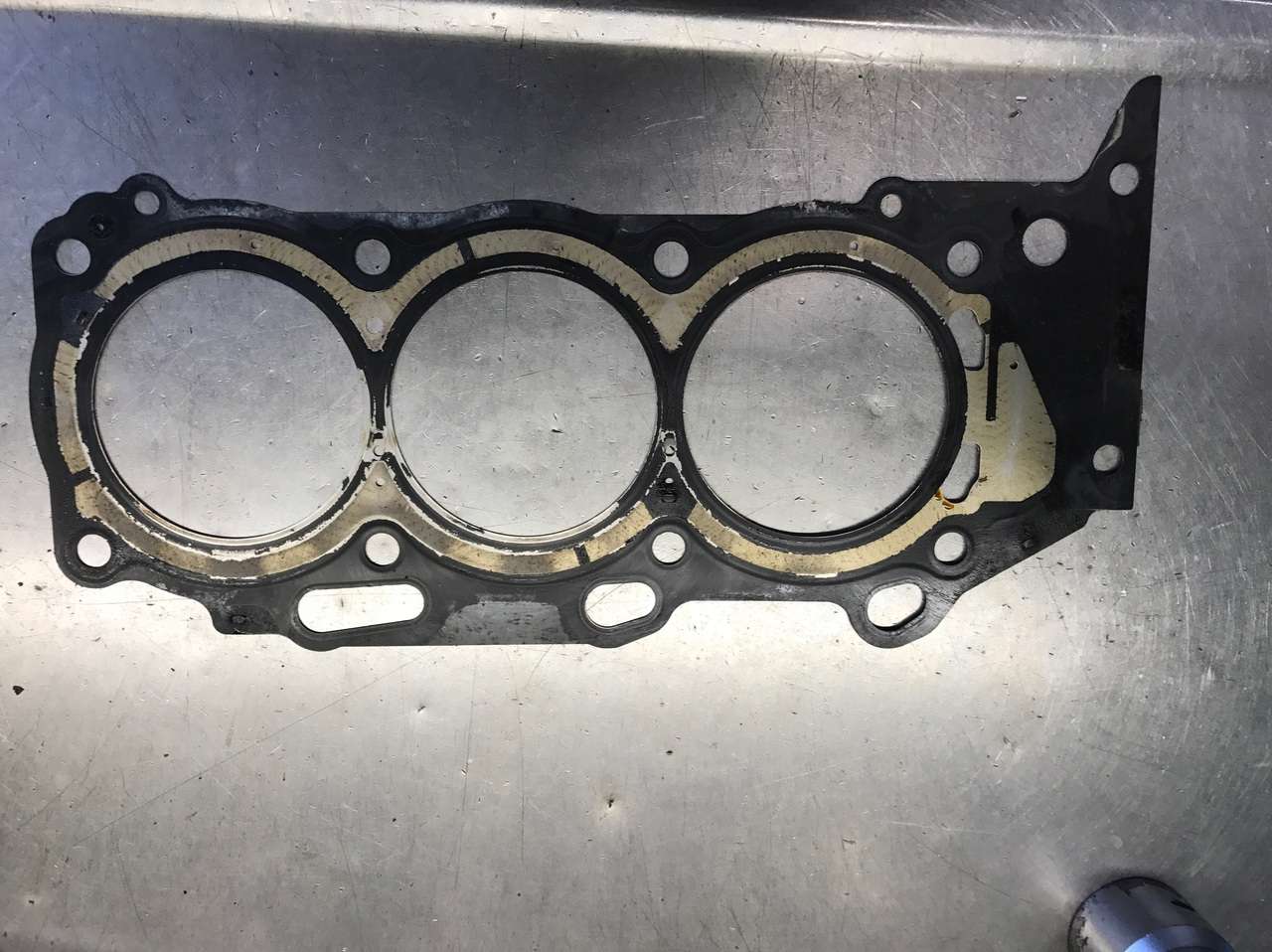

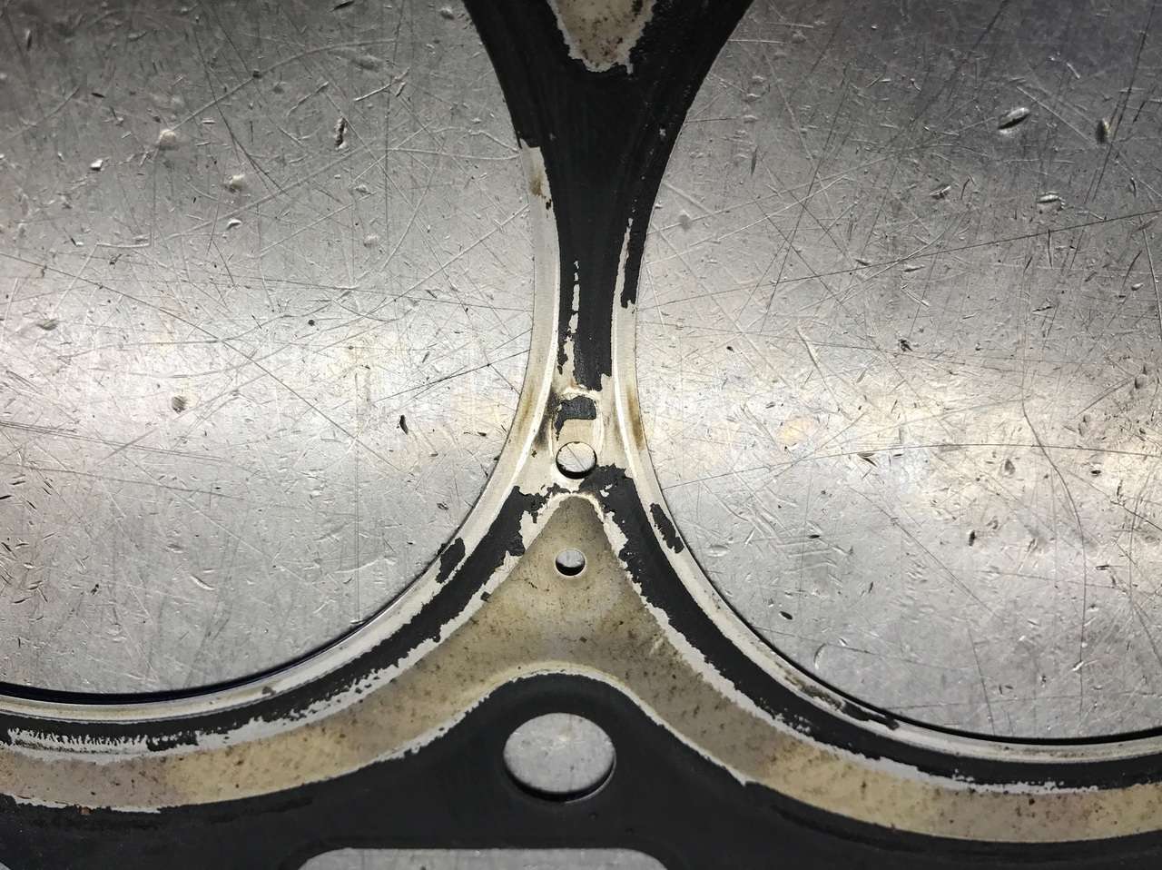

Unless you actually overheated your engine, your heads should not be warped. The leak comes from the gaskets failing, not the heads warping. In the picture of my gasket below, you can see where all the black material has worn off, causing the leak.
