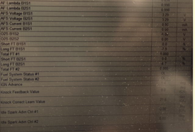

What do you think of these numbers? (Engine was off)
Short FT B1S1: 0.00
Long FT B1S1: -7.9%
Total FT #1: 0.00
Short FT B2S1: 0.00
Long FT B2S1: -4.7%
Total FT #2: 0.00

Modern ECMs I've worked with store and report fuel trims in 2D table cells according to engine operating conditions, usually RPM on one axis and calculated load on the other axis. I examine fuel trim data at hot idle, cruising speed, and high load acceleration e.g. uphill at ~50% throttle to get an idea of how the engine is running.
Thanks for that, I'll dig the laptop out again and report back
