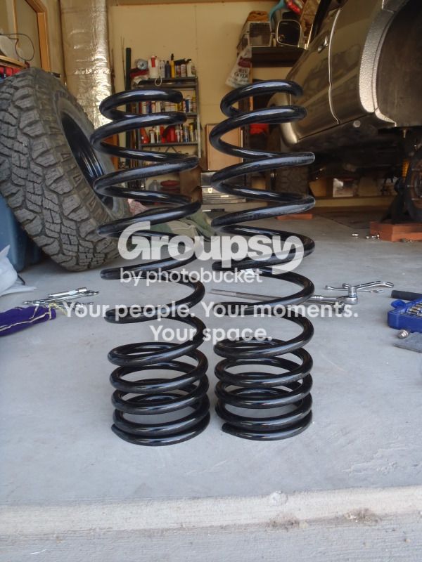

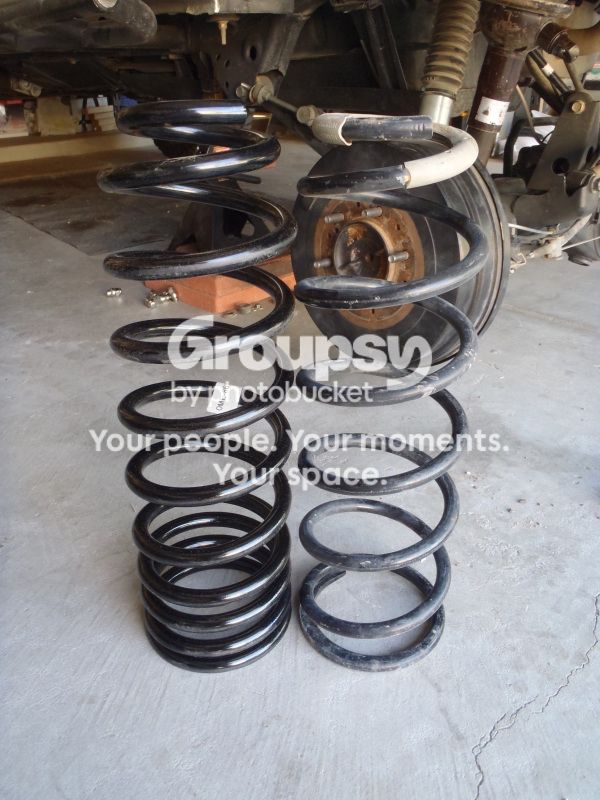

Today was a productive day for the '01. First, I got the 861's installed.
Notice the difference in the height of the two coils. The "A" coil is the shorter one on the left, and the "B" coil is the taller one on the right. I installed the "B" coil on the driver's side to help compensate for the additional weight of the gas tank, cargo box, and my fat ass.
92315d1a.jpg~original
OME 861 vs. LC 7.5 wrap that came out. (P.S. Amening, check out the jack technique! It worked great, thanks!)

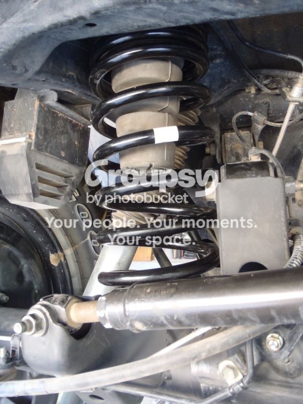

Installed! Notice that I re-installed the factory "Cone Bumpstops". I did this to net the extra bit of lift height and to keep metal off metal to prevent any noise, wear of the finishes, and corrosion.
5bb9a72b.jpg~original

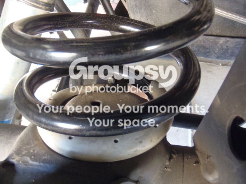

I also took the rubber sheaths off the bottoms of the LC coils and installed them on the 861's for a "factory look" and some protection against metal on metal wear.
8c595fdd.jpg~original

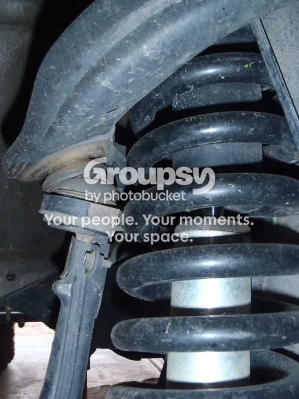

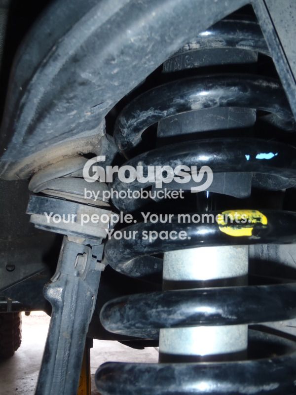

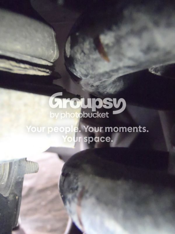

After the 861's were in I started working on a long standing issue: the coil/spindle interference I've been fighting with. I bought a Limit Strap setup, but (still) being without a welder, I have not been able to install them.
I decided to try another solution to get me by in the meantime, and that was to rotate the coils 180 degrees. Others who are running the Tundra coils up front have reported no contact between the spindle and the coil. Rickashay comes to mind, so I checked out his OME/Tundra-LC review, and sure enough, his coils were installed exactly 180 degrees from how mine were.
I started with this (bottom terminal end of the coil oriented toward the frame):
12eed852.jpg~original
And after rotating the coil 180 degrees, I ended up with this:
233b2509.jpg~original

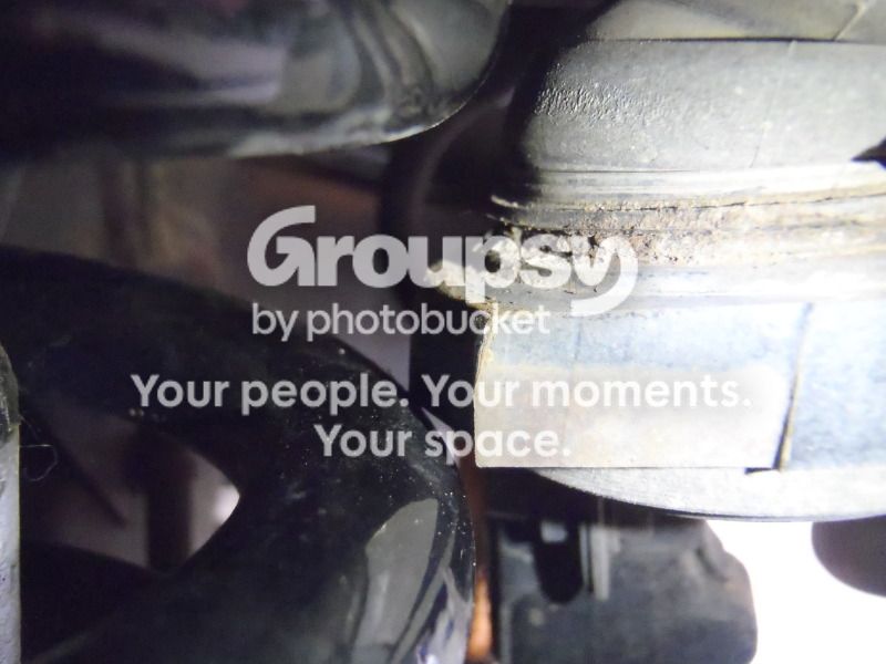

A close up of the clearance I gained:
3f8008b4.jpg~original
The driver's side came out a little differently, even though I rotated the coil exactly the same way as the passenger side. It is still a huge improvement though, because only one corner of the spindle hits and only at MAX droop (shock @ maximum extension).
3274bcdf.jpg~original
I was excited to see if the problem was solved, so I buttoned it up and took it on a short drive around the neighborhood. There are big speed bumps in my neighborhood that always produced the "CLUNK" at speeds above 20 mph. I rallied over the same speed bumps at up to 30 mph and what do you know.... NO MORE CLUNK!!!! :)
I still plan to install the limit straps, but in the meantime, I don't have to put up w/that annoying noise, or worry about the interference stressing my UBJ's. The limit straps should be helpful in extending the lives of the CV's though, because I actually gained about 2" of droop @ the tire by removing the spindle/coil interference from the equation.

[MENTION=44220]BigFishAllDay[/MENTION] When you were having coil/spindle interference, do you remember how much droop you'd have to have in order for it to interfere? I just installed some Tundra coils on mine and I'm hearing a clunk on the passenger's side, but it's over smaller potholes and small ruts in the road.

BigFishAllDay, when you were having coil/spindle interference, do you remember how much droop you'd have to have in order for it to interfere? I just installed some Tundra coils on mine and I'm hearing a clunk on the passenger's side, but it's over smaller potholes and small ruts in the road.
I have no idea what the droop measurements were at that time. I can tell you it would only happen near the end of the downward front suspension travel.
