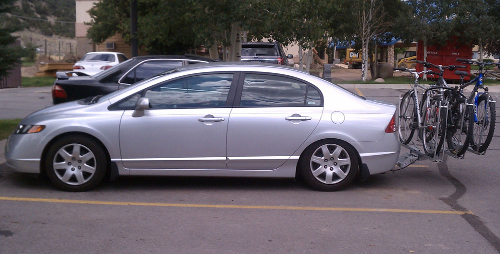

Re: Civics, rpm isn't a concern nor is the power, it's the suspension. At least to me. Even with two middle sized polynesians in the back, my car would sag something fierce. I know Civics aren't meant to tow in the first place, but the 1,000 lb towing capacity even them to me is just stupid.
Yep. Here's mine fully loaded. The bike rack and bikes are about 150lbs total. The trunk and all the seats (except driver seat) are full of stuff, who knows how many pounds, but probably not more than the weight of 2-3 people. I had most of my belongings for a temporary move across the country. With this load the rear would bottom out/hit bump stops on anything but the smallest bumps in the road, the headlights aimed too high, and the front end hydroplaned on me a couple times (worn tires didn't help). What you can't see is the excessive camber angle on the rear. Independent rear suspension is nice until you need to carry some weight. I've seen some Honda Odysseys towing, and they look like this too!
