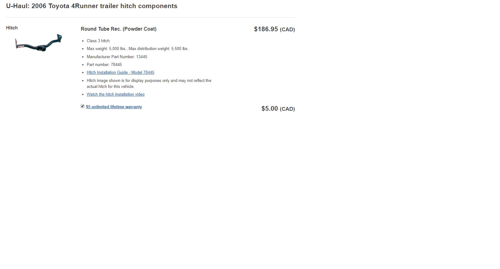

It looks like I'm towing my travel trailer wrong then...I have a 06' V6 4x4 with a WDH Equalizer 6000lb setup and a 3800lb dry weight trailer. I guess the WDH hitch setup on the V8's helps distribute the load better to the front of the vehicle thru the frame.
I don't have an issue driving with the sway control but I don't want hurt anything. How dangerous is it to drive like this?
Anyone have a used V8 receiver setup in the Toronto area?
Yes the V8 hitch actually attaches to the main frame rails, the V6 hitch only attaches to the rear center cross member which isn't all that heavy duty.
You don't actually need to get the Toyota OEM V8 hitch, any good brand class 3 hitch will give you the same results as long as it attaches to the main frame rails, which most all of them do.
Not sure what to tell you on using a WDH with the V6 hitch, it could be fine or maybe not.

Thanks for the input Skip! I am actively looking for a V8 hitch now, and have priced out a uHaul one as well.
Looks like this one will work, however it doesn't attach to the rear crossmember like the OEM V8 hitch does.
That U-Haul hitch is only rated for 5500lbs Max even with a WDH it seems, I wouldn't get that one, check a for a Draw Tite Class 3 Hitch, I think they're rated for 6000lbs and up to 7300lbs with a WDH.
I doubt you'll find a after market hitch that attaches to both the main frame and the cross member.
