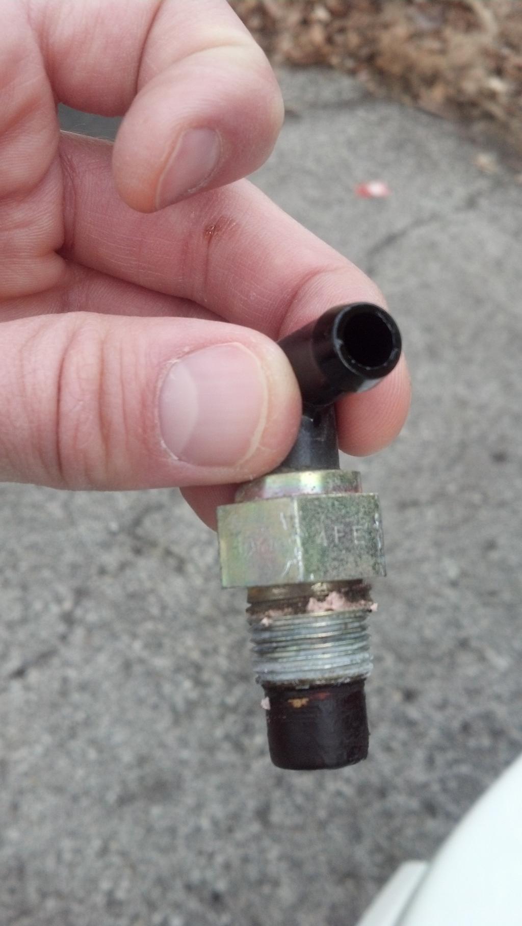

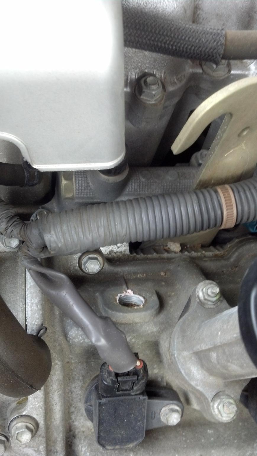

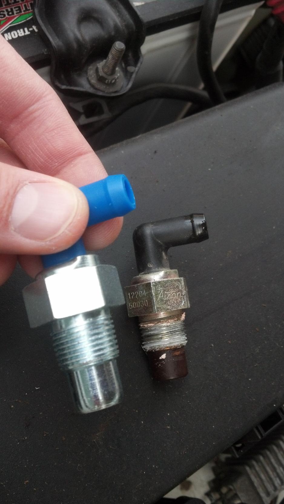

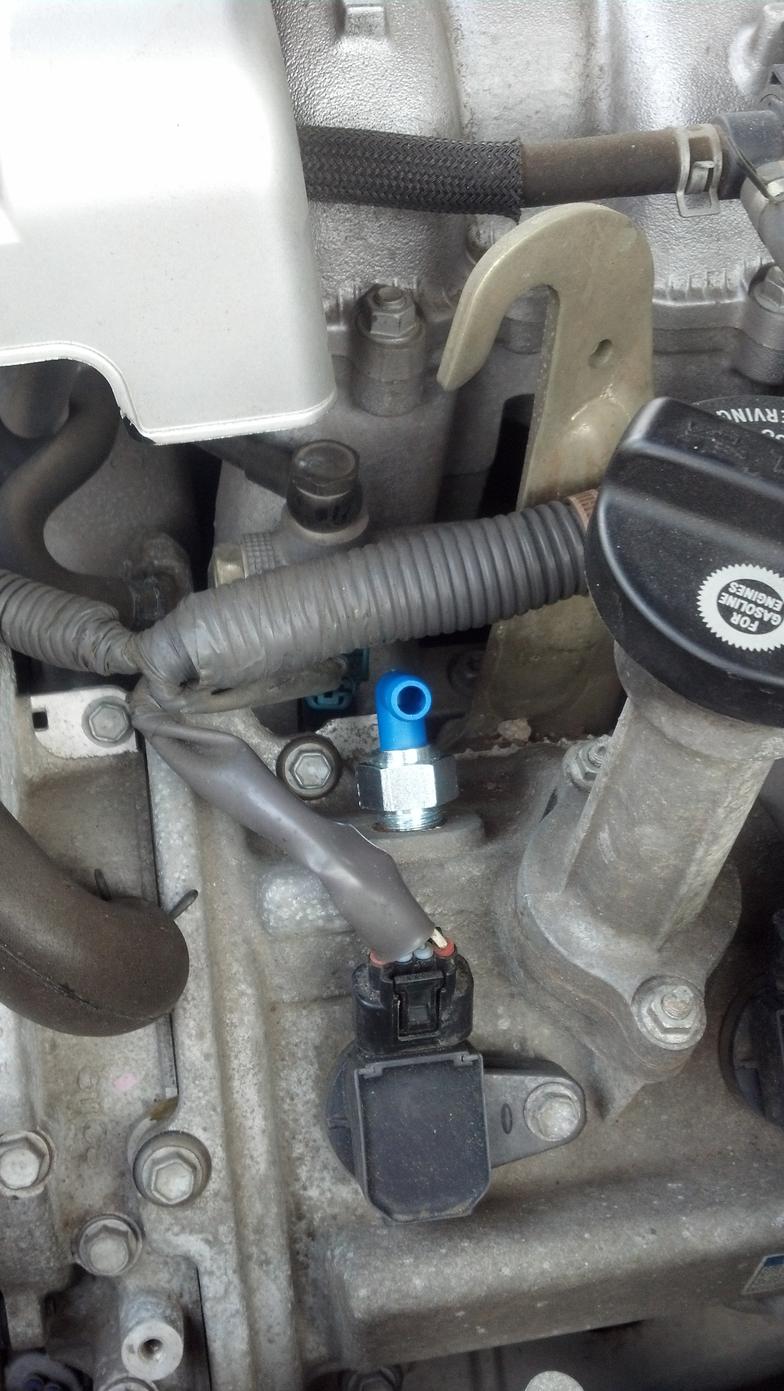

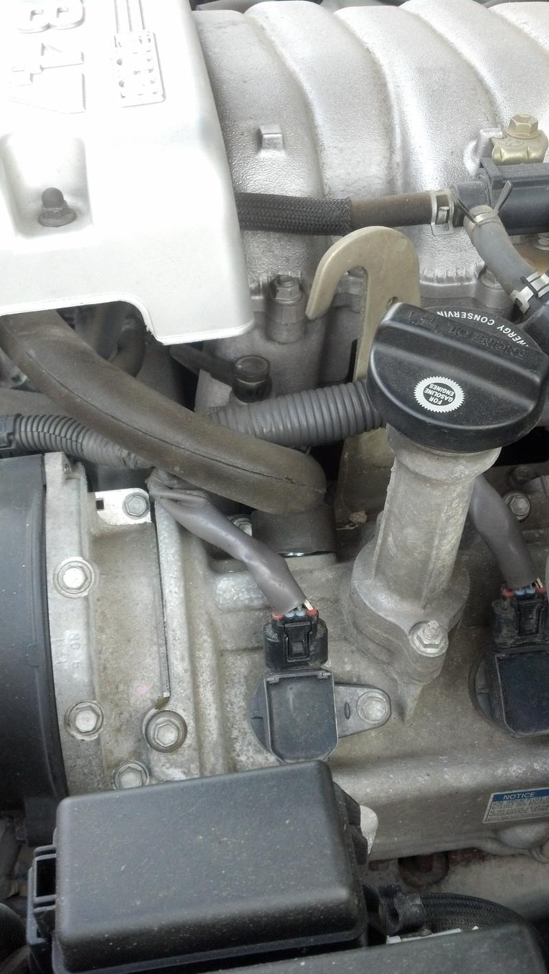

The title is pretty self explanatory, replacing the Positive Crankcase Ventilation valve on my 2004 V8 4Runner. This took maybe 5 minutes with the part and tools ready. This was the original valve too...yuck. I got the valve on Amazon for under ten bucks.
All you do is pull off the rubber hose and a small rubber shroud around the valve, set it aside. Use a wrench or pliers to loosen the old valve. Wipe off any residue around the hole, trying not to let any crud fall in. Next, screw in the new valve. I believe the torque specs are 20 ft/lbs torque. Replace the shroud, the hose, and bingo...that's it.
I did thread the new valve more than it looks. The only tool you need is a wrench or even some channel lock pliers. It was a little tough getting the old one off, but leverage helped. Anti seize may not be a bad idea for the new threads.

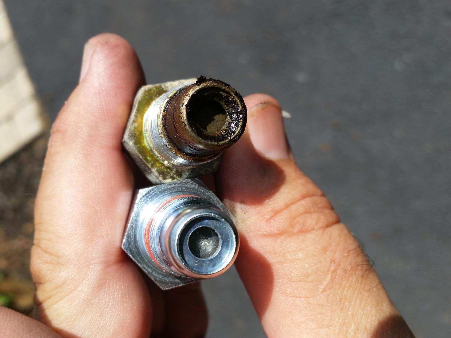

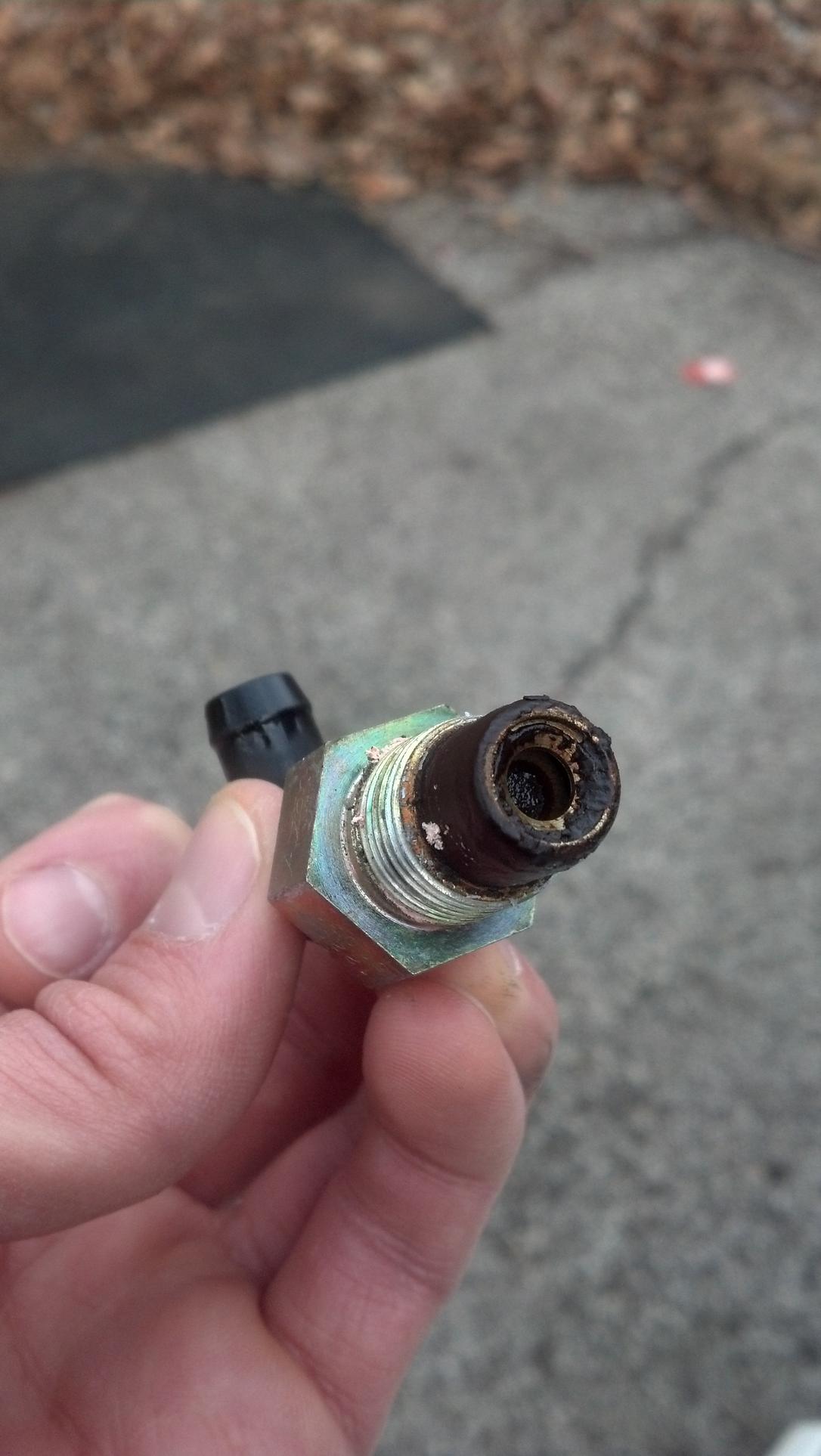

[MENTION=336]03_4x4Runner[/MENTION] Here's what the other end looked like, with about 145k miles on the clock.
No symptoms. But I was curious to see the state of the valve. I did a visual inspection and noticed some oil accumulating on the tube side of the valve. After removing I noticed this end of the valve. I thought better safe than sorry, it looked to be in a pretty crappy state.
