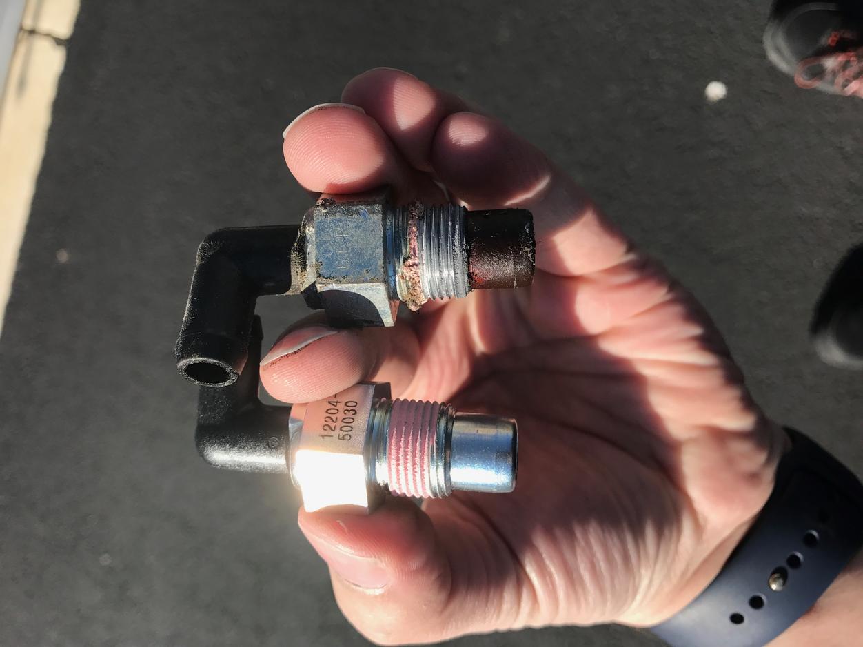

Did this yesterday just for kicks. Old one had gunk in the bottom but looked brand new otherwise. Clicked the same and check valve operated the same as the new one. Doubt I'll see any change from this but it's crossed off the list.

The title is pretty self explanatory, replacing the Positive Crankcase Ventilation valve on my 2004 V8 4Runner. This took maybe 5 minutes with the part and tools ready. This was the original valve too...yuck. I got the valve on Amazon for under ten bucks.
All you do is pull off the rubber hose and a small rubber shroud around the valve, set it aside. Use a wrench or pliers to loosen the old valve. Wipe off any residue around the hole, trying not to let any crud fall in. Next, screw in the new valve. I believe the torque specs are 20 ft/lbs torque. Replace the shroud, the hose, and bingo...that's it.
I did thread the new valve more than it looks. The only tool you need is a wrench or even some channel lock pliers. It was a little tough getting the old one off, but leverage helped. Anti seize may not be a bad idea for the new threads.
I ordered the same blue replacement as you from Amazon, but had some brown substance on the threads. How far did you thread the new valve in?
I feel like I could have kept turning it, but then the hose wouldn't have lined up, I got it to a little past the original position ('straight out'). Should I not go past there, back it out a bit? It was very hard to screw in as well...

Yeah, mine was difficult the whole time too. Both removing the old one and putting in the new one in. The new one that I put in had thread locker on it, I assume that is why it was so tight. I put mine back the way the old one was facing.
