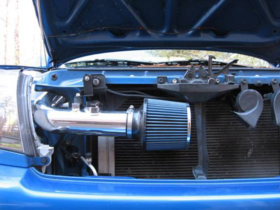

Thanks for that Ethan, I haven't noticed any difference around town in 90+ temps. I think I'll end up modifying the stock setup by routing a new intake towards the front of the truck at some point.
