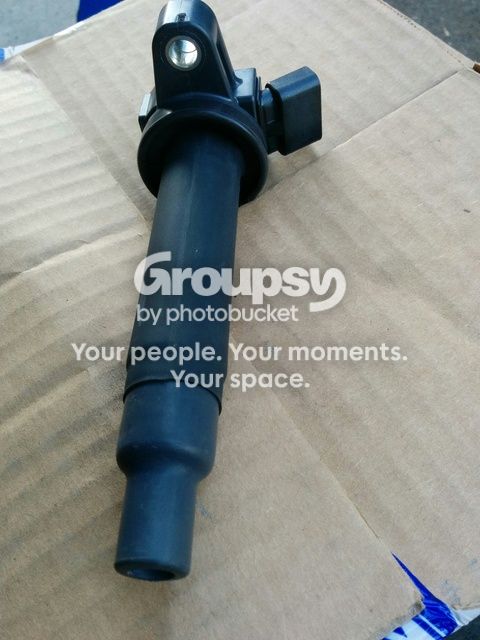

It is a very common problem found in Direct Ignition Coil to crack. This is not a permanent fix, but it should help your coil last a bit longer.

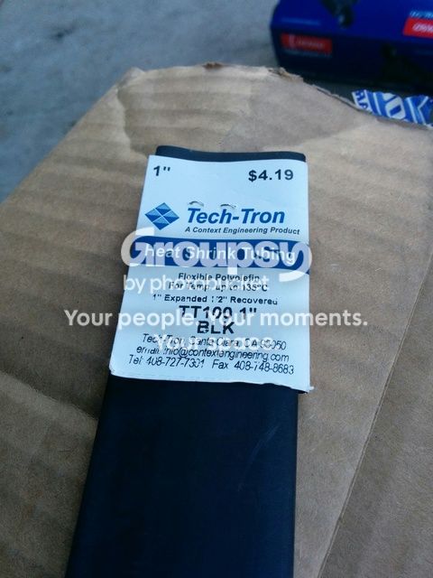

Heat shrink 1"
New coil pack
You can buy Denso Coil pack cheaper than buying Toyota OEM one, you will approx save 20-50 on each one.

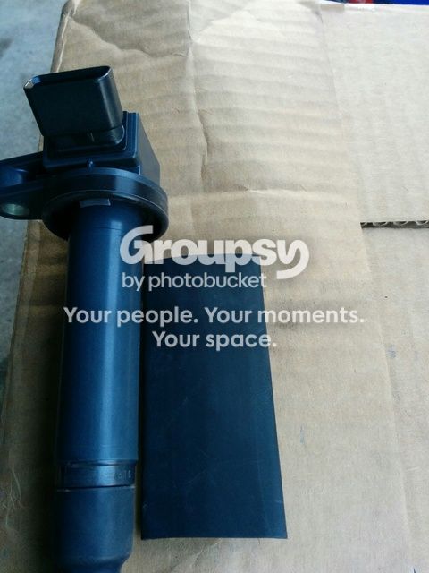

Heat shrink you need
After removing your old coil pack, measure the heat shrink and cut it to size.
After you cut it to size fit it onto the new coil and use the heat gun to shrink it.
