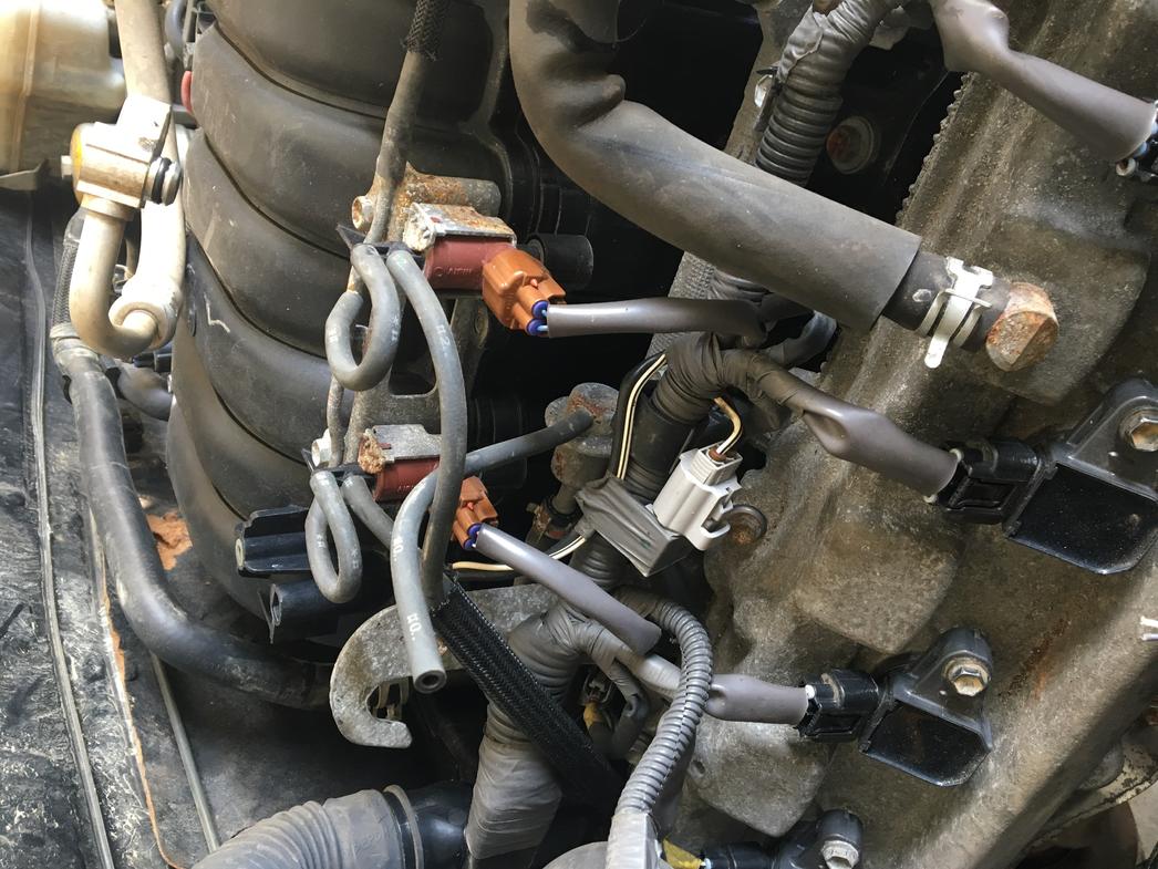

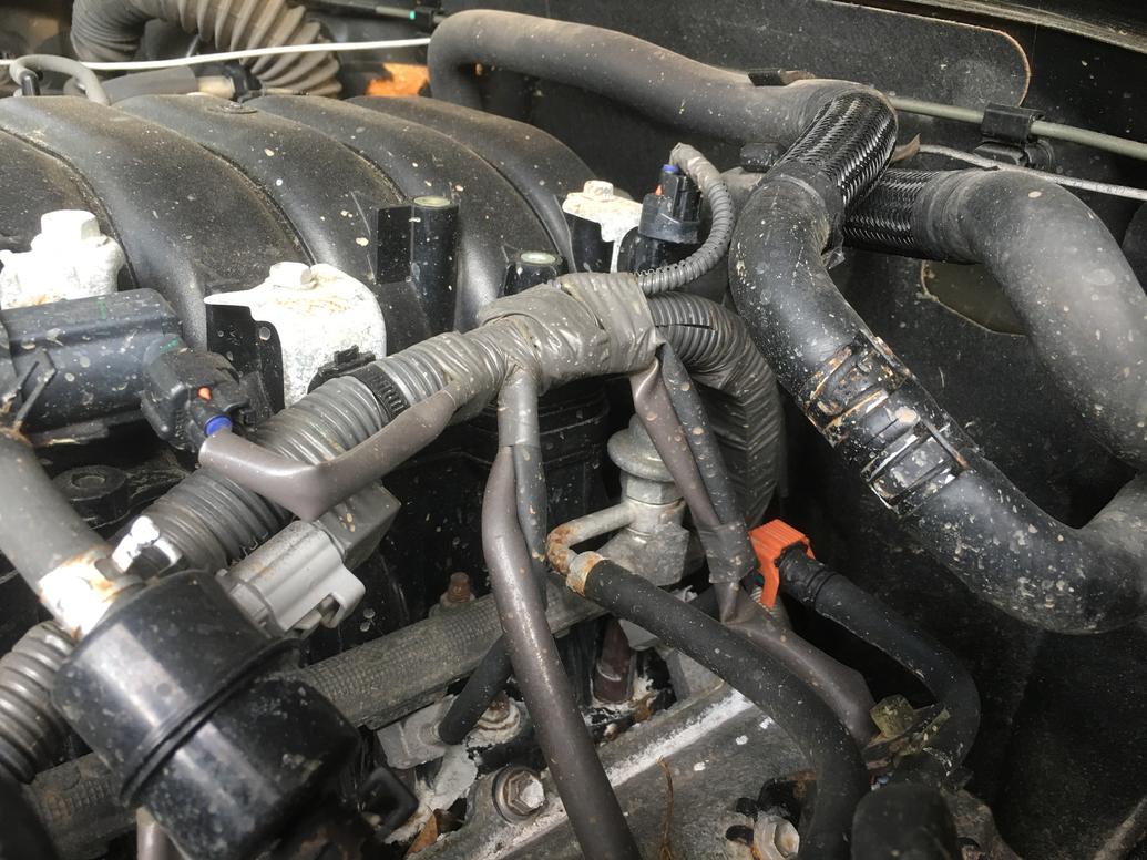

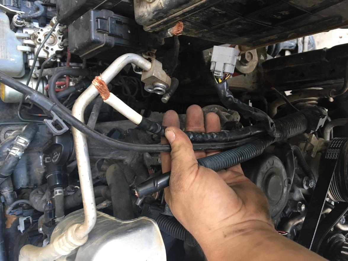

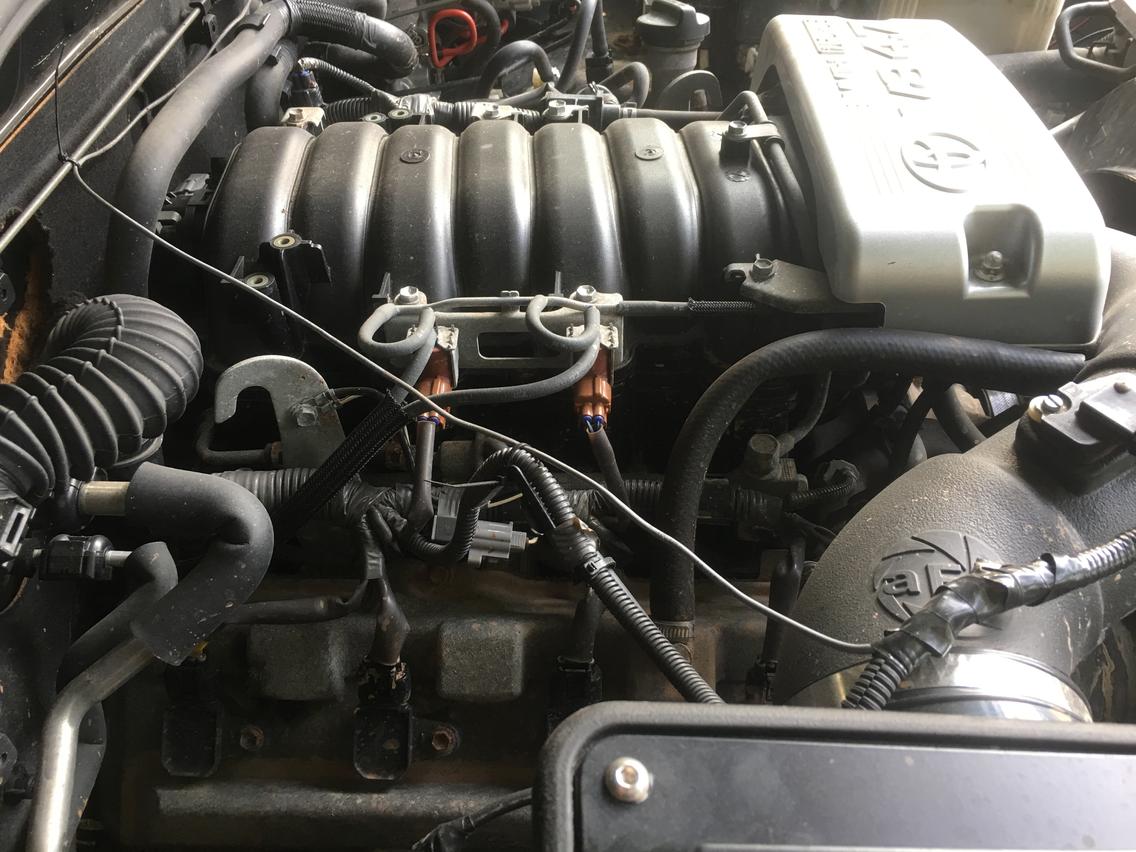

I’m in the final steps of getting my engine swapped. Was hoping someone could shoot me a photo of the white wire coming off the main harness. And where the vacuum hose coming off the passenger side fuel rail area goes to.
Photos of both
Thanks

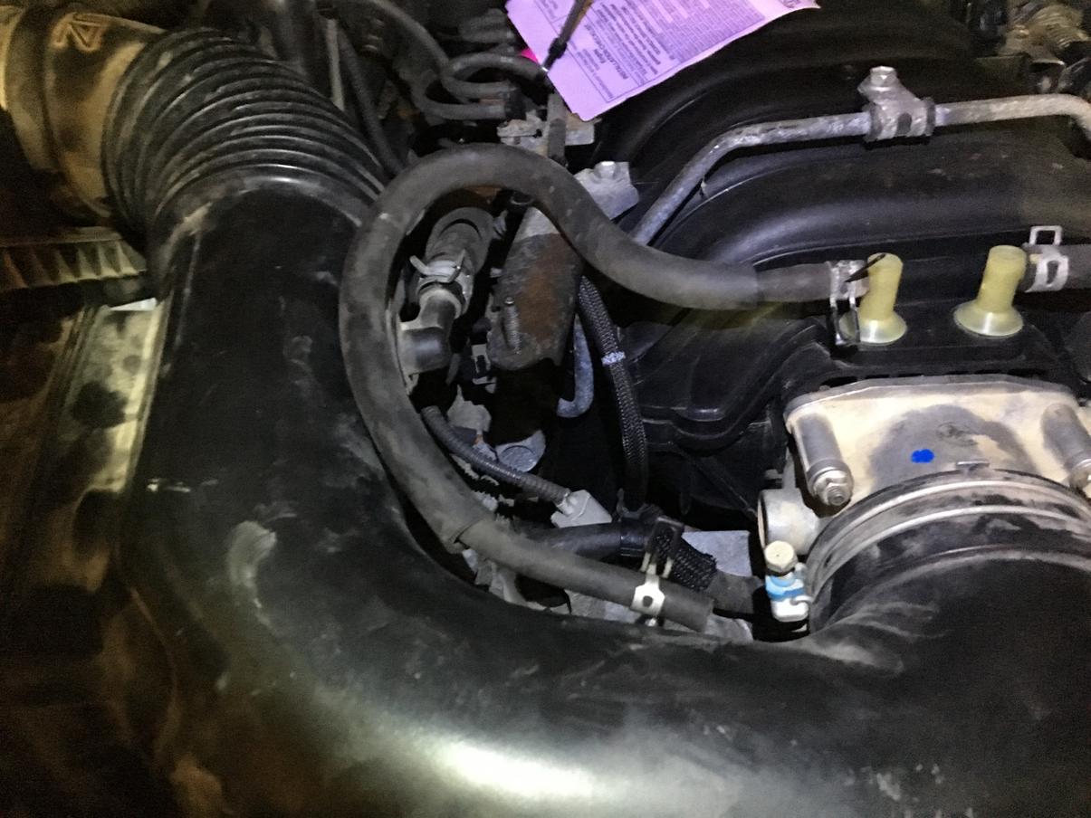

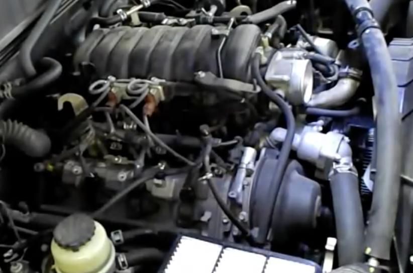

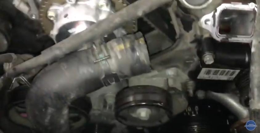

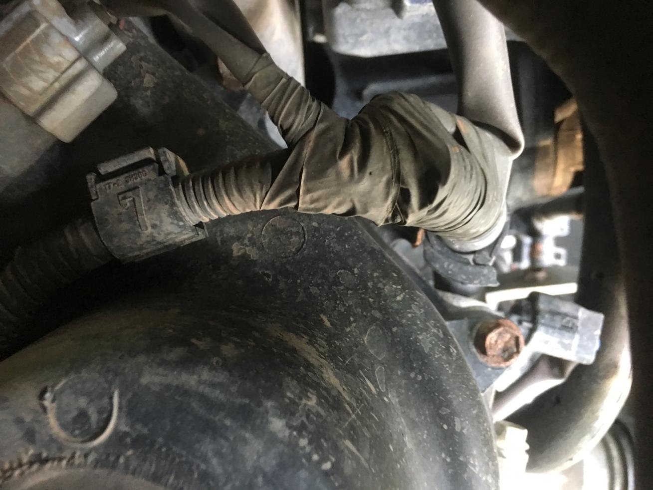

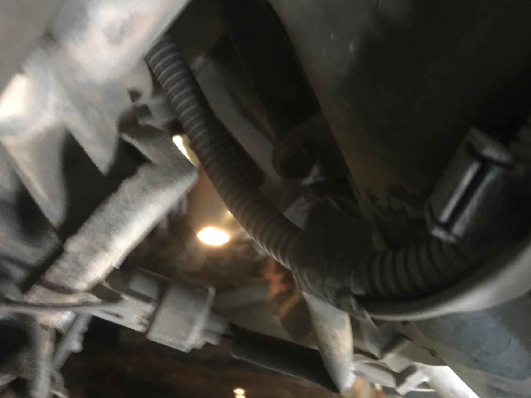

Don't know how helpful this is...
I need one more pic, There's two hoses that come out from under the "4.7" cover. One goes left and one goes right. I can't find the one that shoots to the passenger side what it's suppose to go to. Thanks.

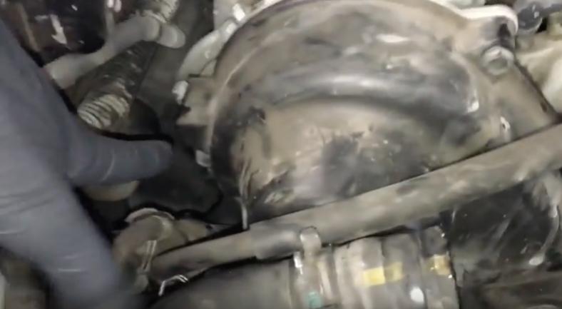

I was able to find this though, looks like it goes into a canister in the 4-5 oclock position?
Passenger side vacuum hose under the 4.7 cover goes down to a canister above your power steering pump, then the other line coming out of the canister goes back up to the intake tube.
Thank you! The new motor came with this hose, and the old hose was still on the canister. Was really throwing me off.
