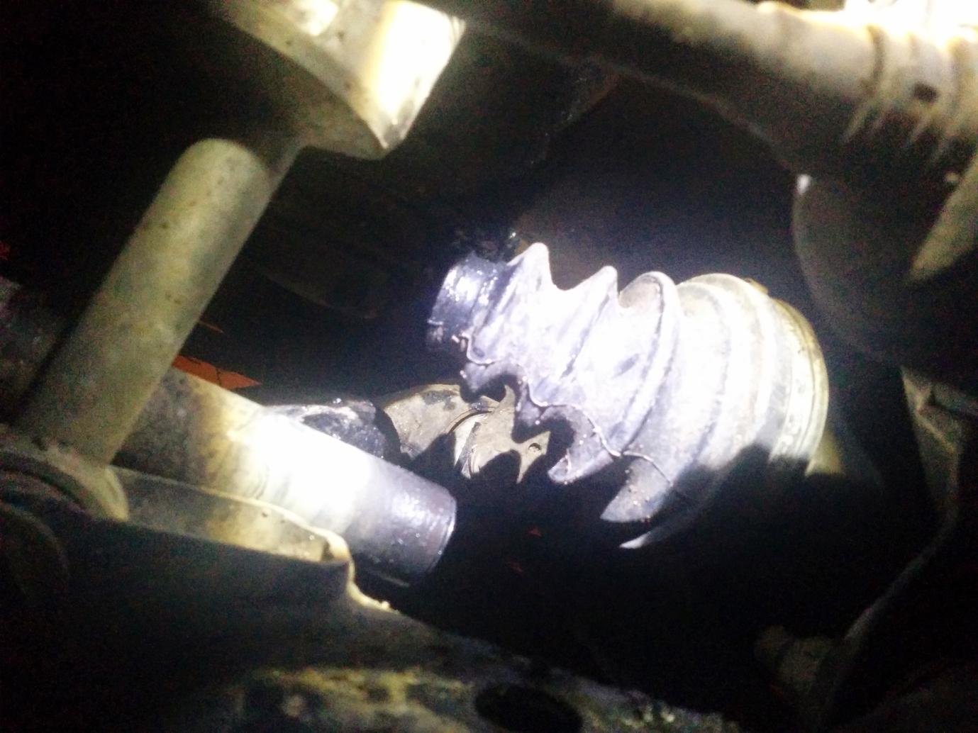

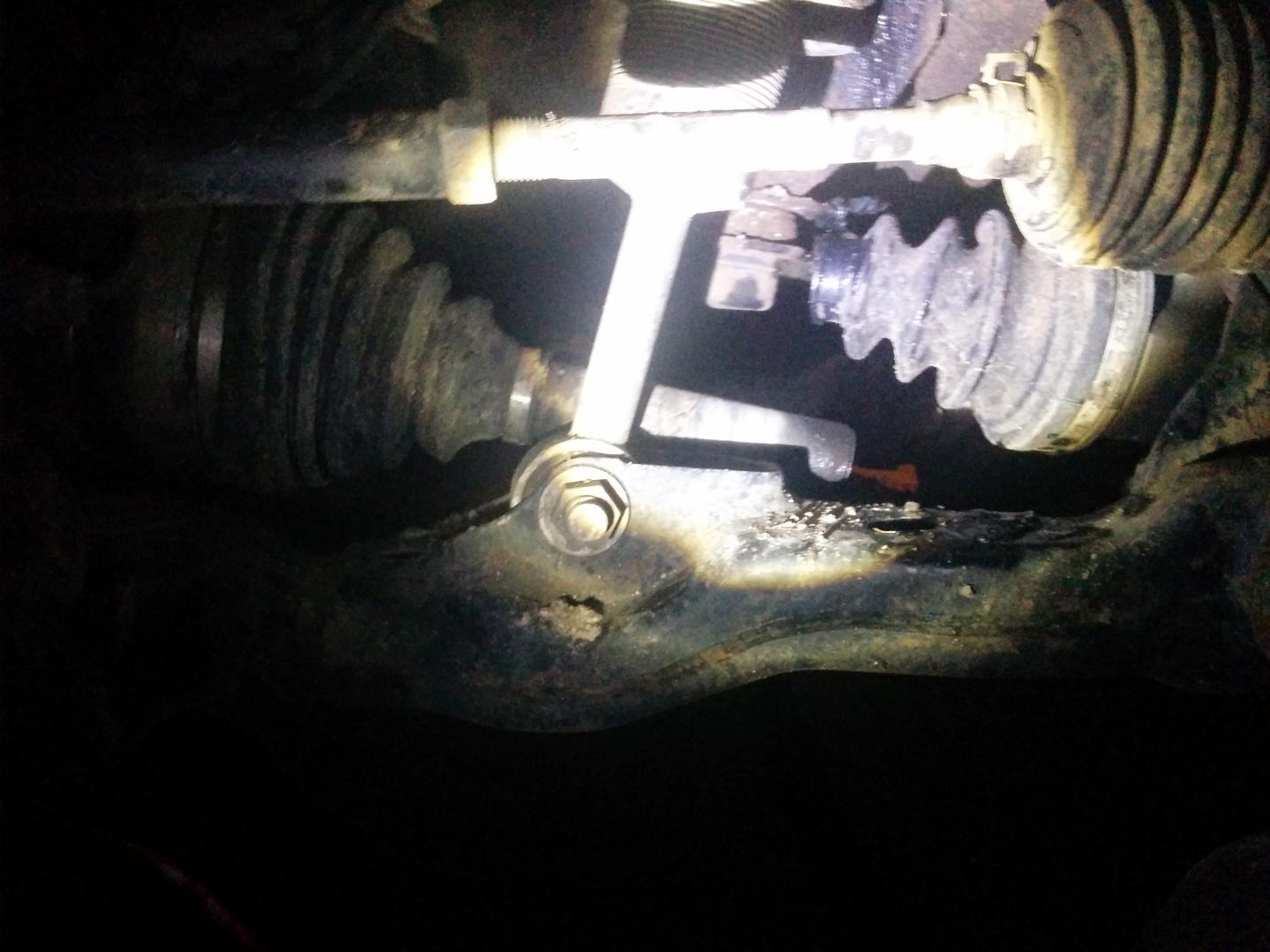

kinda like this, i sheered the splines clean off. dont ask me how i did it but it did piss me off enough to start carrying a spare.

oh damn thats rough! ive never done that in 9 years of wheeling my FJ and my GX, but I would definintely carry a spare after that
