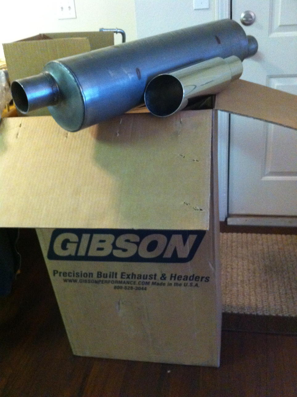

Just ordered the Gibson for my V8... can't wait! I would also like to get mine turned out to the side but it looks like there is a hanger real close to the end of the tailpipe already on the Gibson. Anyone have experience getting the Gibson turned out to the side? If so, what did the shop do? Just scrap the last hanger/add a hanger to the other side of the tip/other?

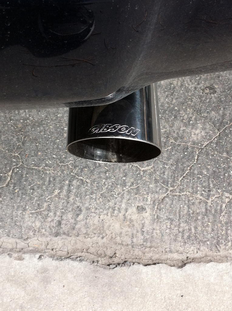

The shop routed mine out the side when they installed it. I'm pretty sure they cut it behind the last hanger and then welded on a new one with the bend. I remember speaking with one of them and they were concerned that without welding on a new hanger it would not be sturdy enough at the back. Here are some pics.

Thanks ultramontanist for the pics. So they cut up the last Gibson kit section and used the tip that came with the kit or used a universal tip? Couldn't tell for sure from all the mud! haha
Looks good though, I'm trying to decide if it is worth the hassle. I do think I prefer it to be out the side...

Yes, they cut off the last part of the Gibson and welded in a bend and then used the tip from the kit. Although, since I have put on a different Gibson tip because I thought the one that came with the exhaust was a bit big for my likes. I would definitely recommend routing out the side. It cuts down on the sulfur smell and increases departure angle, or at least you don't have to worry about smashing up your exhaust.
