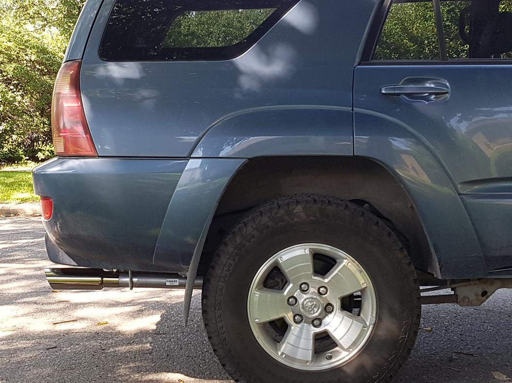

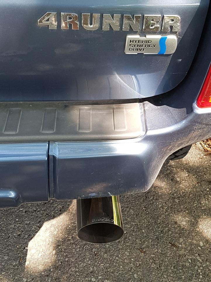

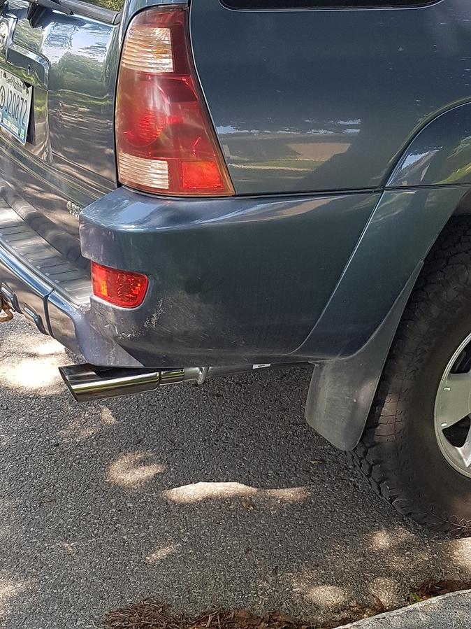

Finally on!
Huge thanks to Jason B working with me to get this to Canada with out a huge shipping charge.
First thoughts; Sounds Exactly what i was looking for, Sounds like a V8 should without rattling your teeth. Deep tone and loud when you step on it.
Butt Dyno louder means faster right? Who cares!:fro:

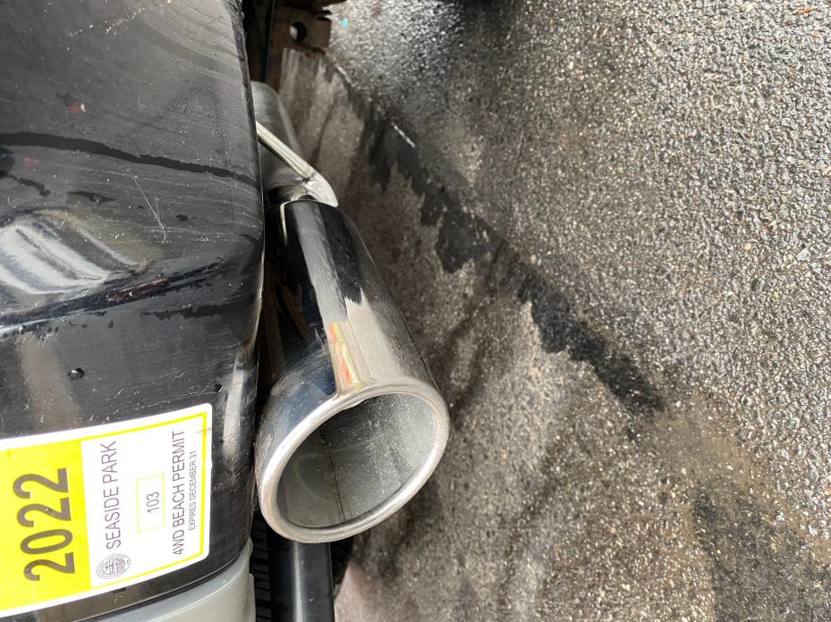

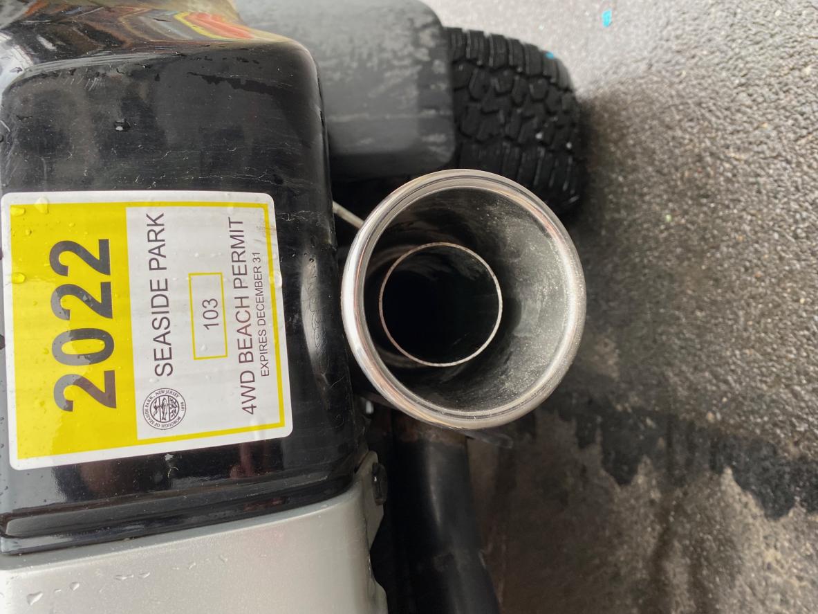

I finally got around to installing mine on a 2004 V8. The 3" tip is sitting on my bumper and nearly contacts the hitch also. Did I miss something in the install or is there a better way to tuck it out of the way? I could smell the plastic bumper cover heating up pretty good on a short initial drive—I know the obvious answer is to just remove the tip, but are there any other solutions I'm missing here?

Best way to fit it is get the tip area loose - hold the tip where you want it and adjust the hanger to match.
See that exhaust hanger by the tip - have your shop adjust that by either shortening it - or replacing it with a longer one. When deciding placement, don't forget about the hitch receiver, if equipped. You want it away from both bumper and receiver.
