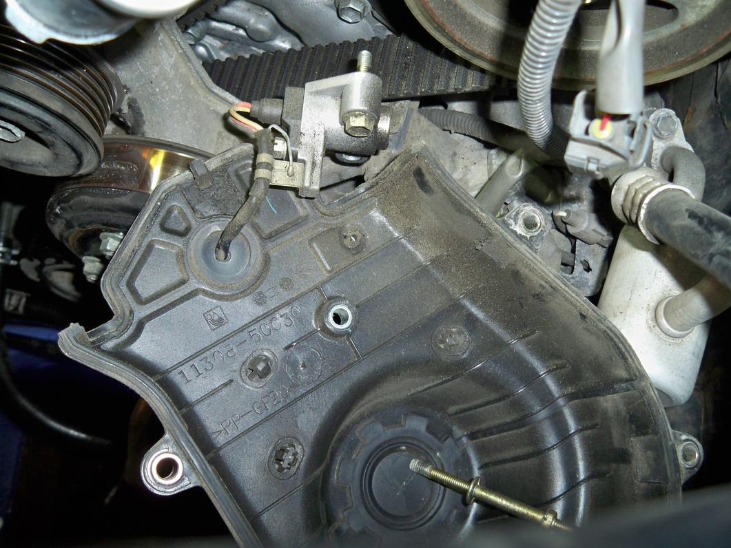

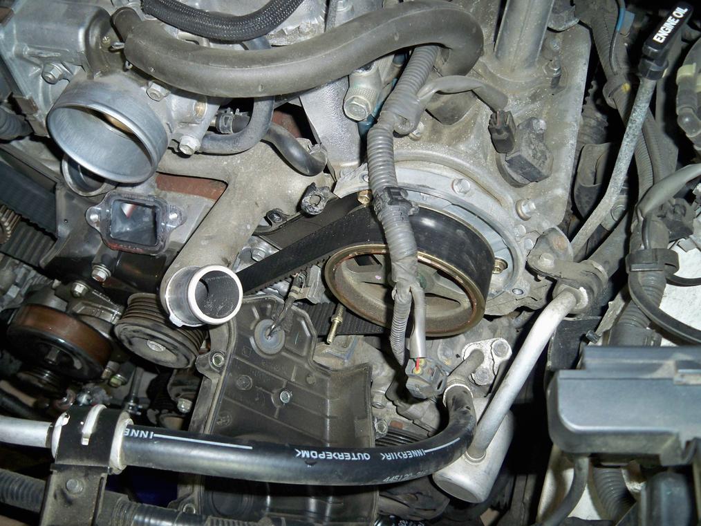

I used to carry a water bottle to pour on the crank position sensor in my Audi when I had to start it hot. Not so easy to get to this one. If you need or might need a timing belt, ask how much more to do that job, since they're half-way to it when they get to this sensor.
