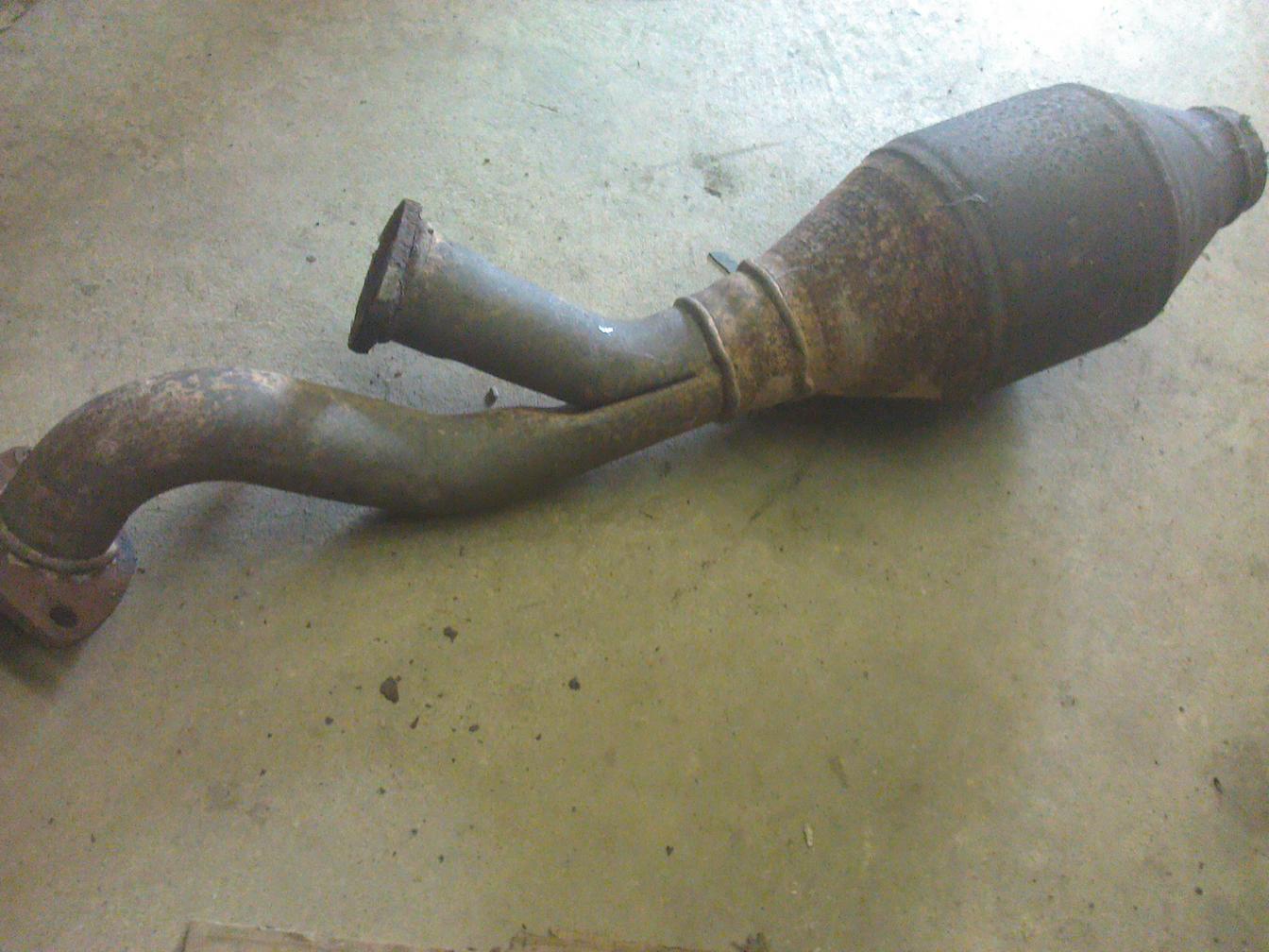

I kept the part I replaced, pretty sure where I stashed it in the garage. I'll snap a pic today or tomorrow if I don't get time (leaving shortly for the eve) that shows the horrible Y pipe we replaced. It was easier to order a prefab Y and weld my flanges on it than to make one from scratch. I think the Y was in the $35 range.

Here is the part I replaced that has the 'Toyota engineered exhaust' Y connection that makes one shake their heads.
We replaced it with a full sized Y connector and welded parts as needed to match up.
