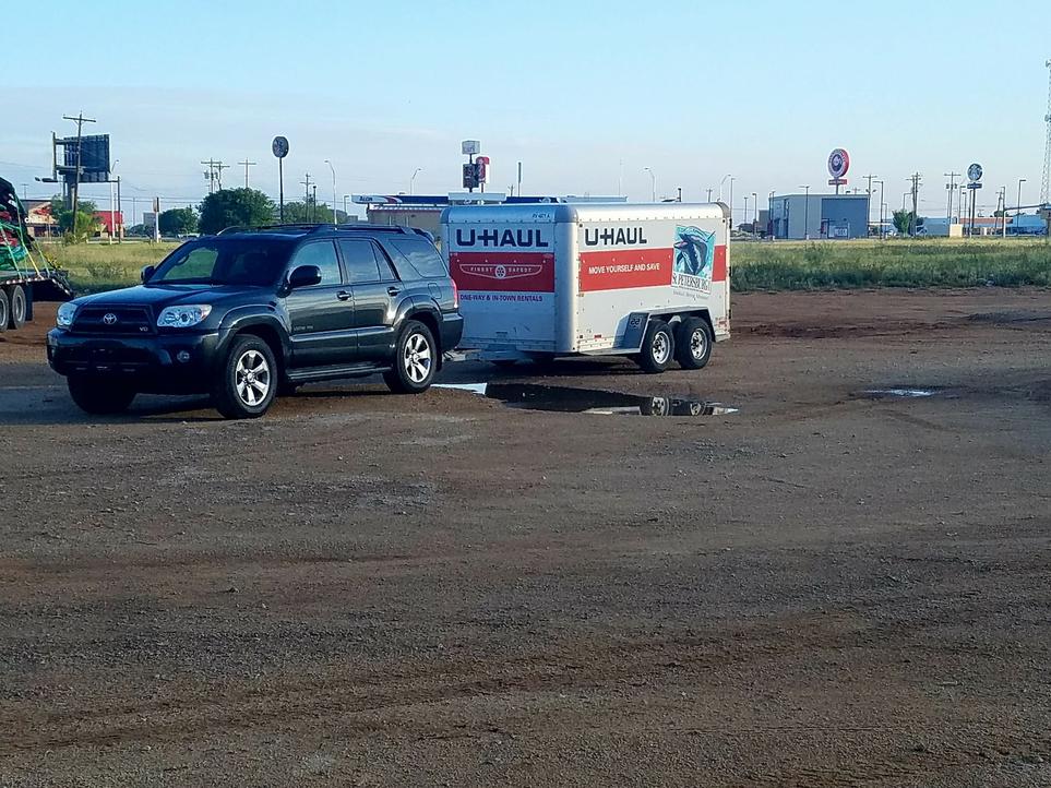

In the end of August 2017 we drove from Jacksonville, FL to Mukilteo, WA (the long way) with a 6'x12' Uhaul that was packed full to the top. The plan was to go I10 west to I5 and then north, but Harvey decided to make us detour a little. There were 0 issues towing up passes or on the highway, including sitting in rush hour traffic in 120° F Phoenix and we even went through Los Angeles (never again will I go back there lol). Some of the smaller hills made it want to switch gears too much so if you just manually choose for it in certain situations it will be fine. The biggest issue was finding somewhere to park. :laugh:
