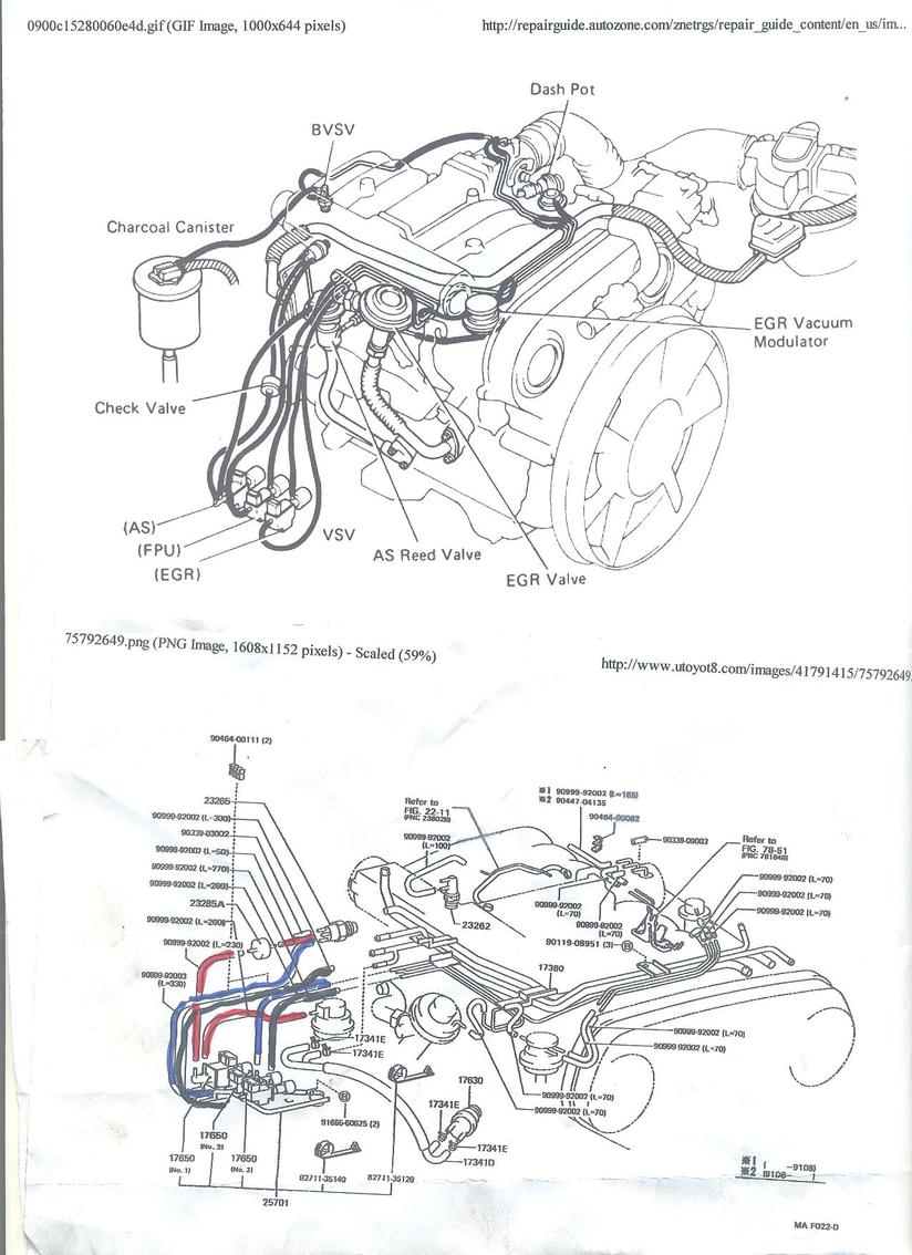

Probably the easiest way is to find someone with the same model and take some pictures of the engine bay. Or even goto a parts store and buy a manual, only about 20 bucks. Or maybe someone here can throw some pics of their engine on. We know it's a '95 what engine, trim level, etc. Good luck
Yea good luck w/ that in the manual at the parts store. Haynes doesnt really show alot. Maybe Chilton's but not sure. I have the FSM and will look at that. Is it 4wd, 4cyl, 6cyl. I had the same prob and the PO replaced the motor w/ a used and had all of the vacuum lines going everywhich way but right. Cruise didnt work nor did the 4wd but it drove fine. What exactly is wrong

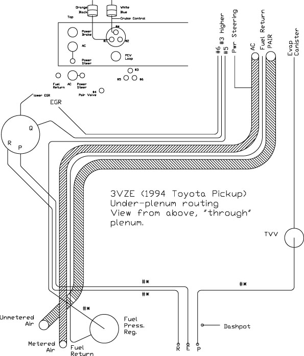

Here is another
here is a picture
Also under the hood is a good diagram
These pictures came in really handy yesterday.. I finally got the correct lines in there homes.. it was actually just the fuel line was hooked up to the vacumm line which caused fuel to dump into the intake.. super flooded it.. but thanks again for the pics they were really helpful.. @Marine Hope they helped you also.. good luck
