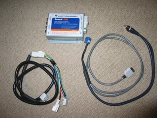

Pictures
Here is what came in the box.

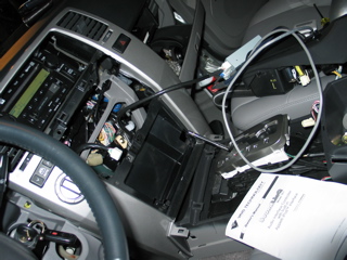

My install:
http://www.solaraguy.org/viewtopic.php?t=20887&postdays=0&postorder=asc&start=15
