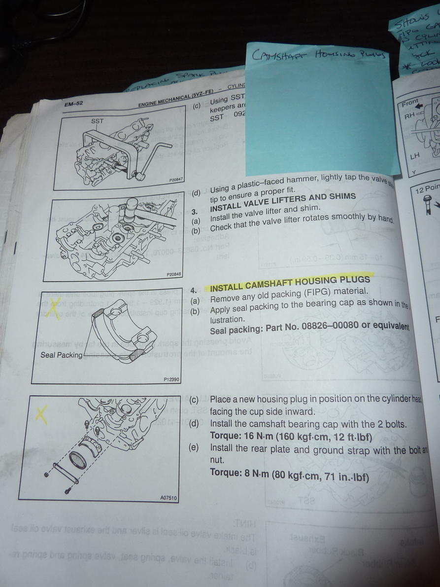

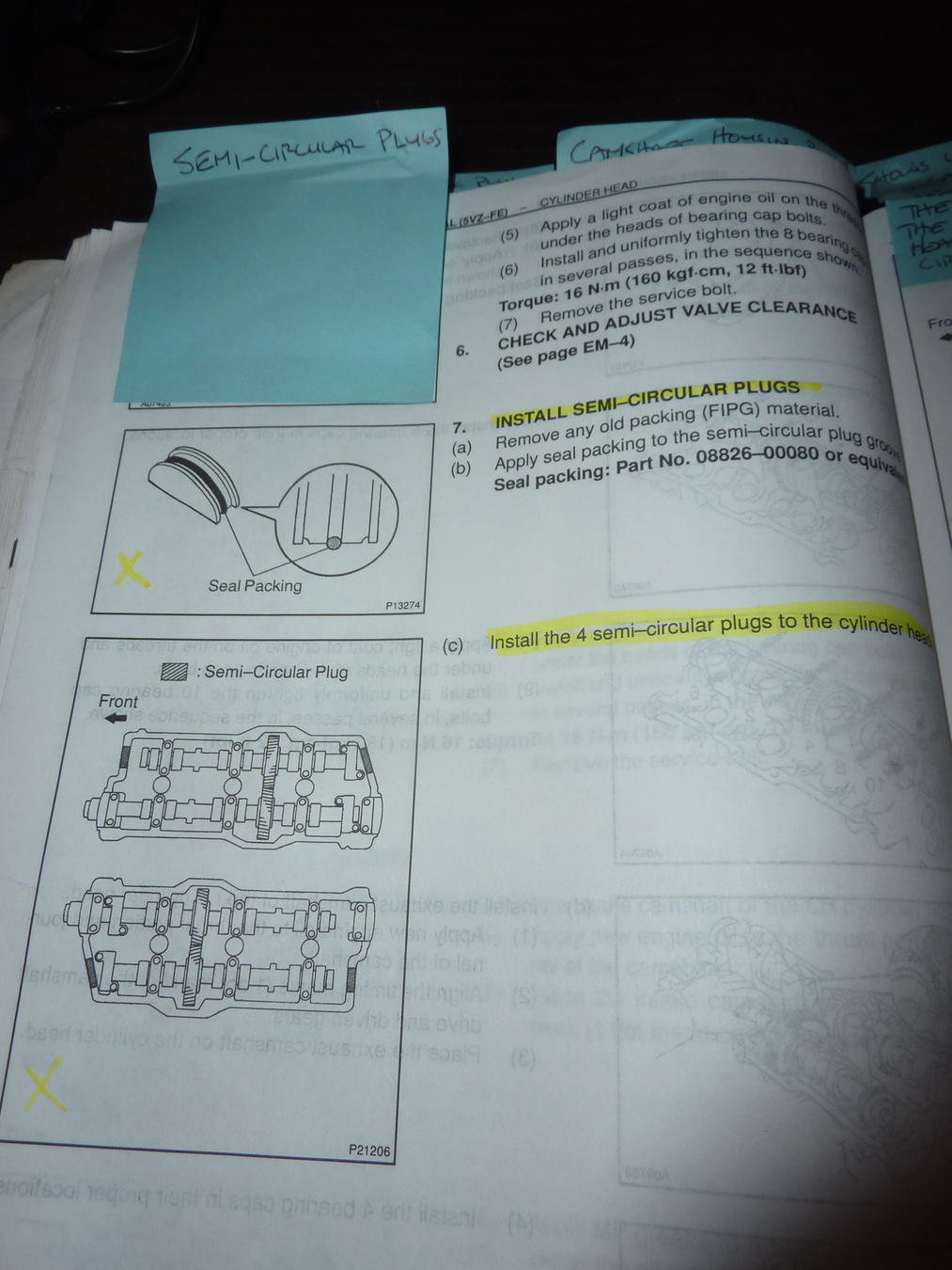

What exactly are the half moons and cam plugs on the rear of the head? I'm looking at the valve cover gasket set seen here: 95 04 Toyota 4Runner Tacoma T100 Tundra 3 4L 5VZFE DOHC Valve Cover Gasket Set | eBay
Are the half moons and cam plugs included in this set? If not how do I find them?

After removing the bolts for the bearing caps that hold the cam plugs, I was able to pull them off without much force using the same pair of taped channel locks. There's a plate on the back of the heads that I guess is there to help keep the cam plug in but I didn't have to remove that plate in order to get the plug out. It just came out when I pulled up on the cam bearing cap. I removed the old plugs by hand, put the new ones in and used RTV on the bearing caps where the FSM showed to apply it.
I have the Factory Service Manual that helped me with this repair but you could probably get away without having one if you read through the threads on this subject which are very informative. When you're ready to put the valve covers back on, you need to put RTV in 8 places on each head. Basically at each side of the half moons and each corner of the cam if that makes sense.
If you want, send me a message with your cell phone number and I can take pictures of the relevant pages out of the FSM for this repair and text you the pictures.

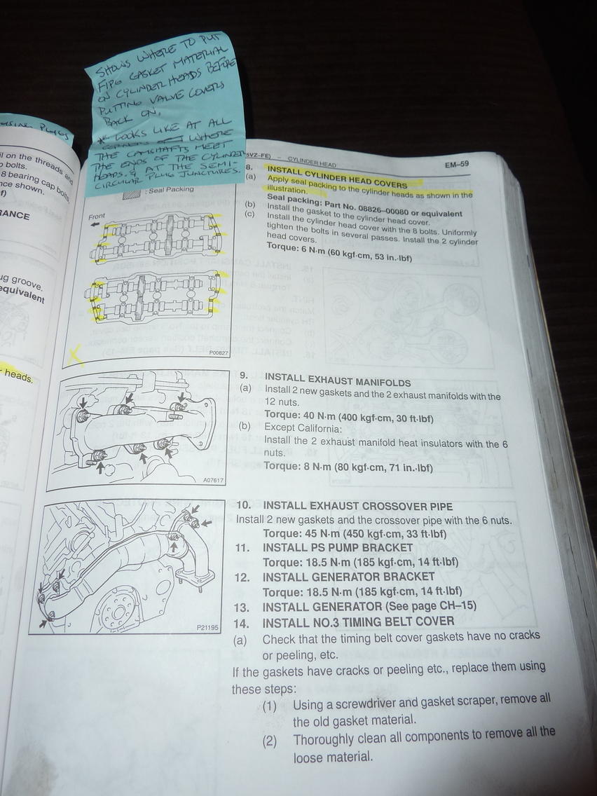

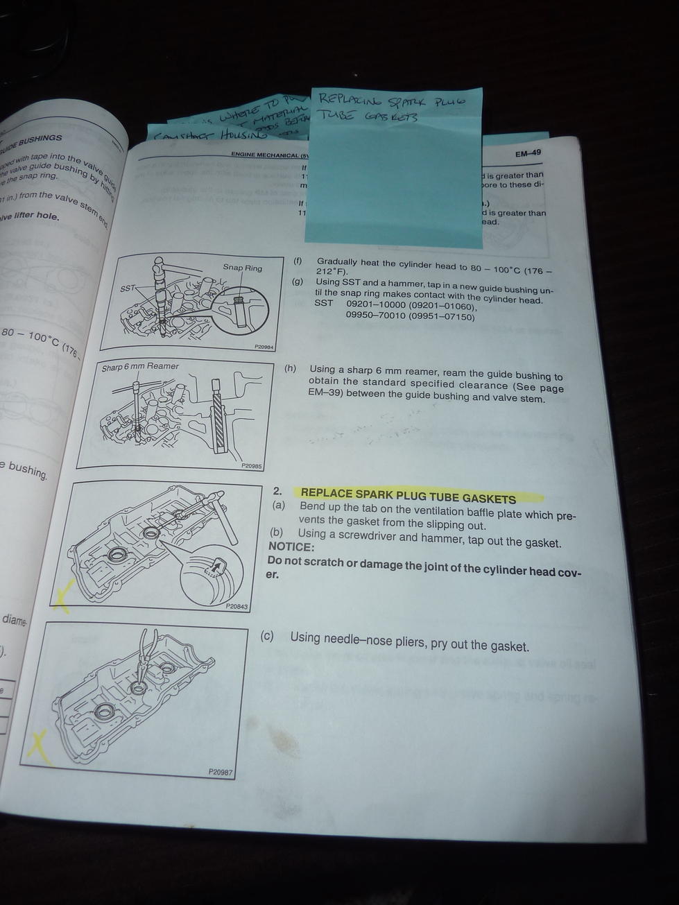

Here's some pics from the FSM to help those that would like to try doing this repair themselves:

By the way, I used Toyota factory FIPG sealant for this repair. I don't know why I kept calling it RTV. Guess I heard it somewhere and just kept repeating it. Anyway, you can find everything you need and for a good price on-line. Don't get ripped off at the dealership.

I don't think the VC could hit anything in the top end if too tight. With the proper torque, there is about a 1mm space between the VC and the head so I'm pretty sure there's more space under there than that.
Don't use ant FIPG anywhere but where the FSM prescribes.
