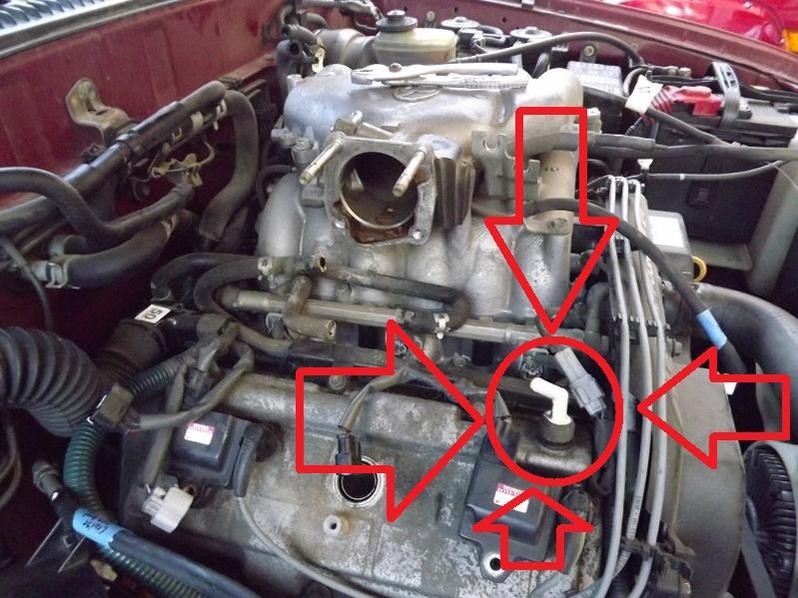

i manged to get another cover and started back at it, tightened her RIGHT this time but in the assembly i broke this....
WHAT I NEED...
the name of dis here flux cap AND how to properly install it on to the cover (i attempted to Gently rubber mallet it in but i broke it =(

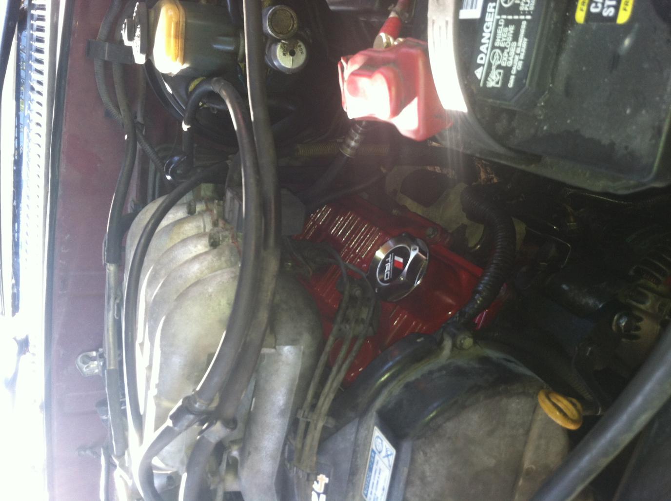

RED VALVE COVER PICS TOMORROW IF YALL CAN HELP ME OUT! Thanks guys.

gonna have to order the electrical connector from toyota.:)
just kidding, have you checked an auto parts store? they usually have a section with nothing but pcv and vacuum fittings of various styles. might find something that does the trick.
Do believe that is your Pcv. Cheap at any auto parts store. Should just slide right into the grommet.
i had herd pcv thrown a couple of times but when i looked it up it looked nothing like what i had! guess ill walk my happy ass to autoz and say I need this and slam that broken bad boy on the counter. THANKS GUYS
Naughty Red Pics tomorrow! lol
Somebody probably stuck an after-market pcv valve or one off some random car. That is definitely your pcv valve and any one that fits will work. Don't obsess about it. I use NAPA part #CRB 29352. Works fine.
Toyota valve is 12204-62010. The grommet is 90480-18001. It could be the grommet is dried out and hard and that's why you can't get it in (that's what she said) or the PCV valve there is just too big to go in right.

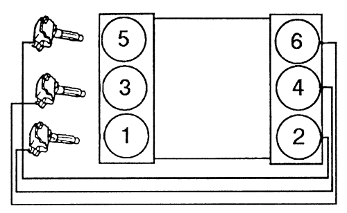

after doing the work i went to start it up and now its running like a carbed muscle car (which is not cool in this case!)
anyone have any ideas what i could have done wrong? knock timing out of place? idle is good, right at 7-800 but its just shaking not to bad, like its driveable (hell no i wont drive it though, dont want to mess anything up) i feel like its a vac leak but i checked them all and they are solid.
just cant seem to figure it out, any suggestions will be looked into.
Check that the coils and plug wires are all fully seated on the spark plugs, and that the plug wires are connected properly. Also make sure the plug wires are securely attached to the coils.
