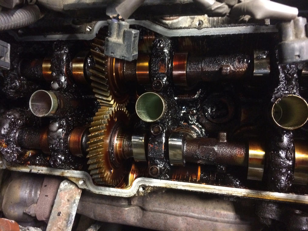

So I have had the 2002 SR5 for about a year, 82K. Always kept an eye on the oil, changed it twice, It was always clean, never black. Took it in for Valve Cover job as I do not have the resources and space to do the work. Got the dreaded "sludge" call.
I have read all the posts for the last few days about the pros and cons of the various methods of possibly cleaning it. Dealer says not to add any additives.
On the fence on what to do. Drive it as is, rebuild it, take it out back,,,,,,, sell it with disclosure
It was dealer bought, one owner, a lot of dealer maintenance done prior to sale at trade in , Tie rods, charcoal Filter, brakes etc. $2600 in dealer cost service, I was told it was serviced privately by the owner by the dealer. That should have been my walking out moment but it was not, so I am now facing the consequences of a bad decision.
Truck seems to run fine and has up to now and the oil remains clean.
Just looking for a fresh perspective as a lot of the threads I read were older.

Too bad to find that. Sorry to hear it.
I don't think it's a death sentence. With such a low mileage engine I would just get a good synthetic oil in it and do frequent oil and filter changes. I think this would gradually clean it out. I believe some synthetics are better than others in terms of detergents. I've heard Amsoil is good for cleaning.
I think you're overestimating the severity of this problem. Sludged up motors can still run like clockwork to high mileage, and frequently do.
Just sucks you don't have the space/resources to work on it yourself. I would just clean it out with shop rags, q-tips, etc, and slap the covers back on. Also do the same with the oil pan and whatever you can easily reach from below. Then start a frequent oil change regimen with a quality oil. I don't know anything about those oil additives, but seems to me they can't do any permanent harm if you don't leave them in there too long. But I wouldn't put any detergents in there to break down the sludge without first removing what you can physically get at. That's just my $.02
^This sounds like pretty good advise to me. Just clean it out the best you can and switch to a high quality oil like Amsoil. You could add seafoam to your oil (follow direction on bottle) and that will most definitely help clean this up. Make sure you only drive with the seafoam for like 50 miles (again read the directions) and then change your oil.
If your 4R was running fine before you found this I wouldn't lose any sleep over it. Yeah it looks crappy but if the engine is still running fine, just clean it up over time and call it a day...
Don't touch the sludge. Button it all back up and run synthetic oil of your choice to clean it up. I wouldn't worry about this.
The cheapest route for me if this was my ride would be to use Pennzoil conventional 5w-30 or 10w-30 along with 8 to 12 oz of Marvel Mystery Oil in the crankcase and change it every 1500 to 2000 miles. Slow and steady cleaning is what you are aiming for.
The dealer should be able to vacuum some of this out. Their liability for them lies in what is in the oil pan which they cannot see.
First owner may have never changed the oil or let it go for LONG periods of time between changes (low miles / long intervals). Agreed with the above - DO NOT DO ANYTHING other than button it back up, run a high quality synthetic with good detergents / cleaning additives such as Ca and Mg. For this task I would recommend going with rotella T6. Change it every 2- 3K for the next 12 - 15K miles and it will look black as night while cleaning things up slowly. Also, during the cleaning process, run an oversized filter. I recommend wix PN: 51516
Make sure to change your PCV valve and replace the soft-line leading to it. Likely both will be clogged up.
Last, do not take just short drives that never let the truck fully warm up. Every weekend or so, take it on a nice 20-30 mile freeway run and let it get nice and hot. Will help in the cleaning.

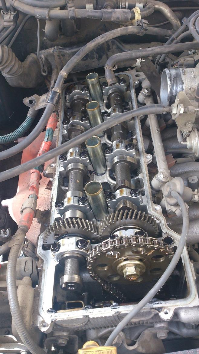

Im attacing my 240+K 3RZFE engine. (it was like this when purchased it but my 30years old corolla was in the same condition following the mentioned steps)

Thanx for all the advice , doing the above was where I was leaning towards. Going to change out the PVC , run an oil change, drop the oil pan and clean it out and hope for the best. It will get highway runs as well .
