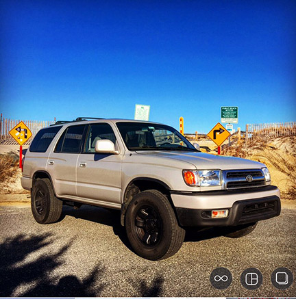

Well, as good as she was running, I was about to do the TB and some new shocks , discovered that she was rusting badly from the inside out around the rear control arm and a long crack had begun its ugly run. Looked up the shock towers and not pretty there as well. Daylight was peaking in. Decide to forgo the work, put it up for sale with full disclosure and pics and moved on. Sold it quickly and I thinks its second life as a farm truck will be its retirement plan.
Not to be discouraged by not knowing enough on what to look for on a used runner (did not about this site at that time) and a dealer that was not very upfront and not very nice, I jumped right back in and picked up a 2000 Desert Dune in much better shape at a good price, tho the private seller "forgot" to mention a few minor things. Always living and learning,,
So far so good, a few bucks in preventive repairs later and the mechanics good to go approval, back in the saddle again.
This is the new one, No plastic Dip, wheels and front were rhino lined extremely well. I really want to put some Sport wheels on this,,,,, on the hunt,
Thanx for all the input and suggestions.
